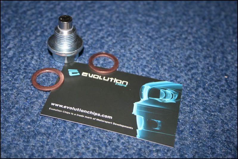

Just a little update my magnetic sump plug arrived today as the thread has stripped in sump (yet another problem with the car!!!!!) and needed tapping out to the next plug size being 16mm x 1.5mm so as I needed a new on thought I would get a strong magnetic one :)
would recommend motorsport developments to anyone, very fast delivery only ordered it yesterday afternoon

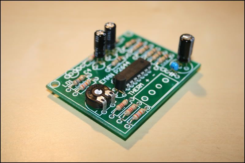

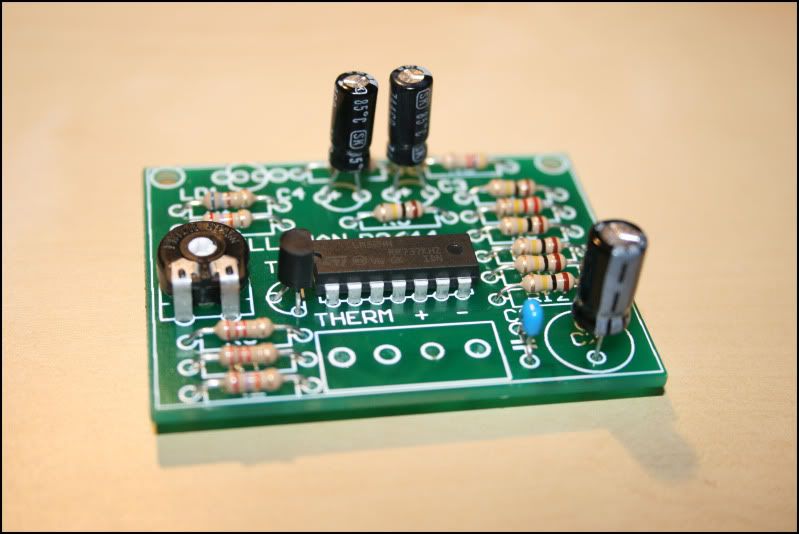

got bored this evening so made up a kit circuit board I have had since Christmas :thumbsup:
all that for a frost LED warning light, so at temperatures below 3 degrees it starts to flash and anything under zero is stays on constantly
I have tested by sticking the sensor in some ice cream and it works lol
the LED and temp sensor have been removed as they will need their own sub loom etc........

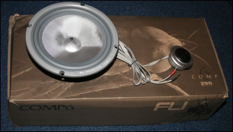

My audio stuff arrived today :thumbsup: nothing special and will be running it through the high level inputs off the standard head unit as I have the ford 6006 with built in 6 dics changer plus aftermarket head units dont look great in a ka imo ;)
FLI comp 6's RMS 85 watt, should do for me :thumbsup:

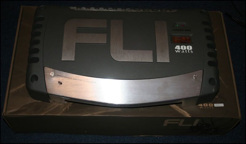

and will be driven by
with 2 x 100 watt RMS output :thumbsup:

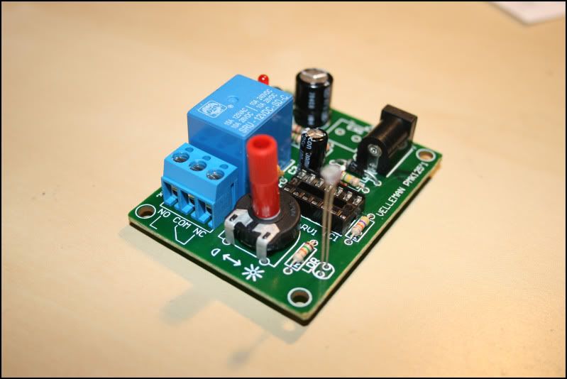

this evenings update -
managed to get another circuit kit put together tonight, this ones for automatic lights, ignore the sticky out LED and LDR they will have their own loom and place remotely to the circuit board
:thumbsup:

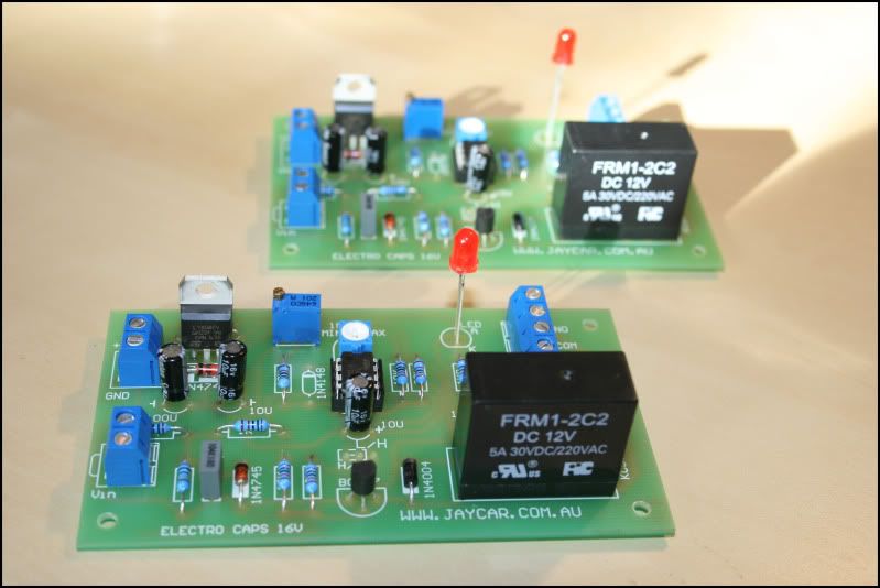

Todays update
got the two universal voltage switches put together :thumbsup:
These will both control the cooling fan, one will be for when the ignition is on and the other will control the cooling fan for 10 minutes after the ignition has been switched off if the engine bay temp sensor senses the engine bay is too hot :thumbsup:
again ignore the LED as it needs its own loom and also the blue terminal blocks will be removed and wire hard wired onto the PCB once its been tested etc...
:D

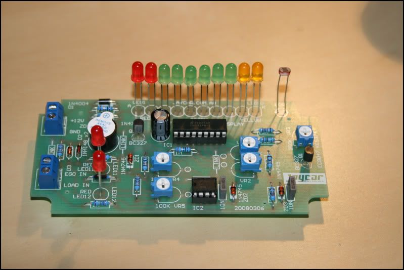

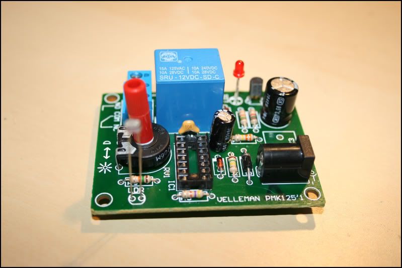

I managed to put together my last kit PCB this one is an Air/fuel ratio gauge with alarm if too lean, only designed as a guide not too accurate but still useful :thumbsup:
again ignore the LEDS, LDR and terminal blocks they will all be hard wired with their own loom etc........

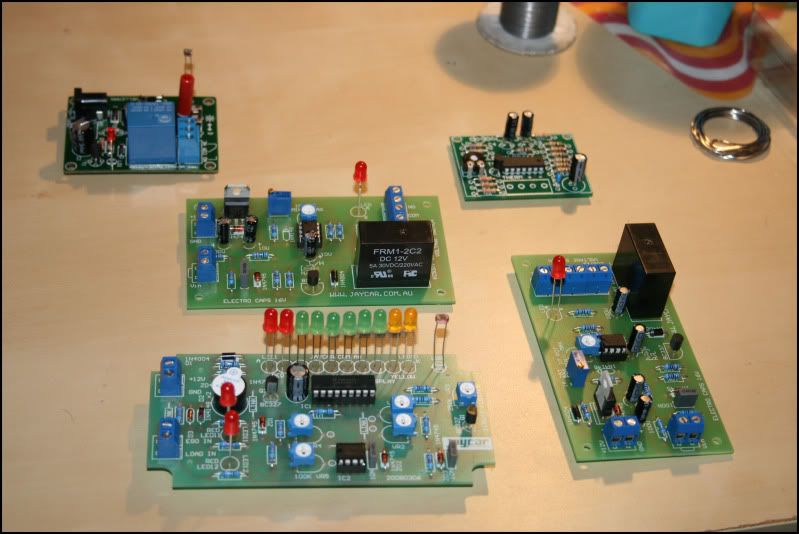

and finally all 5 together
just one more PCB is required now and thats to operate the HCV as the Ka ECU used to do this but as this has been removed a circuit needs to be designed and made to control it :thumbsup:
