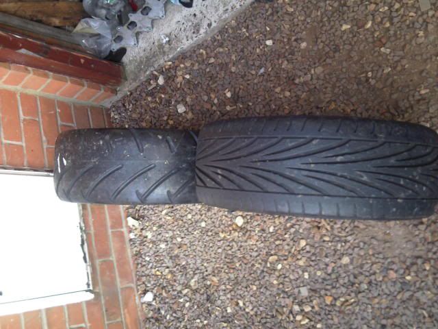

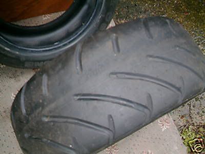

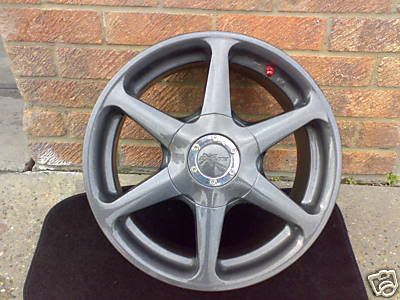

just picked up some decent 2nd hand 15" wheels which have a gold metal flake finish to fit the new track day tyres
these tyre are about as slick road legal as possible 8-) Image

PostPosted: Tue Mar 10, 2009 9:10 pm
Posts: 237
ooooo they look grippy :devil:
PostPosted: Tue Mar 10, 2009 9:59 pm
Posts: 684
Location: Surrey
Nice 8-)
Those wheels should suit it I think :)
What make are the tyres, look very boarder line to be road legal :lol: :lol:

PostPosted: Tue Mar 10, 2009 10:41 pm
ooooo! They look very grippy and those wheels should suit the car nicely! 8-)
PostPosted: Tue Mar 10, 2009 11:00 pm
Posts: 423
Location: Norwich
They look really good should make a big difference, almost a slick, should be fun in the wet!!

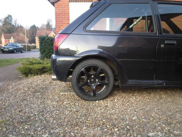

got the new track day wheels and tyres sorted
before
after
the tyres are 195/50/15 and all in weigh about 2kg more per wheel/tyre, may be more issue with rubbing on the front but look like they goin to stick like ......
Will
PostPosted: Sat Mar 28, 2009 2:41 am
Posts: 355
Location: barnsley
is it me or does both them wheels look lost in the arches :hmm:
ive got 15s on with same tyre size n mine are filled nicely? :hsugh:
RuLeThEbEnDs
PostPosted: Sat Mar 28, 2009 11:12 am
New wheels are a big improvement mate, and those tyres look sticky as f**k! 8-)
