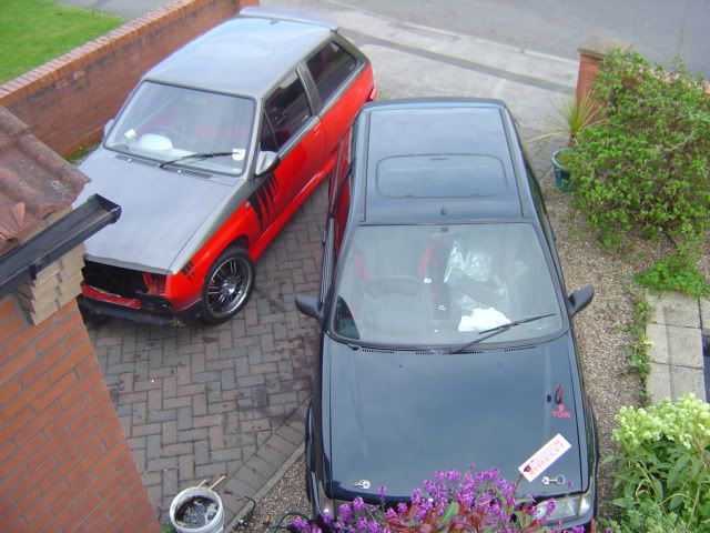

so now the fiesta is near enough done i pulled my other car out the garage to fix lol my mum must love me taking over the drive
the nova looks worse than it is really no front end on and no engine thats why its high on the front
