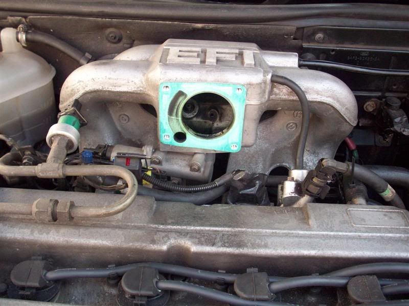

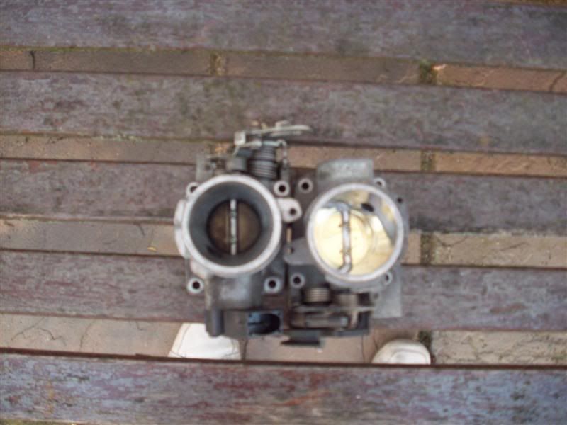

minor update today - have been to busy as of late moving houses/starting new jobs etc :rolleyes:

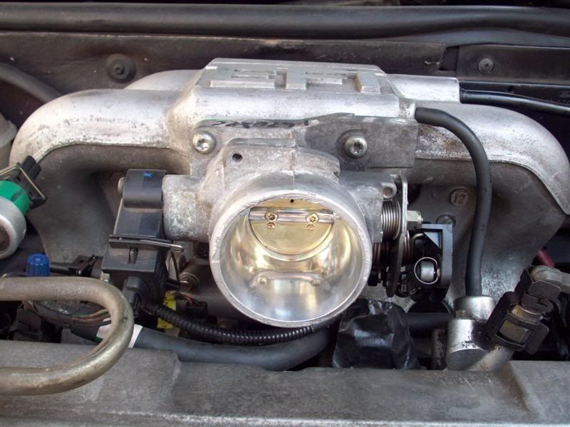

anyway, thought today i'd have a bash at fitting my £20 ported and polished TB...
Old tb off:
comparison - no, i don't really see much difference either :lolz:
new one on..
Had a few hiccups along the way but only took 1hr ish....
problems : the accelerator cable bracket does not line up correctly to the mouting holes on the new TB, therefore im guessing i need a mondeo/escort 1.6 accelerator cable bracket... which was *suprisingly* not mentioned on the ebay description. however, for now i've just bolted in one of the holes to secure the bracket enough for the time being...
second issue is abit of an annoying one. think i have some sort of minor airleak for the following reasons -
1 - when turning on car it idles at around for 2ish seconds 1400rpm and then drops to 950rpm
2 - when pressing the accelerator and letting go as the revs drop they stop at 1500rpm for about 2 seconds before returning to 950rpm...
put my ear around the TB to see if it is anything obvious, but there are no obvious noises that shouldn't be there...
going to give the car a drive around for 10mins or so to see if it clears up (probably wont) should also give me chance to give feedback on the TB - assuming i have no air leaks...
i have got 2 vids of this which i will upload later, but for the time being im trying to work out how to convert them from .mov to something smaller :teehheee:
cheers

Unplug the battery Andy and re-set the ECU, then go drive enthusatically after for a few miles! :)

i was thinking of doing this but wasn't sure how to do it..
so just literally uplug it?? how long for?
cheers

PostPosted: Sun Jun 08, 2008 7:05 pm
looking good andy :chill:
i think 1hr+ is more than enough to re-set the ecu 8-)

just took it out now, although to begin with it seemed to work, its still doing it again now. bugger :banghead:
nevermind i'll have to have a think

I bought the same one and mine didn't need any modification?
I figured the slightly higher revs was the cable catching / the guard not sitting quite right. tbh i haven't resolved it but it seems to come and go. so haven given it much thought.
PostPosted: Sun Jun 08, 2008 8:10 pm
Did you fit a new gasket? they are crap, as I had problems with mine everytime I change the TB
would like to see if it was a worth while mod or not 8-)

Could the funny idle just be a side effect of having one of these fitted?

my idles never been the same since sticking the ported/poloshed inlet and Tb on mine too. very rev happy in the low rev range. too rev happy infact.

it does look nice and shiny, every time i have my tb off i drown it in instant gasket when it goes back on, on and off 3 times!! 1 paper gasket used :lol:

might try leaving the battery unplugged for longer and giving it a good spanking again..
its revs/idles acceptabley for the first 2-5mins when turning it on....
then something will happen (maybe warm up?) then it carries on doing it....
..in terms of power, think the torque has increased definately, feels abit revvier(sp) throughout, might be due to the over-revving problem though
cheers for the comments
