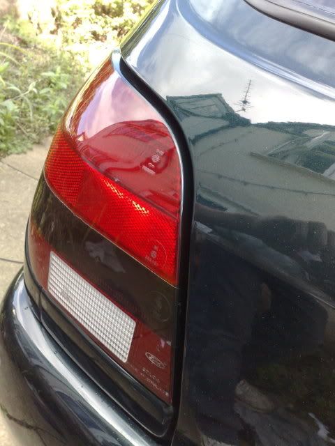

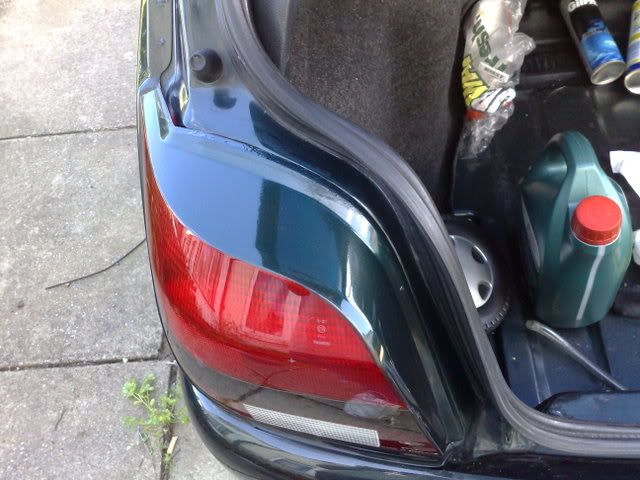

well i got bored today and thought id try something new with the rear lights, well basicly i notices that the line going right down the side of the car below the windows follows onto the lights like so....
so i thought what would it look like if i sprayed the top parts of the lights body colourd so it looks like that line blends into the light more and heres the outcome :) there not laqured as i didnt have any laqure left in the garage, just need to let them dry properly over a couple of days so that i can give them a good polish up, but i like it, very simple but nice mod for a cleaner look 8-)
comments welcome

I love your inventivness jamie! I think that looks really good, very subtle but i like it 8-)

cheers for the comments everyone, yeah the paint should be shiny even if its not laqured it will just go dull very quickly if left bare due to all the road grime lol
i do random things when im bored and have spare paint laying around :lol:
alec: yes i do like your running lights, dont think they would look right on a fiesta tho lol, alot of audi are getting them now and even afew 911's

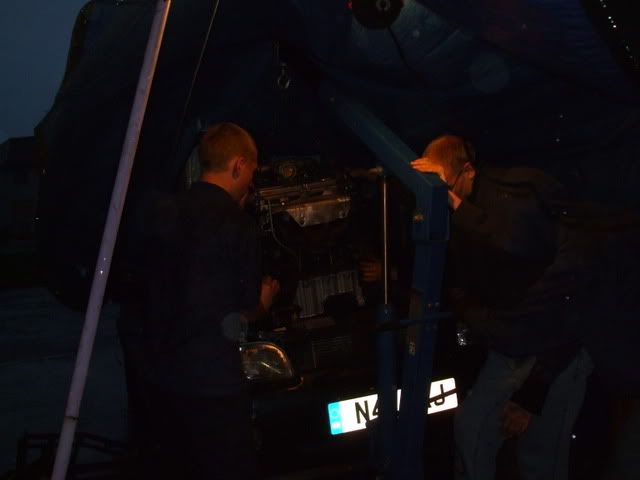

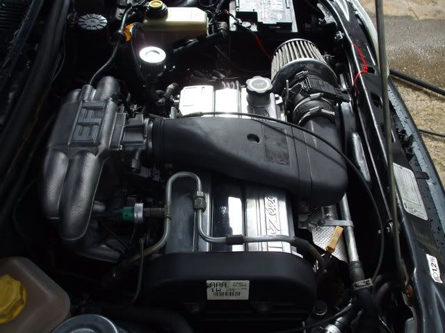

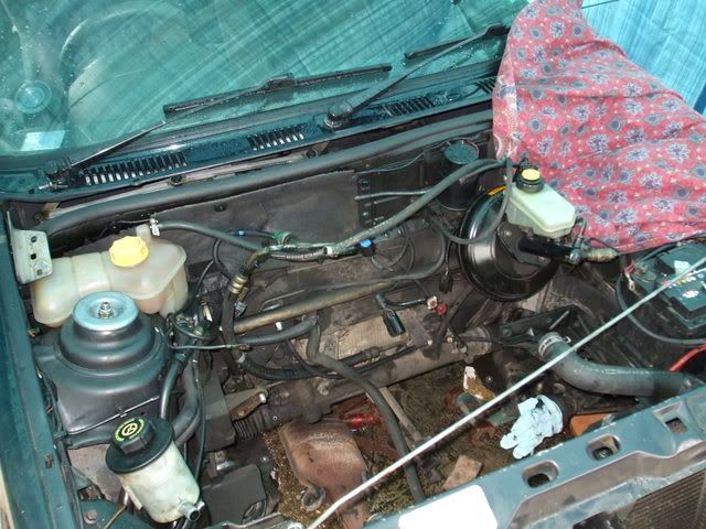

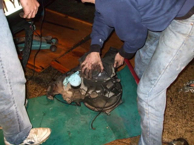

hey, been a while since i updated much on the car. finally got around to getting my 2.0 in!
after a very long weekend, started stripping the 1.6 down in the car on thursday evening and then finished stripping it on friday morning then managed to get the engine and gearbox out of the car on friday and move everything else over onto the 2.0 ready for terry, woods and barry to come over and give me a hand getting it back in the car lol, think we eventually got it all in a bolted up by 11ish as the gearbox was proveing to be a right pig to get back in! finally saturday came and terry came along to give me a hand just finishing off all the wireing etc, got it all ready, oil filled, warter filled, ps steering fluid in everything connected and went to fine it up and it wouldnt!!! we checked everything we could as there was no spark but couldnt find anything wrong so i was getting ready to get the brakedown people to come and take it to a garage for me to spend loads on them getting it started! untill sunday when i randomly had a thought in my head about the cps sensor houseing being different on the 1.6 to the 2.0. went and checked and they were, i still had the 2.0 cps houseing on the 2.0 so it wasnt reading the 1.6 flywheel :x so half the day sunday i spend takeing the gearbox back out the car to change the sensor house as the 1 bolt to remove it is behine the flywheel arggg. got it all back together and heypresto it runs, but wont idal and is very lumpy so the timeing is to be done on it!!!
big thanks to terry, barry and woods for helping me to get the engine in and to alex for lending the engine crain :)in total i think it took about 20 hours to get done not including having to take the gearbox off again to do that sensor!!
(oh year also pretty much the whole time we were doing this conversion it was pouring down with rain and really strong winds!!)
heres some pics, not many but a couple 8-)

empty bay

PostPosted: Mon Sep 08, 2008 11:37 am
Your a nutter for attempting that gearbox on your own after the trouble it caused the 4 of us :rolleyes: :lol:
Glad it's in, and "running" now.
PostPosted: Mon Sep 08, 2008 11:39 am
glad its running now jamie, i totally forgot about the cps housing :red: , should of mentioned it before
glad we were able to help you out though :thumbsup:
Team Work FTW! :thumbsup:
credit to you for doing most of it on your own :bow:
see you tonight, i'll try not to stall outside your house again :red: :lol:

woods: i no im crazy but i had no other option :lol: engine crain with chain wrapped around the gearbox ftw ;) went on with minor issues :lol: seems to run a little smoother thismorning as i had to move it over on the drive earlea!
terry: lol dont worry theres always something thats missed just happend to be the 1 thing that is a pain to change!
thanks, tbh getting it out and everything wasnt as hard as i expected tbh all went quite smoothly! even tho i got drenched doing most of it till i got the cover up!!
