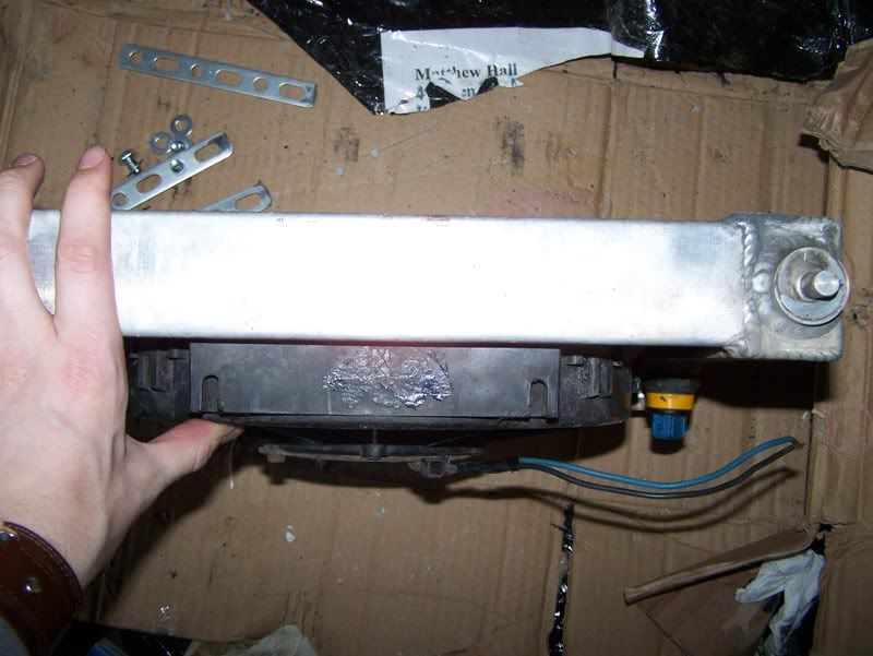

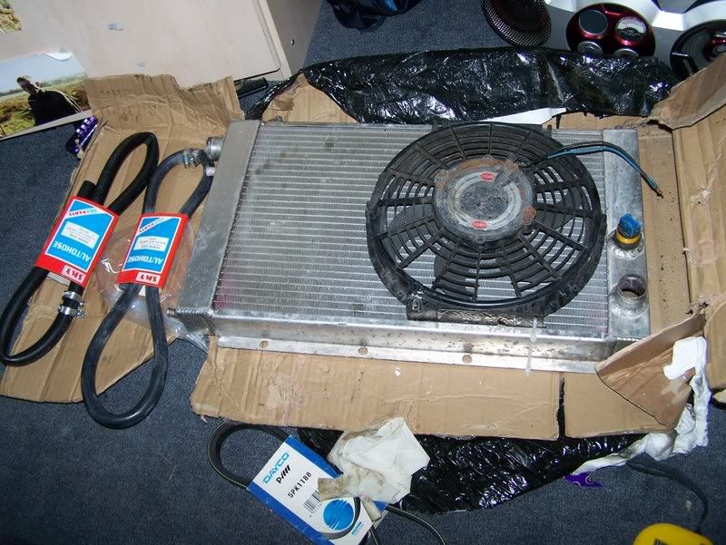

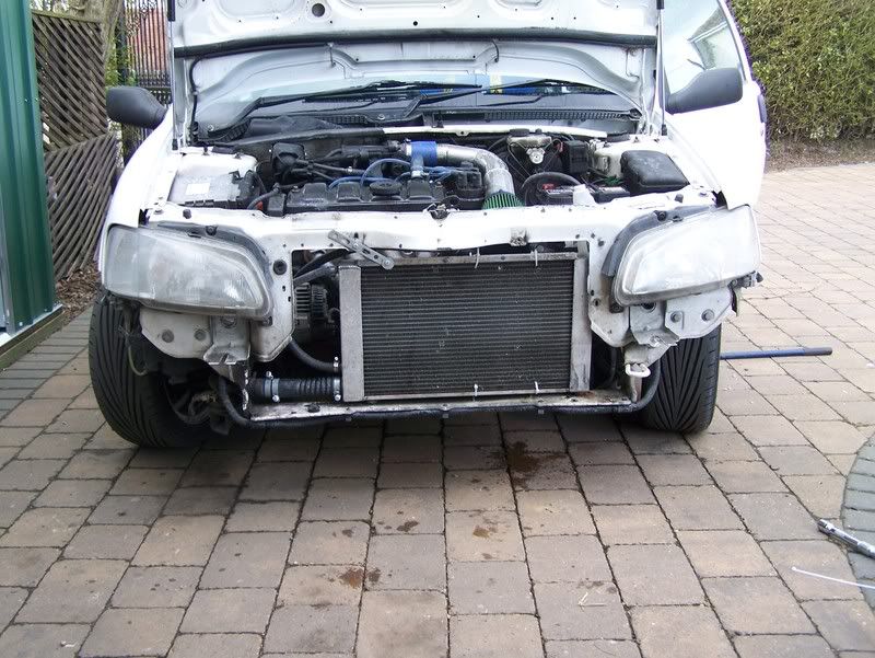

Well, i bought a 106 Derv Rad and 205 header tank (the Rallye standard rad has the header built in) to use for the charger conversion as if i was to use the standard rad the header tank would foul the Chargers outlet. I got these for cheap, but then a week or so later a Pace/GMC Ali rad came up for sale, it came with a header tank and a slimline fan for a price that was far to cheap! :lol: new there about £600!!!!!!!!! :shock: and thats just the Rad no header tank or fan! :rolleyes:
Its nearly double the thickness too! :)
Anyway in the snow on saturday i fitted the new Rad, got a Tad inpatient with the mud guards, so lets just say they wont be getting refitted :look: , bumper off standard looks like this! :)
about 2 mins later, only hard parts is the fact you have to lengthen the bottom hose a tad and it looks like this
When i go Fusion for my boost pipes ill get lee to make a decent bracket for it! :)

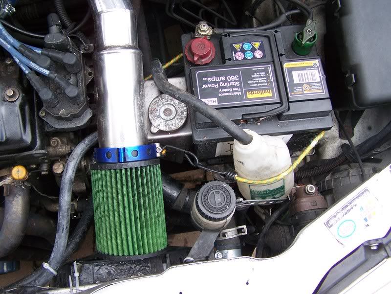

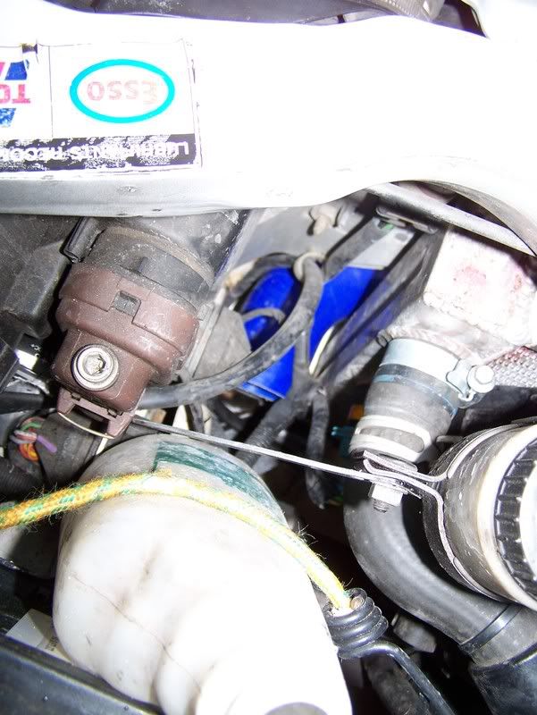

The Fun part was finding a place for the header tank, this took nearly an hour to try and sort, i had to place it next to the battery and held in place with a bungee cord :shock: :insanity: :lol: I need to relocate the battery to free some space and the header also needs the bracket modifying so it mounts better! :)
The bottle is the temp expansion tank! :lol:

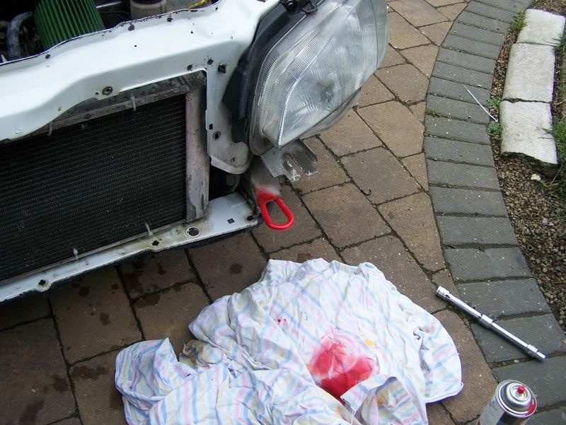

While i had the front bumper off i painted the Towing eye red as it looks sooooo much better in Red! :)

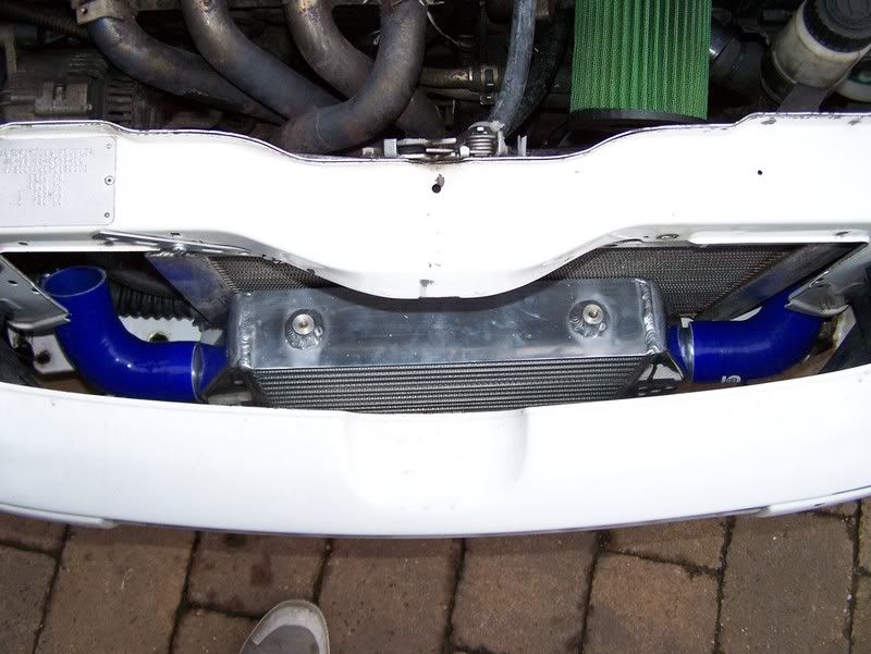

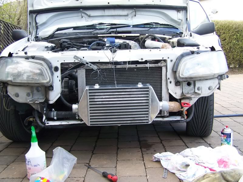

I then had a trial fit of my intercooler and used some guttering down pipe as boost pipes, this confirmed that i will need to relocate the battery! :)
Hose will come up and cross over where the battery is, as far over the right as i can to avoid heat soak!

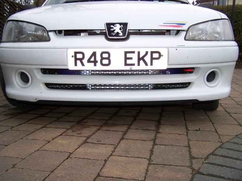

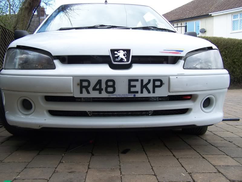

I put the bumper back on with the IC in place, looks good i think, nice and sleeperish, for hard driving/sprints/track time, the number plate will be removed and i'll have a number of holes drilled into it to aid airflow! You will also see how much better the towing eye looks! 8-)

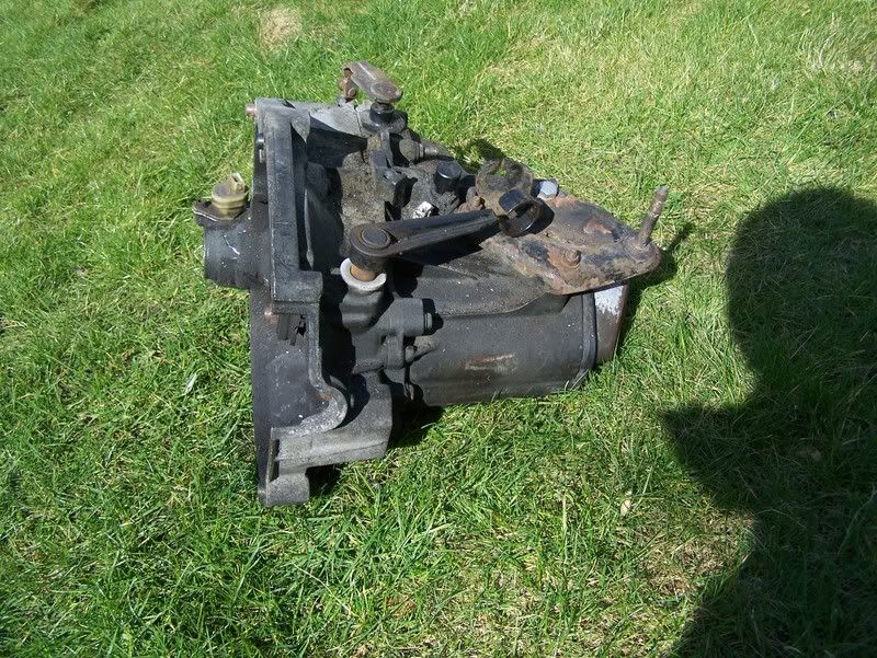

A saxo VTR gearbox, they have a longer Final Drive and are known to be slightly stronger! :) Plan to run it while the Rallye box gets rebuilt with a Quaife LSD! :chill:

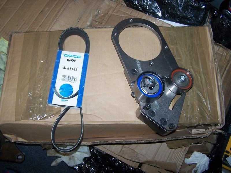

GMC charger bracket, with Idler and tenshioning pulley and the drive belt! :)

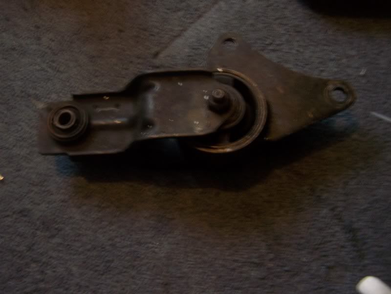

A lower engine/gearbox mount with a Group N mount pressed in! 8-)

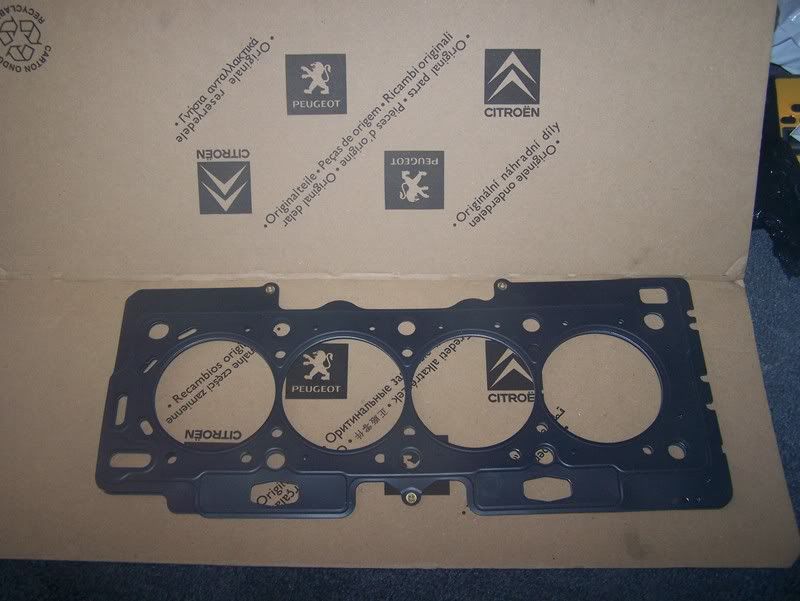

A Multi layer steel headgasket, its about 1.6mm thick!

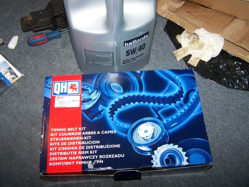

Timing belt kit and some oil! :homo:

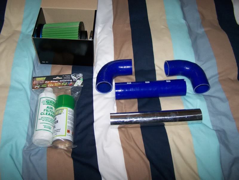

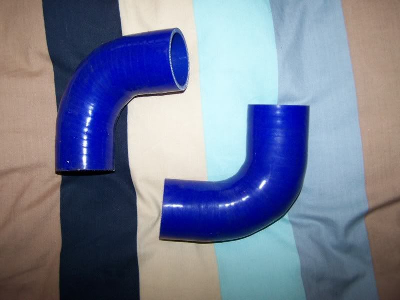

2x 50mm 90* Silicone hose's

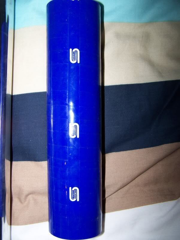

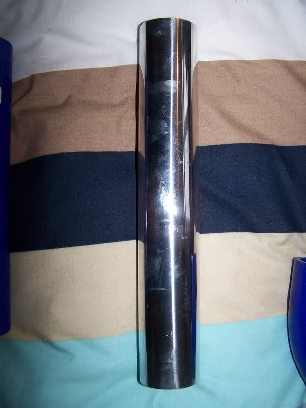

50mm 300mm long stainless tube, will be from charger to intercooler!
50mm 300mm long Silicone hose, to join the Tube to the Charger, got 300mm so i could cut to desired length and use the rest for couplers. 8-)

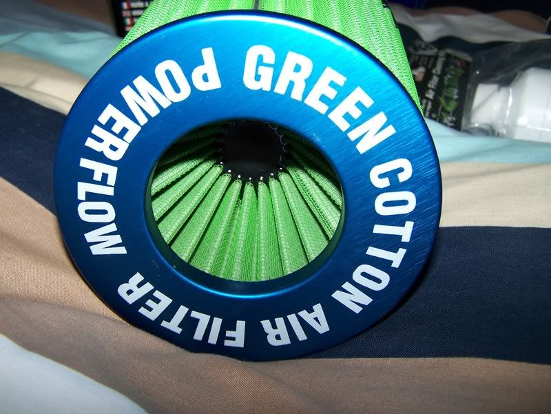

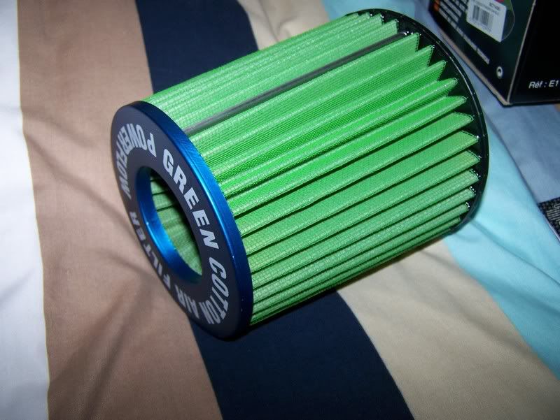

Green cotton 150mm 60mm connection, powerflow filter.
And because i ordered a 200mm and they didn't have any in stock and couldn't be arsed to wait 10 days for it to come in stock, i changed it to 150mm and they refunded the difference and gave me a free Cleaning kit! :lol:

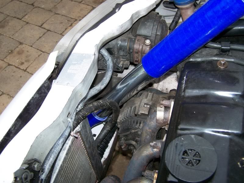

Pic of Intercooler and hose's in place, can be seen a bit more now!
Don't worry the IC wont be that close to the rad, it just balanced in place!
Hose will be angled up for the Boost pipe to the inlet once the battery has gone!
And plenty of hose/tube, may even have to cut the tube to down! Charger sits just above the alternator :chill:
