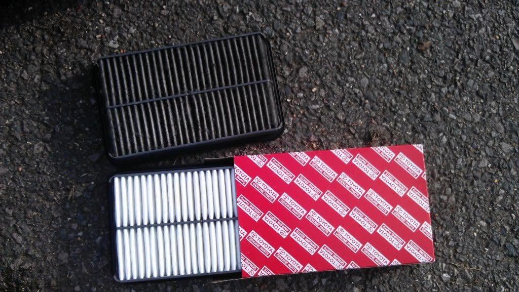

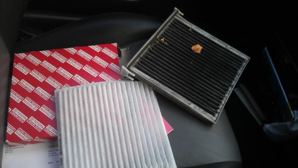

Also went to toyota and got a new airfilter and cabin filter as both mine were black!

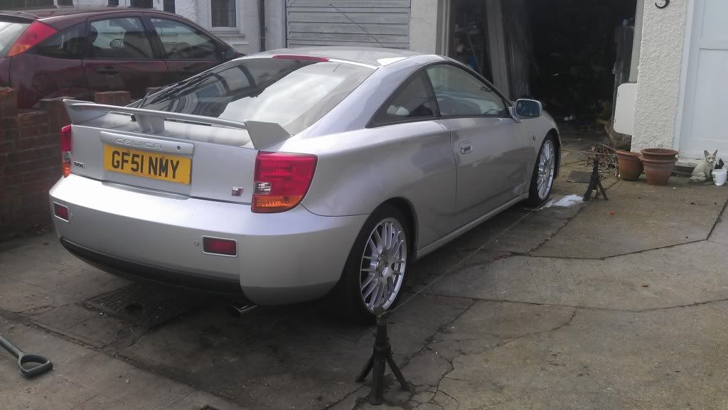

I have been working alot lately and havnt realy had time to work on the car with work and wedding planning so today i got over to my parents to inspect the suspension, nothing seemed out of place so i staterd to try out the old string and measure tracking system, set the string at 30cm from the center of both wheels, back wheel was fine, tracking true but when i measured the wheel that hit the hole i got readings of ....
F
\ 29.5cm
\ 28cm
R
So the wheel was toeing in by a good 1.5cm which is rather drastic! you can see it is toed in from the photo, the steering was centered in the photo, adjusted the track rod so it was as it should be and went routh to the other side od the car but both wheel were purfect, took the car for a drive and i am shocked at how much better it is to drive now! my steering wheel sits in the center as it should and doesnt pull attal ! 8-) :) so im happy!

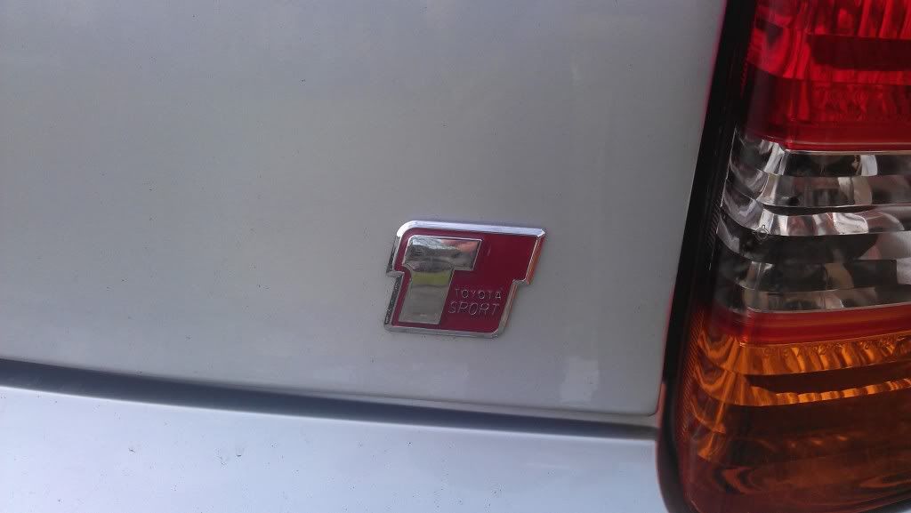

And last off my new badge if you hadnt noticed on the last photo, a T Sport badge as this is a t sport in a vvti shell :lol:
I like it, i could have had VVTI-190 badge but though the t sport one goes with the seats as they have this same badge embroided into them :chill:
