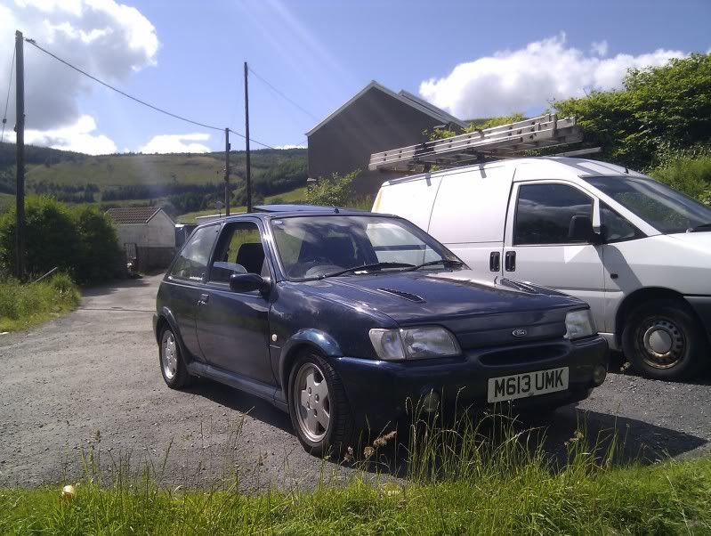

went to Glyncorrwg earlier for a spin, found a nice spot and in the lovely weather i felt my hand reaching for the camera :thumbsup:
after some "sight seing"
love this one

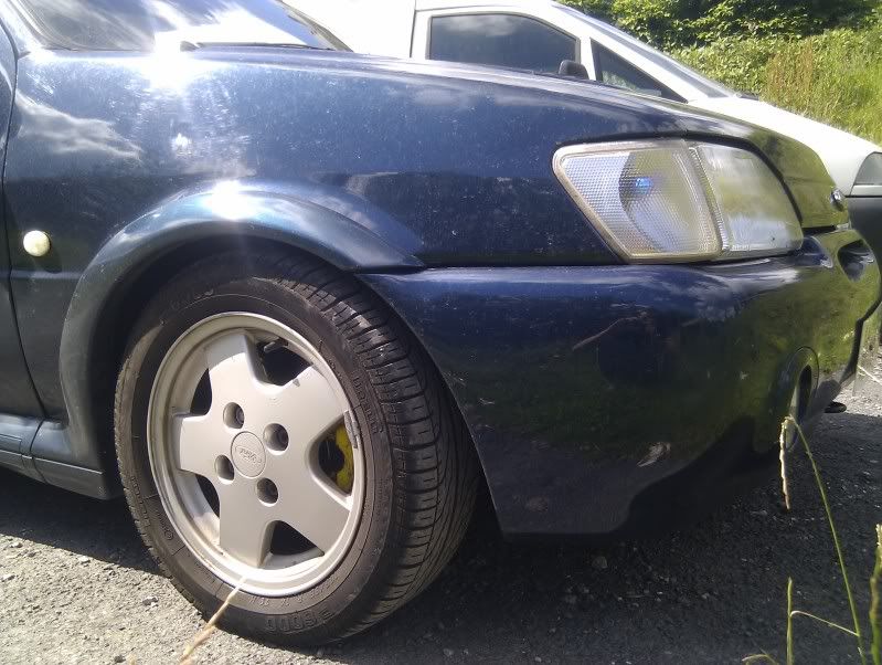

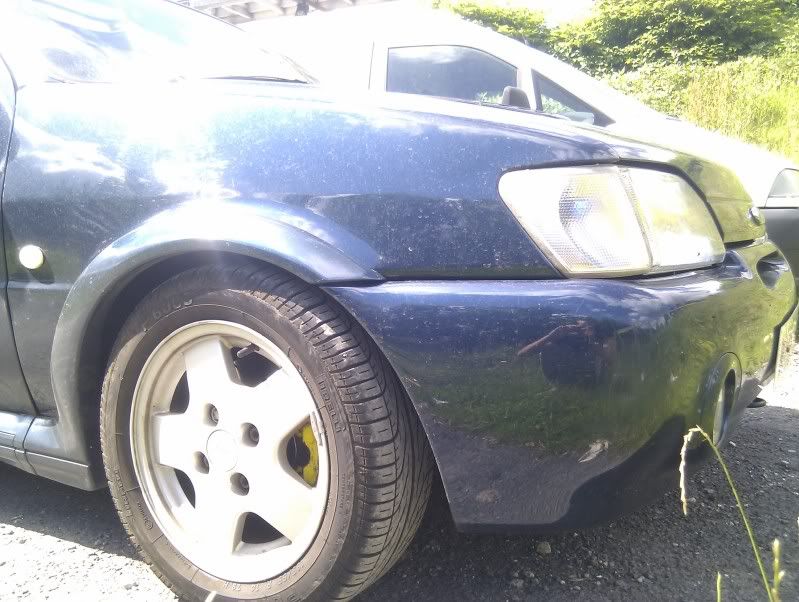

to demonstrate how low it is considering its merely a 30mm drop
the rain over the last week has left it dirty :(

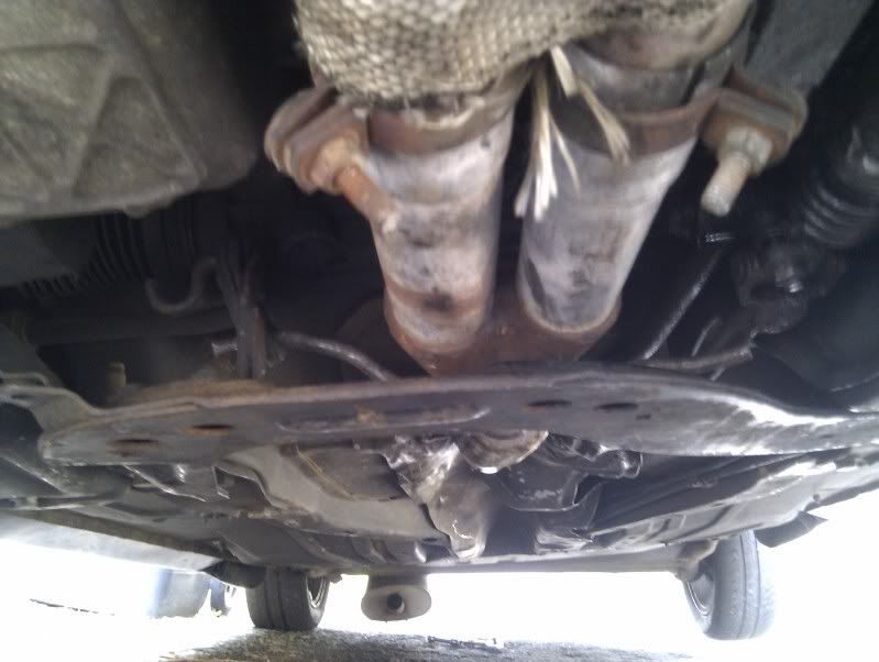

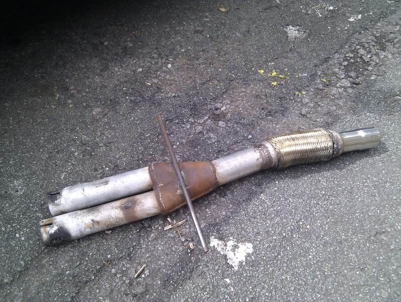

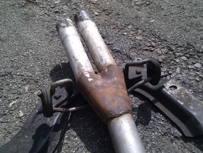

order a new exhaust joint, might arrive tomorrow/saturday, if so ill take off the 2nd part of the four branch and have the joint welded to the flexi, the other end will be slotted and will fit and clamp as normal to the midsection, should put an end to leaks, might need to use some exhaust sealer as the direction of flow is the same as the way the joint will slot onto the midsection which is not common practice
will also be making/welding a proper hanger mount to each side of the 2nd part of the four branch (the two pipe piece that comes seperate from the 4 piece primaries)
i need to work out how theyre to be measured first but they will use the conventional rubber hanger that the standard set up uses so i can retain my standard mount setup

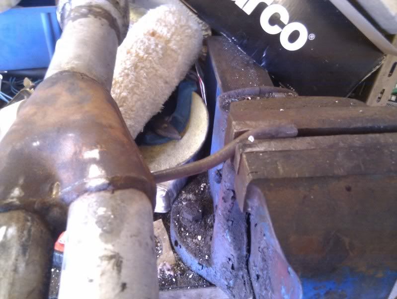

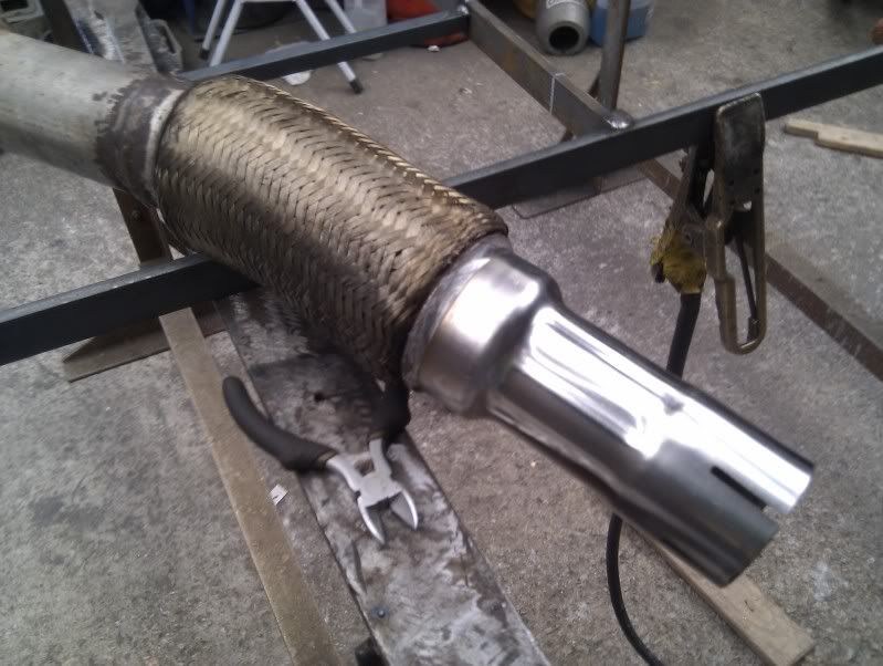

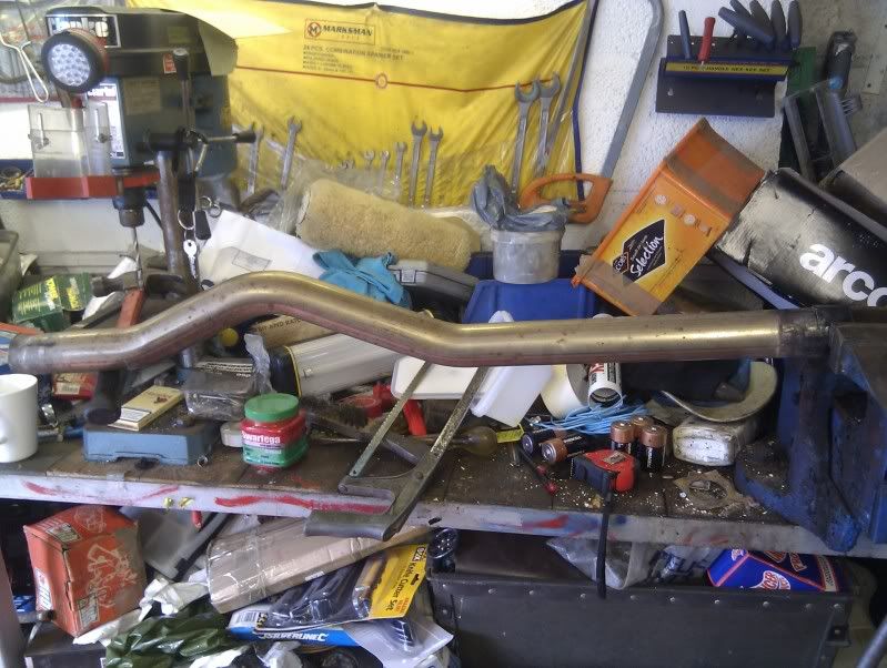

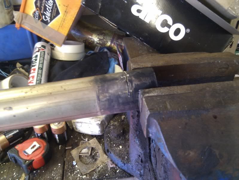

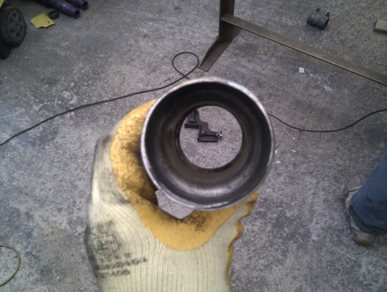

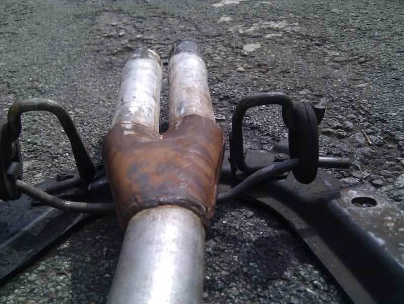

got the car up in the air, got the second part of the four branch off, then removed the stupid joint

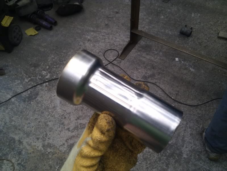

and then took the section and the new joiner upto my mate grayem for the welding done

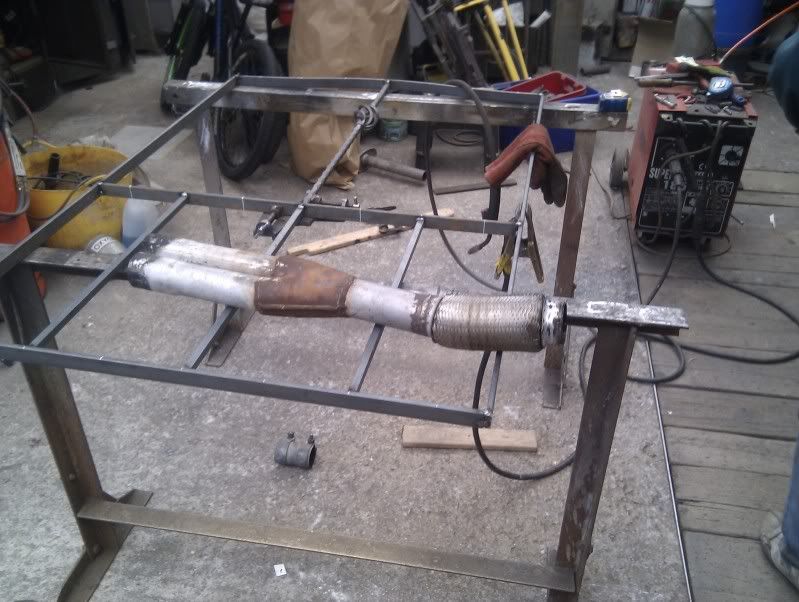

after a cut to size i ended with this
its to fit like this

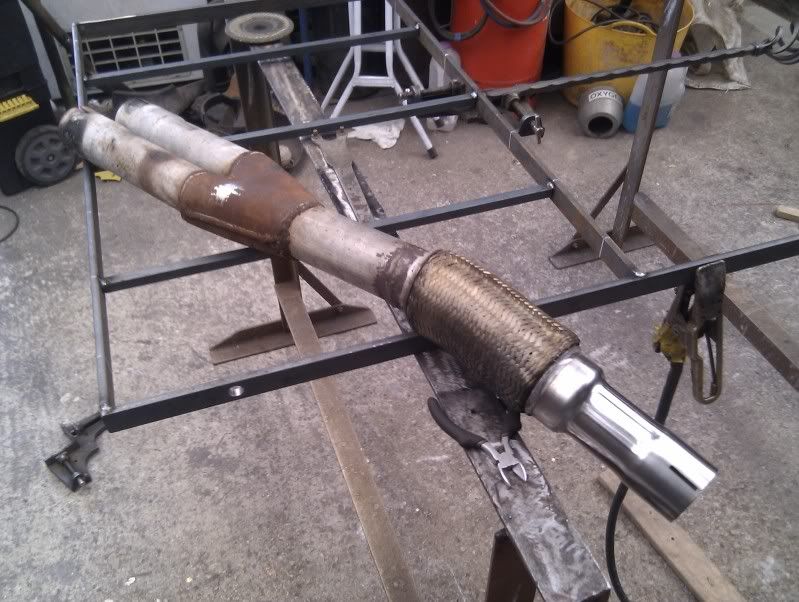

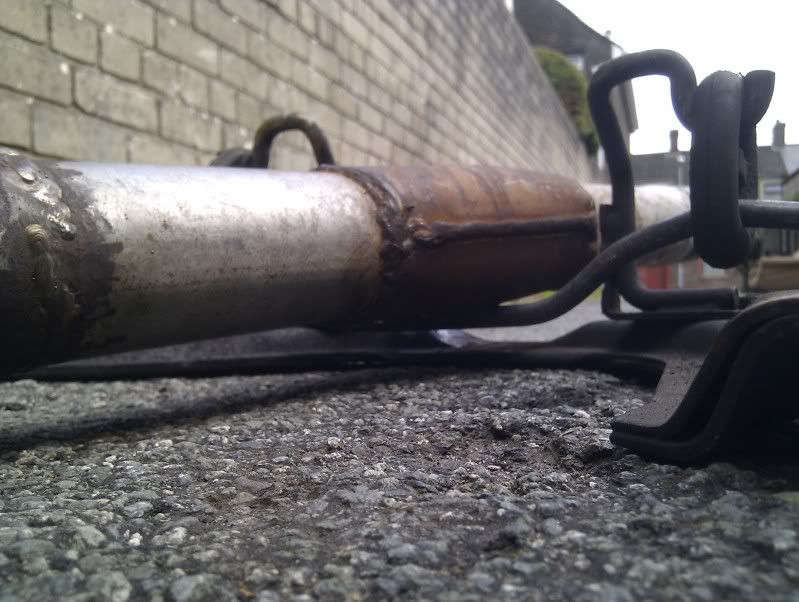

all done welded up to it, and a new hanger, new slots cut into the end piece for clamping
began to shape the hanger
by constantly referring it back to the hangers on the S brace
im just glad it all clears :)

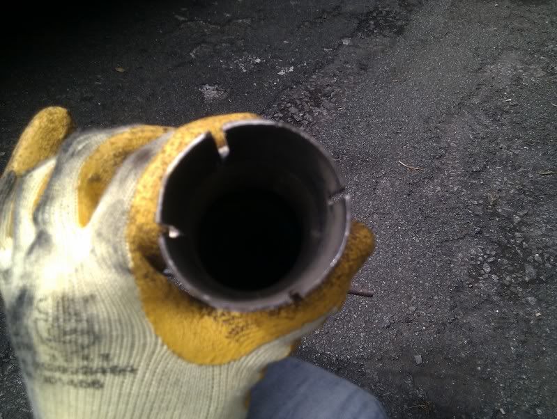

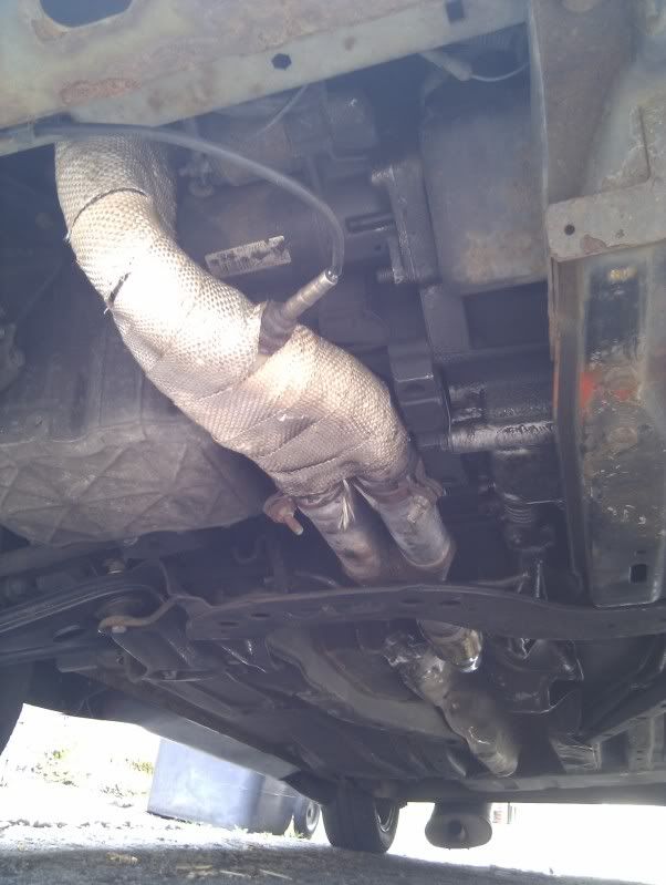

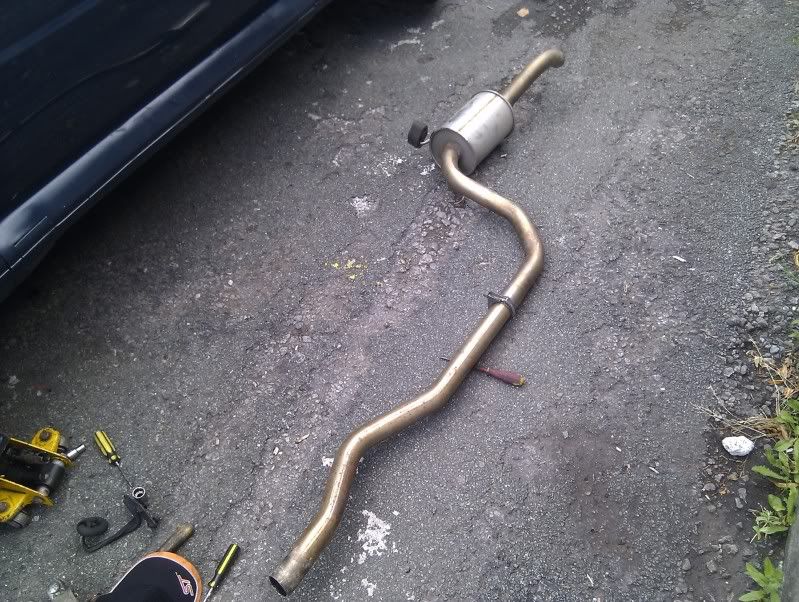

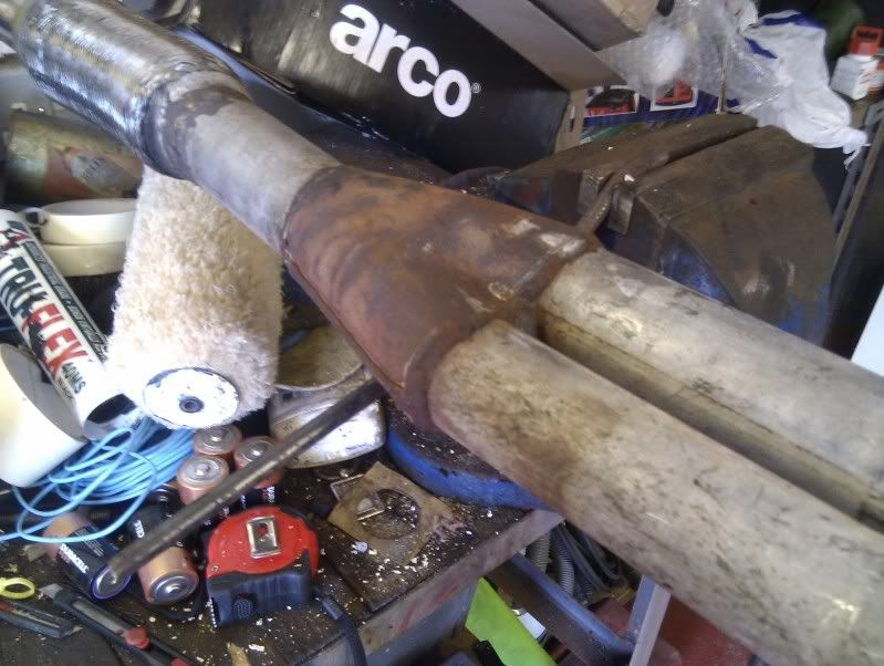

after that was done and offered everything up under the car, i noticed everything was too long and would not piece together, and also the midsection was out of place and needed aligning.
so i removed the entire midsection, and left the backbox there
split the midsection in half at the joint, ready to make it shorter
i still have plenty of it left if i need to extend it when the standard downpipe/cat goes on for the MOT
with the section back on the car
i refitted the midsection, slotted it into the new joint that was welded to the four branch, fits like a glove, backbox refitted and im happy with the result
the exhaust joint was ordered from MIJ Exhaust, a shop on ebay etc and i woul highly recommend them, they do custom orders like mine or off the shelf parts and a wide variety of suitable pieces of exhaust
no more knocks and bangs, and the backbox is centred in the hole in the bumper, which is good
tomorrow now i will quickly take the bits apart to apply exhaust sealer paste as it is slightly blowing still

Did he mig weld that?
PostPosted: Sat Jul 09, 2011 3:25 pm
no, actually dont know which its called, was the rods that you fit into the gun

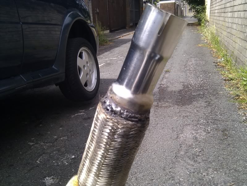

tbh im a bit dissappointed, its leaking from the weld
had everything sealed today, not a clamp it knocking the heatshield!
ugh ill never be free of this bloody exhaust
anybody interested in a 4-2-1 from ashley for your zetec... think twice!
its worth the extra money to get a more expensive stainless one
