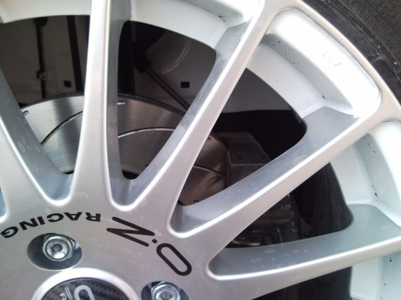

The Loumiester,
i rubbed the arches down with some 180 grit sandpaper, sprayed just some normal white spray on them and just before it was fully dry i sprayed some white hamorite stone chip on it so it sagged a little to go in all the gaps and seal every thing, once fully dry i sprayed it with the white spray again,
its the same for the rear only i didn't rub it down

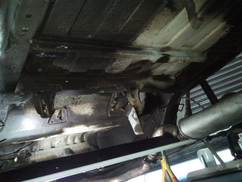

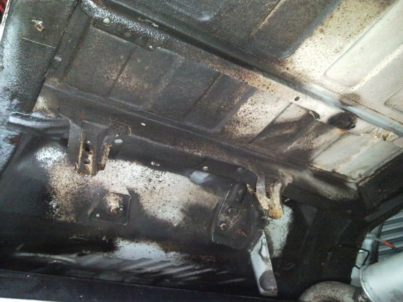

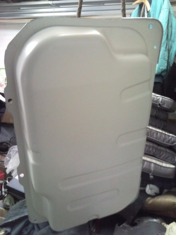

cleaned the underside if the car, a previous owner has shultzed the chassis and half the car lol
i got quite wet and mucky doing this but it was worth it didnt even find any rust so im pleased
update for you secret ones

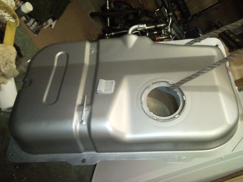

fuel tank :halo: de rusted sprayed in silver on the top and on the bottem stone chipped spray

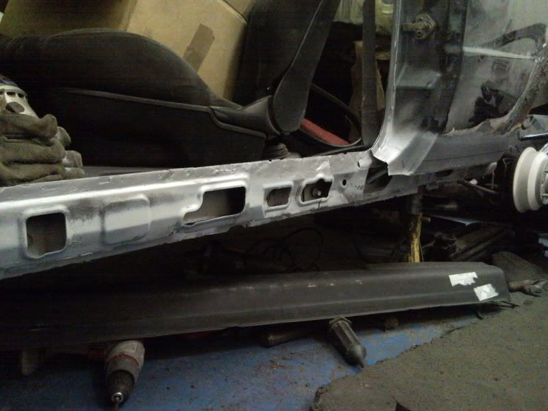

and took my side skirt off for the time being couldnt belive it come off all in one
and the front

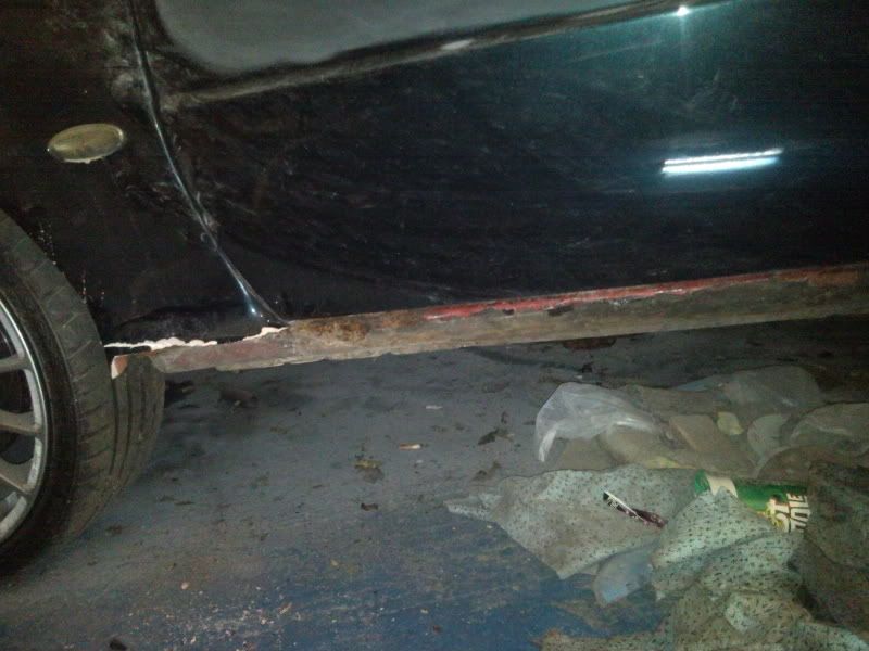

PostPosted: Sun Oct 10, 2010 9:32 pm

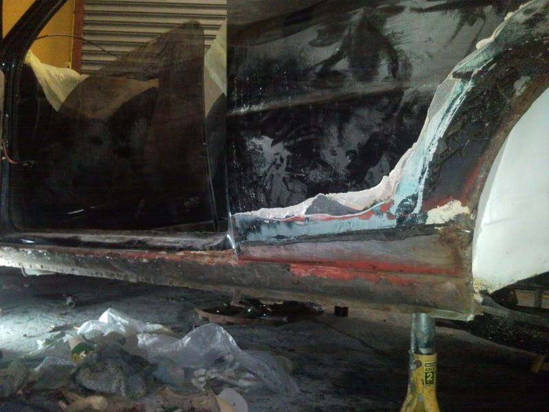

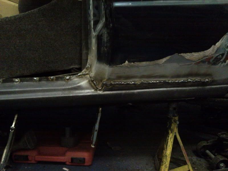

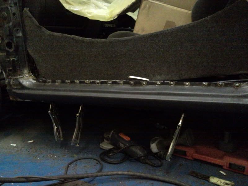

removed the front wing and sill cut off,
sill welded at the top and thats about it for now just need to finish off the bottom and grind away as you may see its butt welded
