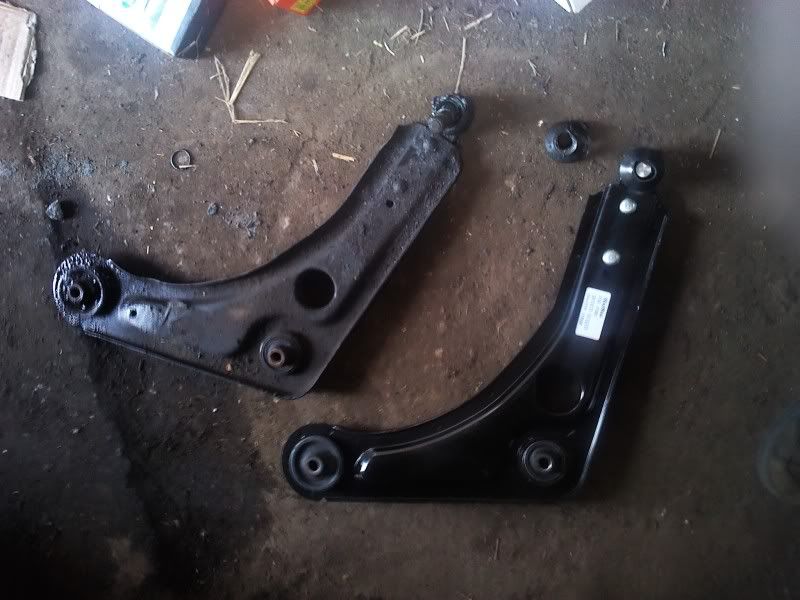

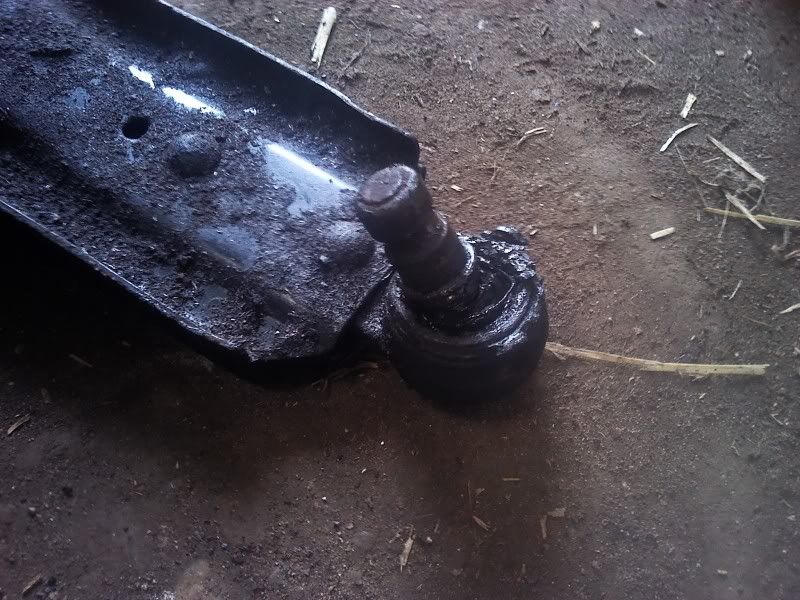

Still shaking abit but my wishbones are shot to bits, and I mean shot :lol: - so will be fitting the new wishbones tomorrow...

Wishbones on - after alot of fucking about with one bolt, as ford are pricks.
Shaking still there, gonna wait till the wheels are sorted and then if it doesnt sort it I'll swap a driveshaft from the van the night before FITP :lol:

Can you spot a problem???
Both been like that all year :lol:
PostPosted: Sat May 07, 2011 7:52 pm
:lol: :lol:
Bet it handled beautifully on them paul :thumbsup: :lolz:
PostPosted: Sat May 07, 2011 8:49 pm
I wonder why that was driving like a bitch????
PostPosted: Sat May 07, 2011 10:06 pm
Fookin hell
PostPosted: Sun May 08, 2011 10:02 am
I get used to driving fords with nackered wishbones so it never bothers me, plus the roads are so shite i never notice :lol:
Drives alot better now tho!
