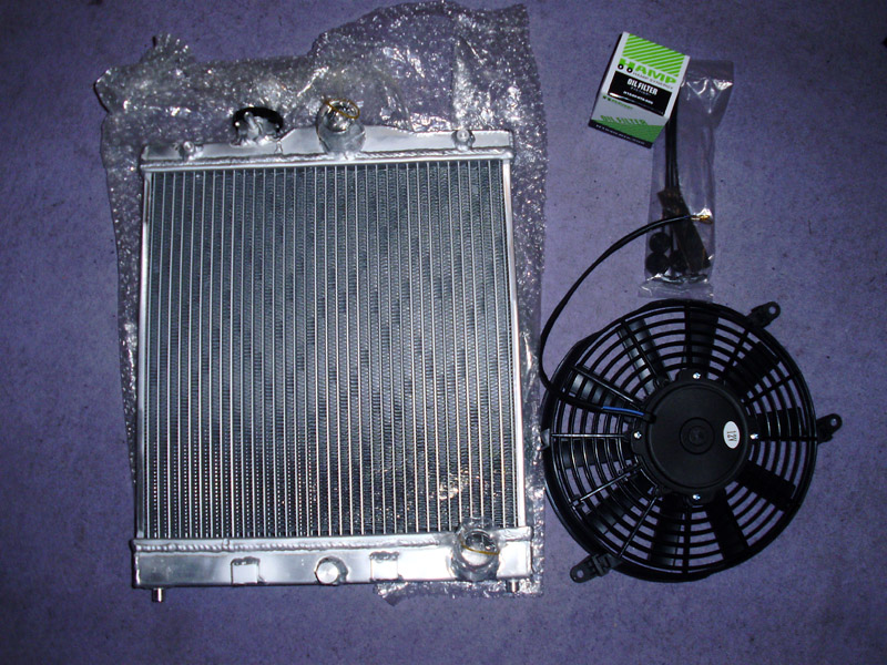

Speaking of turbo, I've got a shiny new half size double core cooled radiator and a half size depth radiator fan to fit at some point - need to chop a bit of the chassis though, so not exactly straight forward but not difficult either, just need the time and space. Waiting for the missus parents to go on holiday then.. :lol:
Random how the camera picks up even the slightest bent fins with it's flash :o
