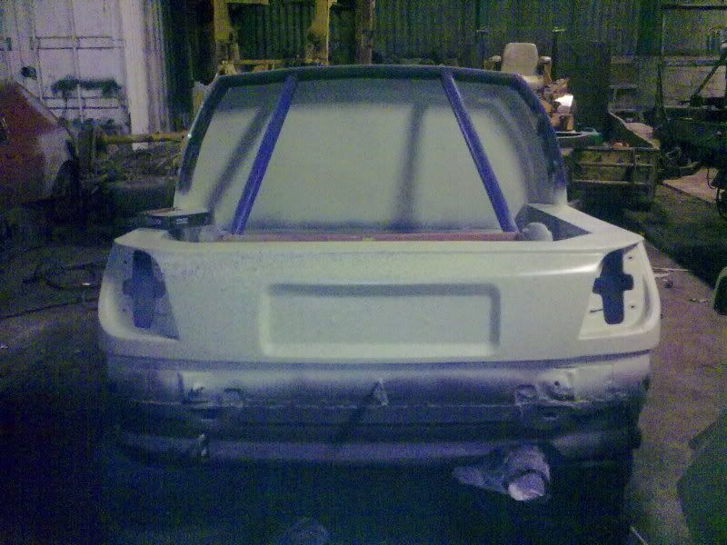

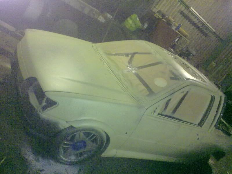

Here is the pickup in primer, which is all flatted down now awaiting some proper paint :thumbsup:

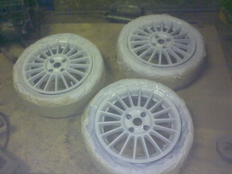

Along with the new set of wheels, awaiting paint :)
You shall see the finished article in a few weeks!

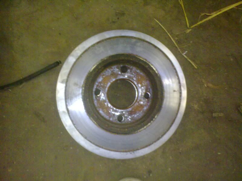

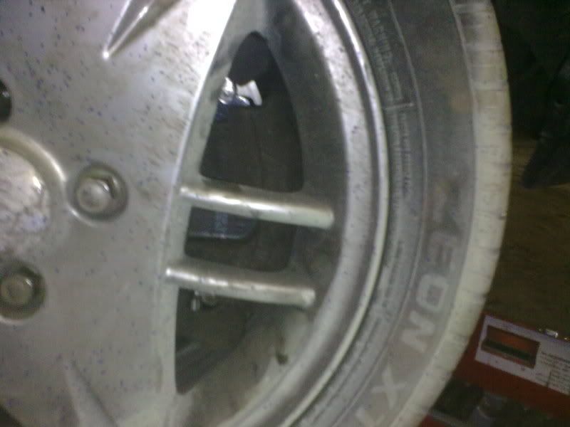

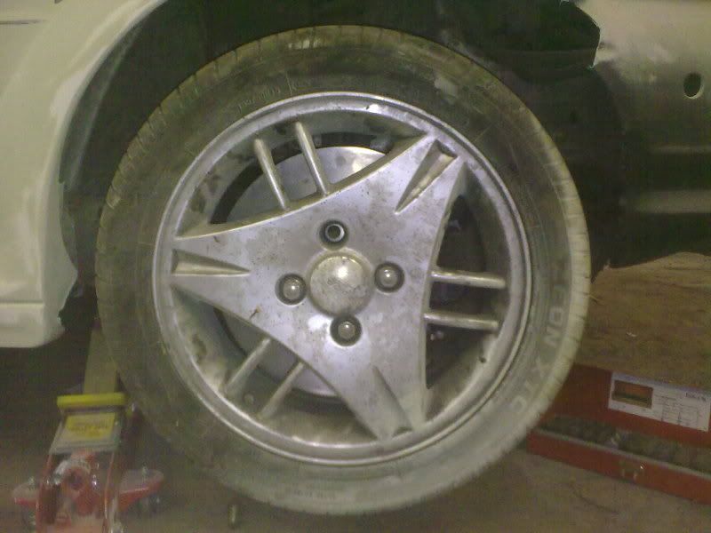

But the thing I am best pleased about this weekend are these new brakes!
See compared to the standard fiesta vented ones! (new ones at bottom lol)
They are..
MK3 Mondeo Calipers
MK3 Mondeo Pads
Focus ST170 Disks - 300mm
12mm holes drilled out on the hubs already
Bolt straight on, no spacing, just cut down the bolt if its too long. Job done!
Don't fit 15's.....
16's are a must :lolz: :thumbsup:
Best of all, its cost me a hell of alot less than the usual cosworth brake upgrade :lol: and they are 300mm so I should bloody stop now :lol:
