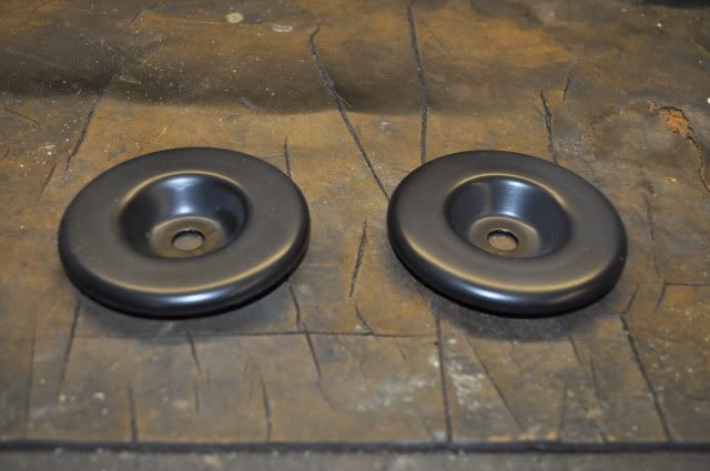

been spraying with satin matt black again
suspension tops
metal bracket that goes around the heater pipes in the engine bay

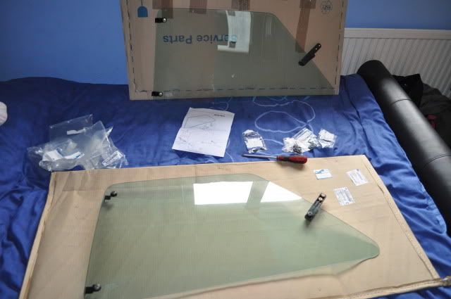

also put the rear windows together with all the new fixings

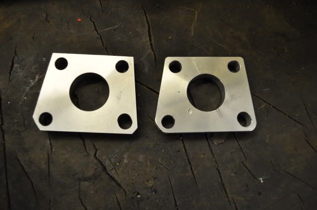

the old man finished making my rear hub spacers, so i filed all the edges then
(before on the left, after filing on the right)
after scotching them up, they had a coat of laquer to stop them looking grotty after time

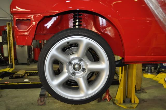

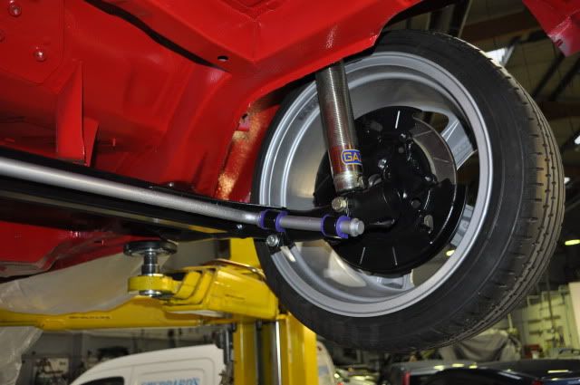

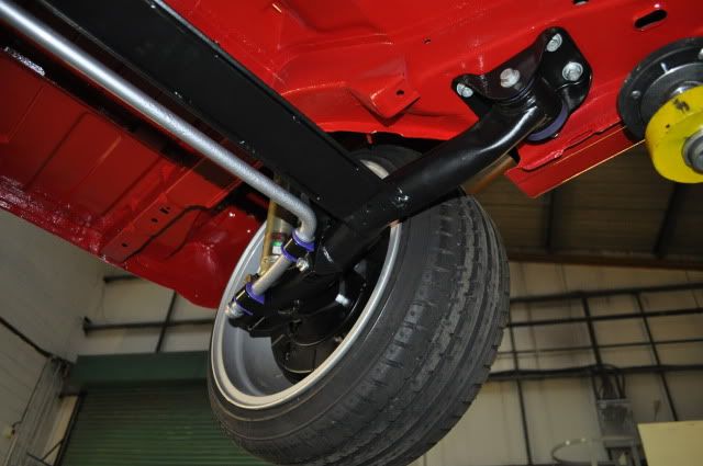

got the rear beam / suspension / brakes together and bolted on the car
although i have two arb brackets on the wrong way around
