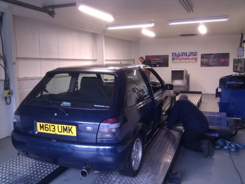

well today me, danny and kris went with ZSOC to GotBoost in brackla Bridgend for the rolling road day
first off, great seeing everyone, was a fantastic day, thoroughly enjoyed myself
about 15 of us run, went diesels first then down in order of age, descending, so i was one but last lmao, but after elward turned up he was put to the back of the que
all figures given at the flywheel!
the mondeo ST TDCI made about 180bhp and over 350lbs!
next best down was a chaps mk2 XR2, 2.0 zetec on bodies 4-2-1 etc, made 166bhp but only 126lbs
the mk4 1.7 with sports cams, 4-2-1 and remapped etc made 140bhp, but a low 100lbs of torque
kris made 108bhp, danny made 99bhp
on to me :)
run
Video
print out: made 126bhp and 126.4lbs/ft of torque (which was the most torque made out of any of the petrol 2.0 or less run)
very chuffed, power is down however, i was informed how the car is overfueling quite badly, graph shows how its as low as 11 parts to 1
i was told to sort out the exhaust blow at the flexy, and the lambda should sort itself out as its reading too much oxygen in the system due to the leak, after that it should cure most issue sand produce more power
this is a comparison with the escort Gti that was run, it was rebuilt 400miles ago and only has a 4-2-1, that made 127bhp and 100lbs, but the power/torque curves really do speak for themselves, mine was far smoother and progressive
so result.. sort exhaust blow and it should get better, if not the lambda is misbehaving and overfueling it, i needs sorting though as if i continue to run it like that for the years to come it will get clogged up full of carbon in the cylinders and exhaust etc
will take it to be run again in the near future to see if its improved after sorting it
ill make a thread of the pictures i took :)
