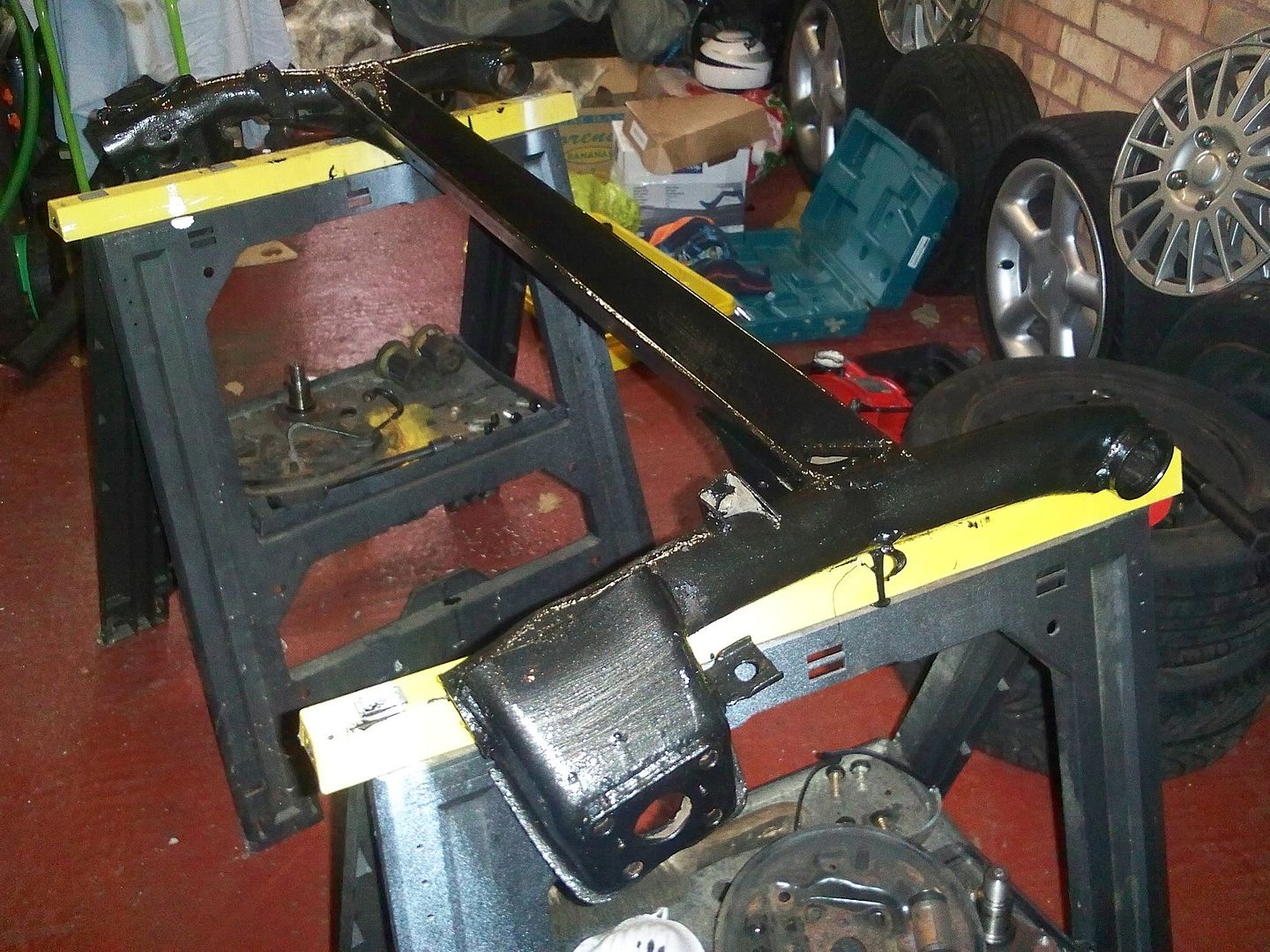

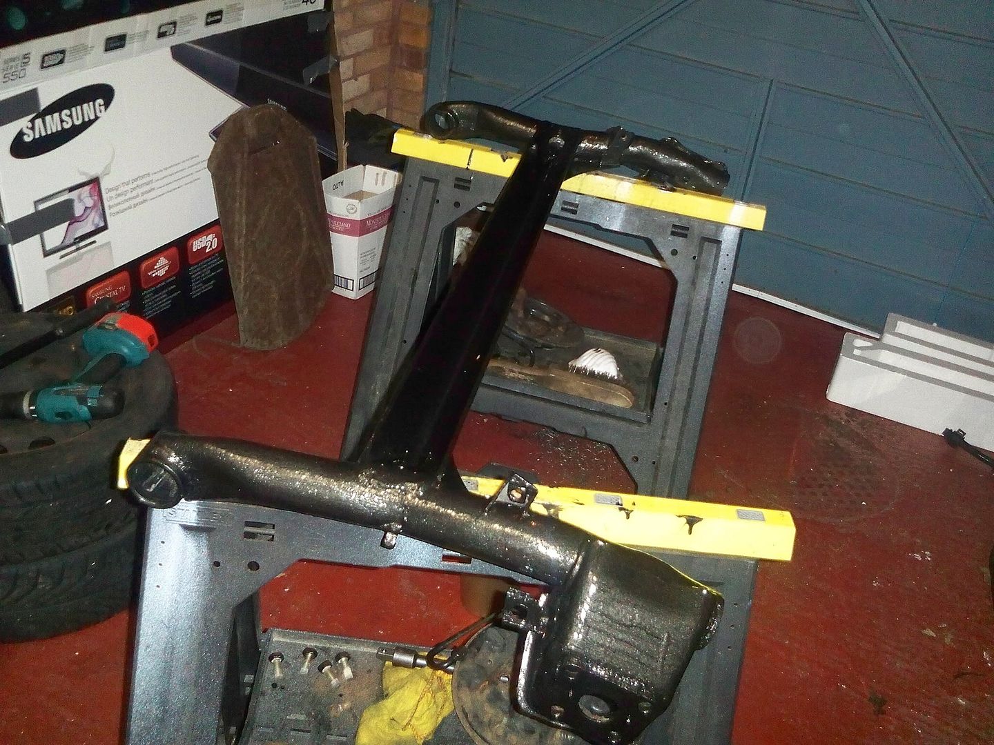

Posts: 1516
Beamage!!
Bad pics :P
PostPosted: Wed Mar 30, 2011 6:24 pm
is that just hamerite? looks good
is it easy to remove?
PostPosted: Wed Mar 30, 2011 6:30 pm
Posts: 1516
Yeah hammerite, and it's a b?stard to get off lol
PostPosted: Wed Mar 30, 2011 7:41 pm
hmm, kinda puttin me off pulling mine off lol, have you done the arb yet?
