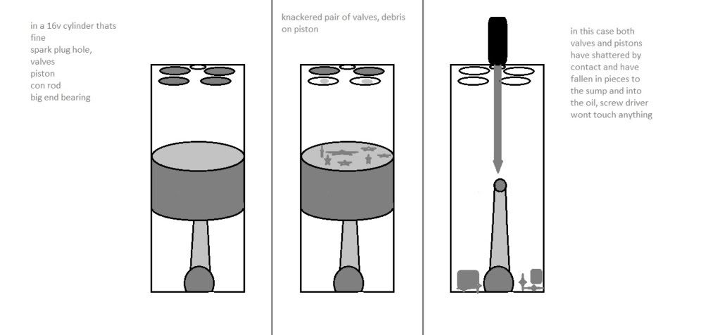

So there will be metal in there? So what am I checking for to see if the pistons are damaged? Cracks on the top or what? Can you give me the dummy's guide for what to look for as I know how to check and what to take out and how to see all the pistons but not sure on what i'm actually looking for.
So if there are metal filings all on the pistons thats the valves that are fubared? Which is likely anyways?
I am hoping the cams are alright! They most likely are but my mate couldn't say 100% that they would be. What am I looking for on them to find out if there ok or knackered? Obvi if there cracked of snapped i'm fucked but if there badly scratched on the lobes? or scratched at all is that bad or what?

PostPosted: Thu Dec 22, 2011 11:41 pm
this should clear things up :)

OH just to add, you wont be able to see a hairline crack through the plug hole, you may see warping or sagging of the piston crown, but will be hard if its covered in coke, which is likely (burnt petrol thats remained)
i very much doubt its damaged the cams, but none the less you can check by seing obviously if any have snapped, that the lobes dont have bad scoring, or miss formed lobes and no nasty heat patches on them, use your finger and run over the lobes to feel that theyre still smooth

Cams look fine. Pistons are all there, tapped them all and there all sounding the same.
Didn't need to put it to TDC and the screwdriver reached them all, tbh it felt like they were all in about the same place.. had a look and in the tiny gap It all looked pretty smooth. But time will tell where the damage is, Wednesday my mate comes over for the proper strip down.
