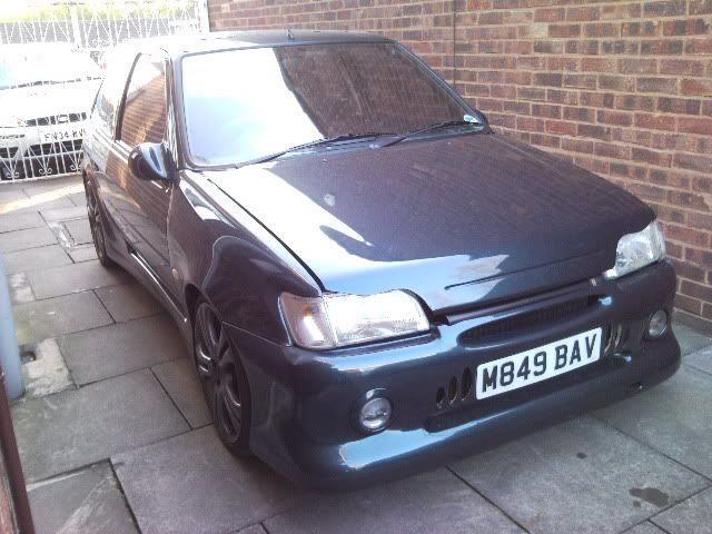

cheers me dudies heres a picture for you, if its not to big

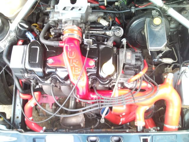

update
iv got my new beige injectors managed to get my temp gage working out of the wires i couldn't find where they went (see above updates for more info)
only got the rev counter to work properly as it kinda works but its too slow
im getting the delivery of my newly built up turbo on monday morning so all is coming on for f.i.t.p.

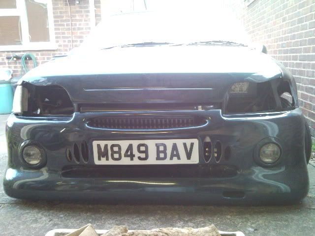

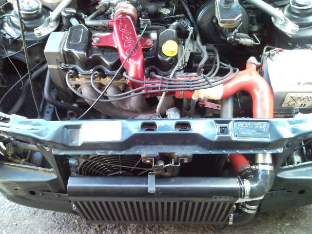

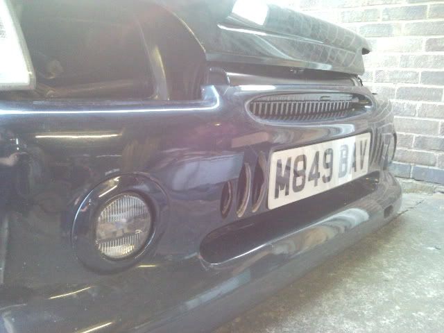

reet less talk more photos :D
front bumper removed :shock: and intercooler and rad fitted
my front bumper i had to butcher to make it fit
while ass this was going on i ordered some red samco hoses that finally turned up after a month and a half off e-bay
as you may have spotted the last picture had no turbo but thats back now after new inturnals that have no play woop
enjoy 8-)
