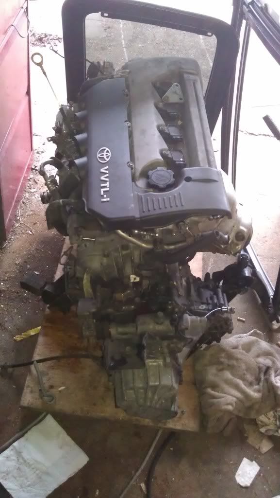

Just a little update.
Everything is on track as i planned. yesterday i got over to my parents at 9am and began stripping the engine loom out of the car ready to drop the engine, wireing loom was a right nightmare to remove, it had been woven in and out of every little gap possible lol. after about 4 hours we had all the loom removed! i then got a bit of wood and some caster wheels and screwed them to the wood to make a trolly for the engine to be dropped onto! I removed all the sub frame from the t sport and the lower engine mounts and then lowerd the car to the ground do that the engine was sitting on the trolly i had made. i then unbloted the two top engine mounts and lifted the car up with a jack and pulled the engine out! so easy to drop the engine out of this car! Anyway the engine is now all ready to be fitted into my celica!

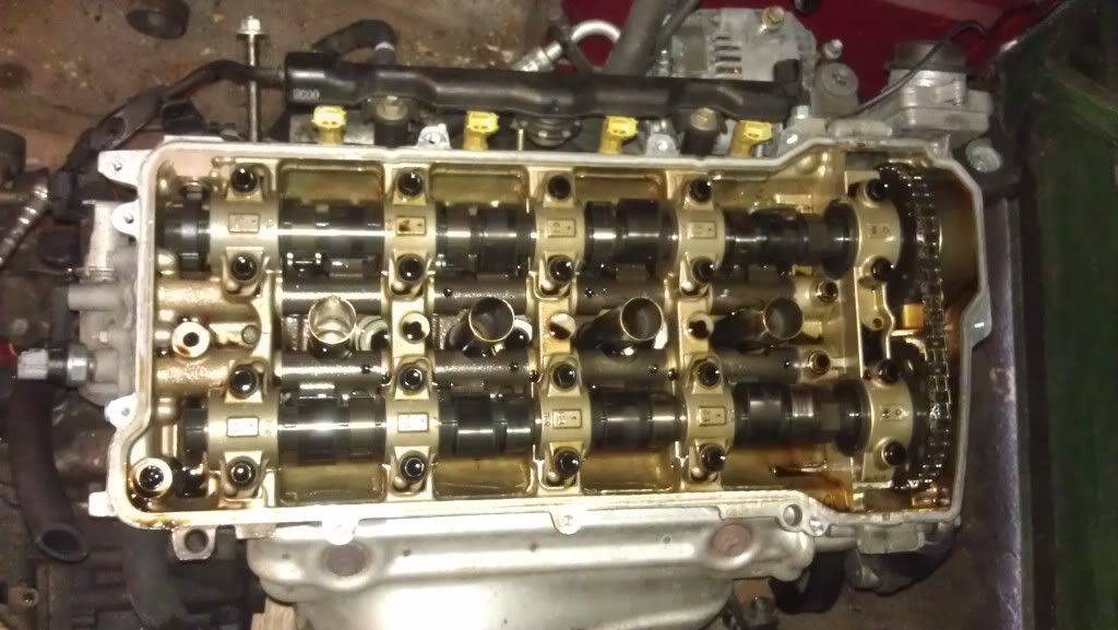

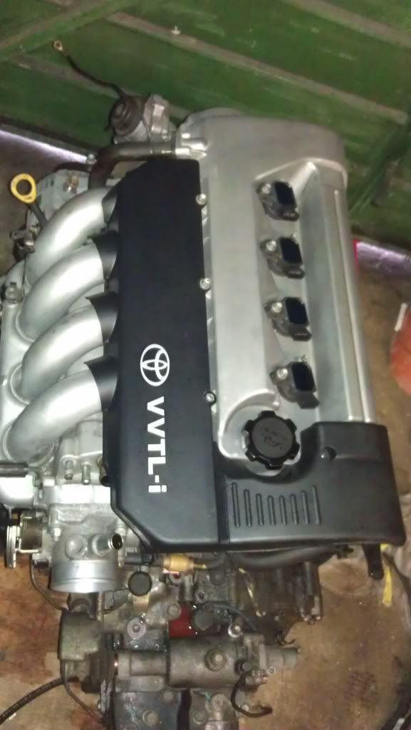

Pic of the engine in my garage

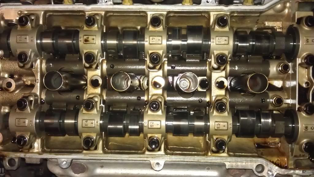

Picture of the VVTLI cams, you can tell the differance from standerd cams strate away!
And me being me, gave the alloy parts a good scrubbing down to get the engine looking mint!

GOOD CLEANING! wow look like a crate engine
does the L in the VVTL-i stand for Lift?
i noticed one of the valves per cylinder is alot wider than the opposite one
good work mate :D
PostPosted: Tue Aug 23, 2011 8:46 pm
Cheers for the comments!
Lol im impressed with how well it has cleaned up! That was just cleaned with water and a scowerer! Still got all the block to clean up!
Yup the L stands for lift, as u said half the valves are alot wider than the others, the camshaft is also bigger on those valves so when it hit 6400rpm it swiches onto the bigger cam which gives u the extra 50bhp boost up the arse lol
