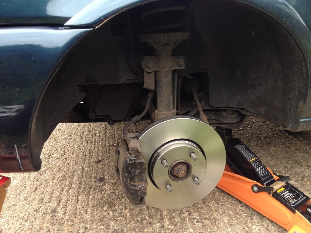

I also noticed I had a horrifically warped drivers side front disc. So these went on:
Both sides done of course:
Brake pedal is nice and firm from the top again. I had a horrid noise at speed most noticeable at between 50 and 60 but also at other speeds above 40 when not on power. I think I may have an underlying issue in the form of a CV joint or bent driveshaft as if I listen very very carefully the noise is still there but barely. Only that would explain one badly warped disc!

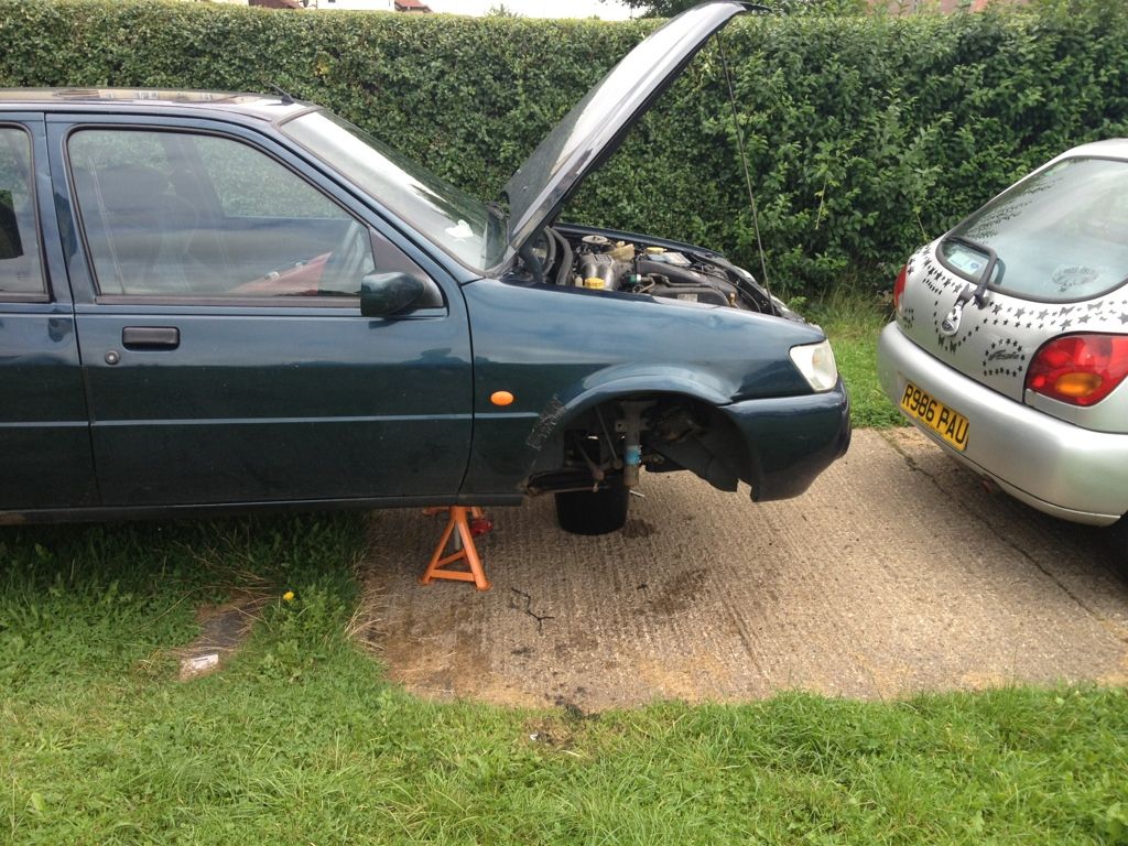

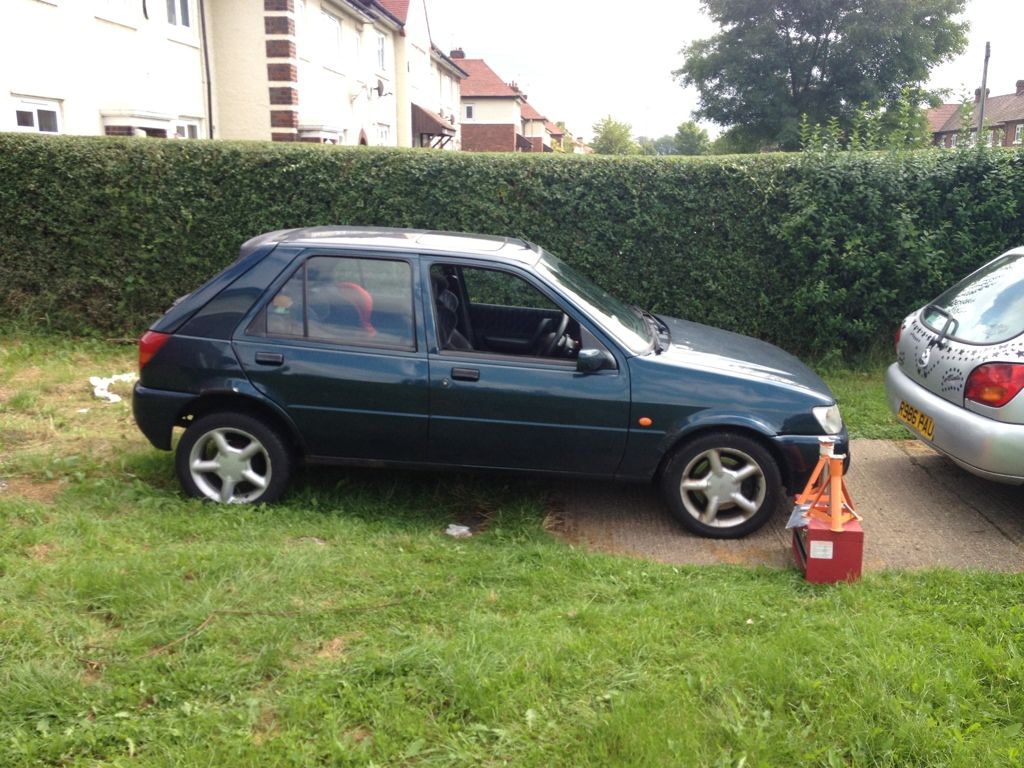

First day:
Best position I could get him for safe use with the stands etc.

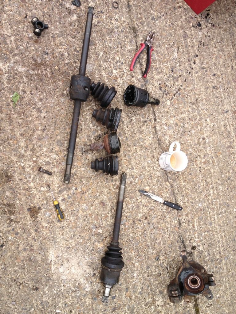

Up and dismantled the offside knuckle and driveshaft.
Got the driveshaft off in preparation for the clutch change and found something wrong with the inner CV.
Looks ok doesn't it?
Well this doesn't!
I actually put that roller back on as it was rattling around in the CV joint completely loose! Think I've found the noise issue I was having!
Mark up two outer CV joints and one inner CV joint.

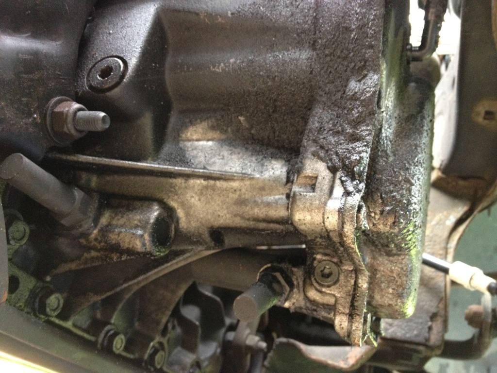

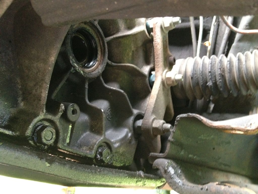

Then got on today with removing things ready for the gearbox coming off and looking at any other potential issues:

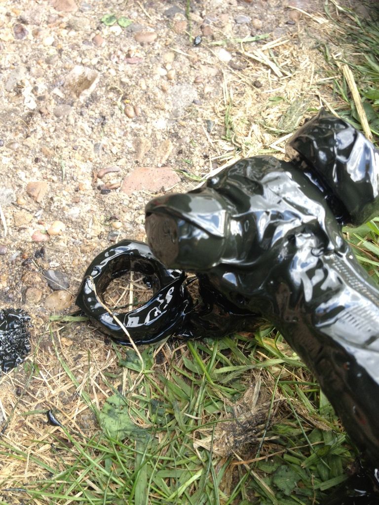

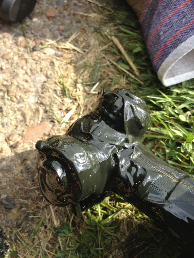

Other driveshaft popped out:
Bloody mucky:

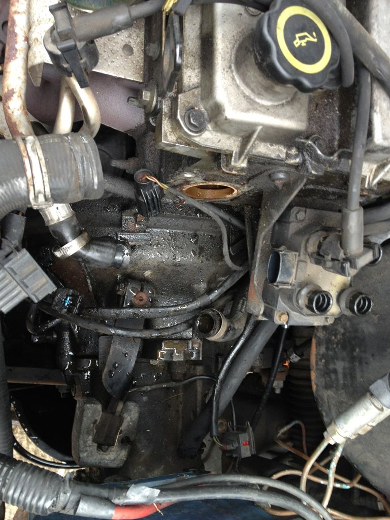

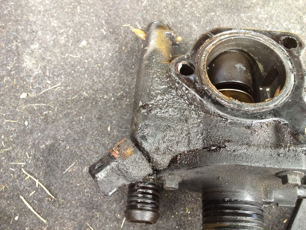

Then took the thermostat housing off as oil is coming from somewhere:
Couldn't do much else as it looked like it started raining, cleared up, came inside. Sun came out. Grrr.
Got a clutch here and getting the CV joints tomorrow. Need some bricks for supporting the engine on the partial drop down then I can get this gearbox off and clean stuff up to find where this oil is coming from. I suspect the rocker cover gasket though.

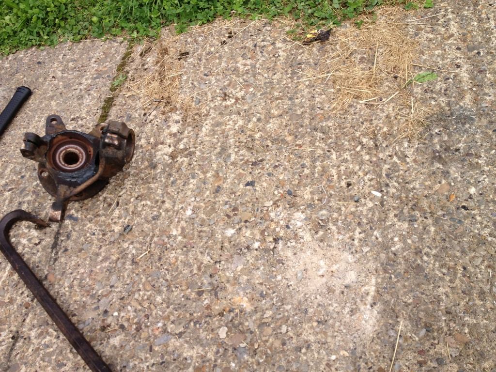

Well, one has flat out refused to budge. I have even written off the hub and just went mental just to see if it would budge. Extreme heat, extreme force, both, other stuff. It's like it was bloody welded in.

Drive shafts dismantled:
The damage done getting one outer CV joint out:
As I said, the other one does not shift at all so I need to get a new hub carrier :(
This took around 3 hours as those CV joints were terrible! I like the shiny new ones though but I'll only be building the drive shafts up when the clutch/gearbox is done.
