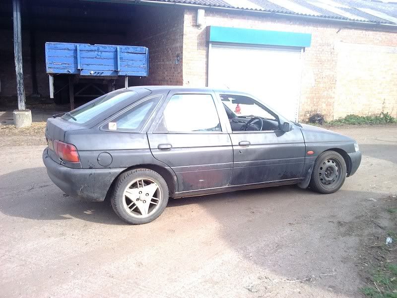

She runs!

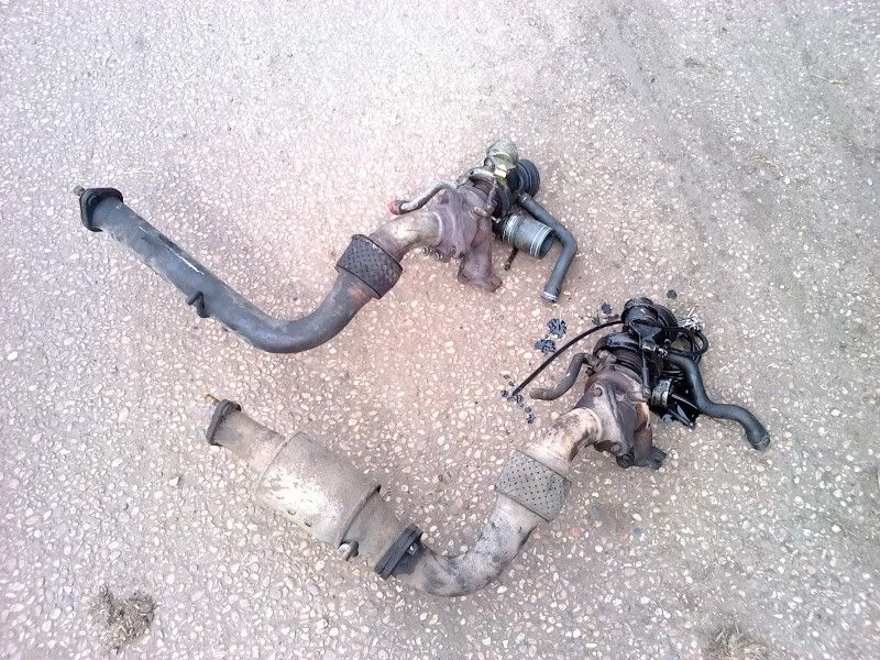

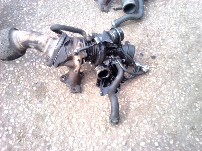

Scrapyard No. 2 came up with a MK5 Scrote TD
Wasnt covered in oil so took it off, and noticed that the MK5's did not use CAT's so I took the downpipe to de-cat mine :D
MK5 vs MK6 (fucked!)
Oily much??
Check out the fucked turbo :lol:

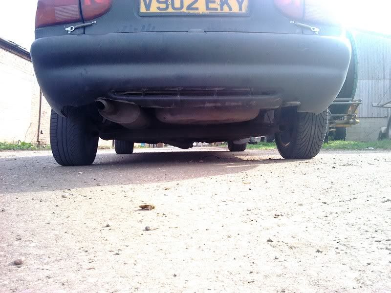

One problem I have is, my exhaust was a cut and shut fix for the last MOT and therefore doesnt sit properly... I'm pretty sure the MK5 downpipe isnt the issue..
So it now sits on the piss and I cant get it on one of the hangers...
So I'll go get the rest of the MK5 exhaust next weekend to sort it :)
And here it sits.. on 15" steelies on the front which need balancing sooooo badly :lol:
Still in abit of smoke at the moment while it clears itself, and I'm only running standard boost!
:teehheee:
