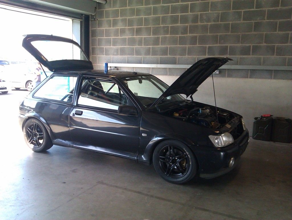

Done a trackday at Donington yesterday, early start at 4am but great weather and well worth it. Going through first part of Craner curves flat out in 4th was an experience. Fiesta ran great all day just need to sort out fitting a short as had a few missed gears, also had fitted some new yellow stuff pads, terrible till bedded in which took two sessions but after that were great.
Quick video of the morning session
Will

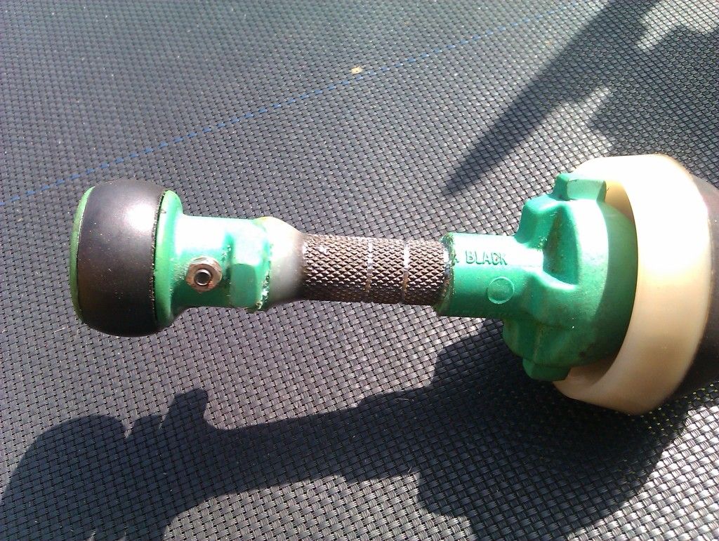

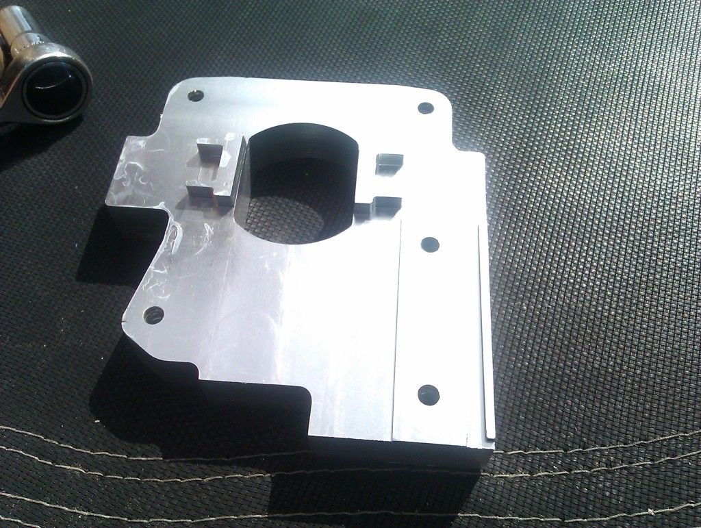

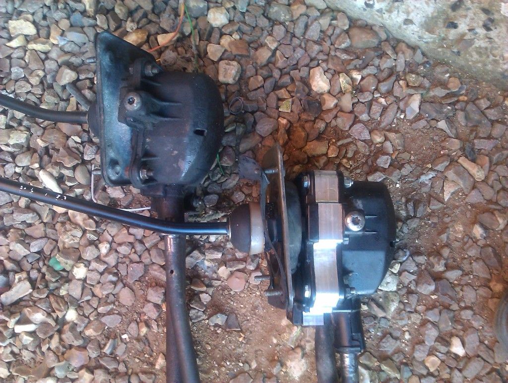

last time out the gear linkage was getting sloppy and difficult selecting 3rd gear swiftly, so decided to try fit a short shift mod. Got a escort mk4 modification kit as looks similar to Mk3 fiesta but not a straight forward replacement as the fiesta gear leaver is knurled at the bottom not splined like escort so lever pivot point could not easily be extended, had to split it araldite and bolt it back on. Previously done the 'zetec inside' linkage mod to but replaced that also with new 8mm spacer tubes and bolts and now loads better and no slack.
Previously the gear lever had a 160mm forward back movement 3rd to 4th, this is now reduced to approx 110mm. gear selection also feels so much more positive.

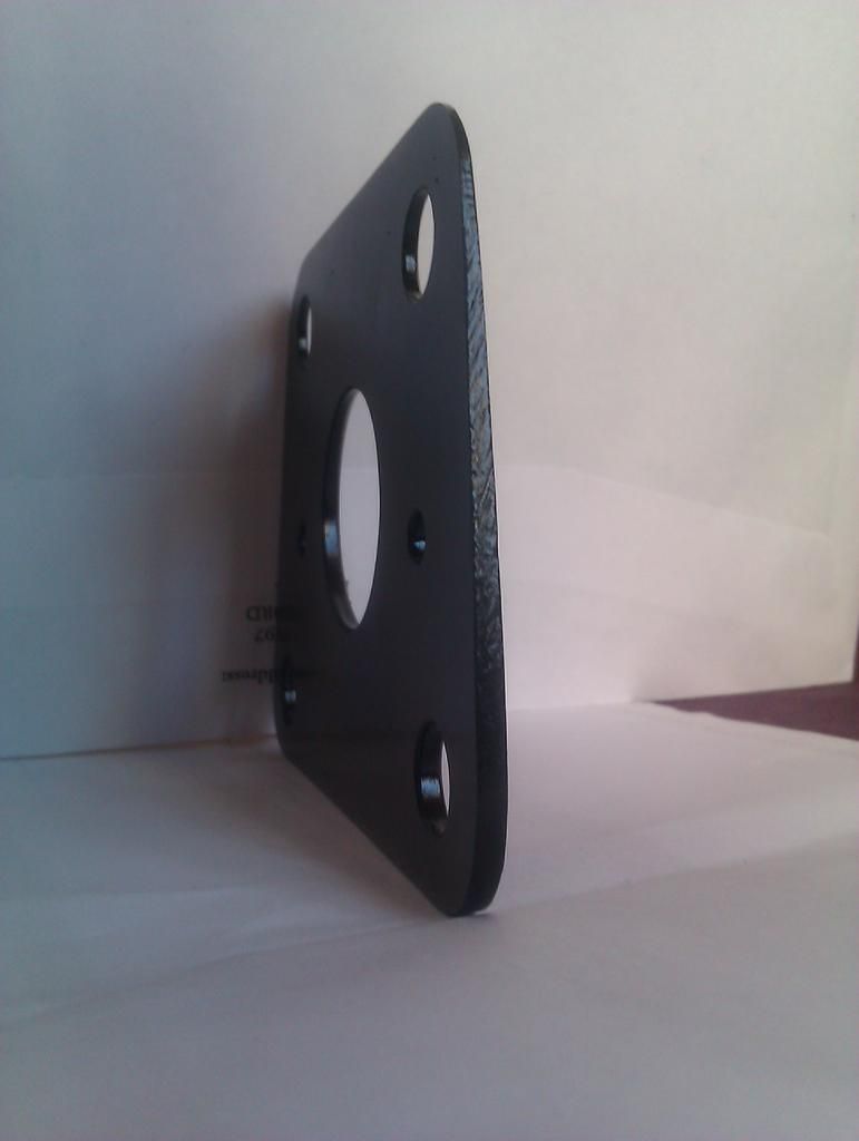

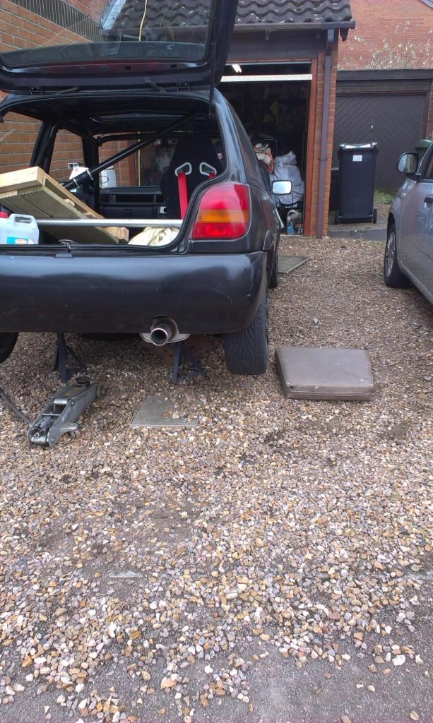

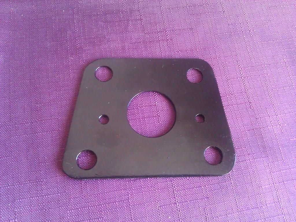

fiesta is all coming back together nearly finished welding up, also made some 1 degree rear camber shims to work better with the slicks.
made from 3mm plate hand grinded, filed and sanded, measured true and flat within 0.05mm

PostPosted: Mon Apr 15, 2013 8:48 pm
Nice work! Can't wait to see what they look like on the car :)
On my list is to make some hub spacers, but I haven't had the time/material to make them lol

Posts: 939
looks good what about the front wheels camber though?

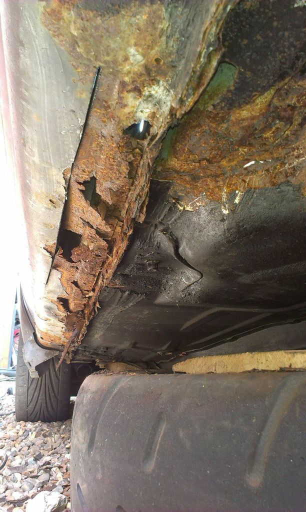

amazing how much rust the plastic XR2i skirts can cover, finally cut out the last of rust this weekend and now all welded up, arches sprayed, just got to fit sills and arches and all finished.

PostPosted: Mon May 06, 2013 6:55 pm
Posts: 428
Location: Laois, Ireland
ouch! time to take the welder out :D
camber shims look the bizz mate!
PostPosted: Mon May 06, 2013 10:59 pm
Posts: 530
Location: Kildare, Ireland
dreded rust, get her out :thumbsup:
PostPosted: Tue May 07, 2013 8:34 am
nice work!

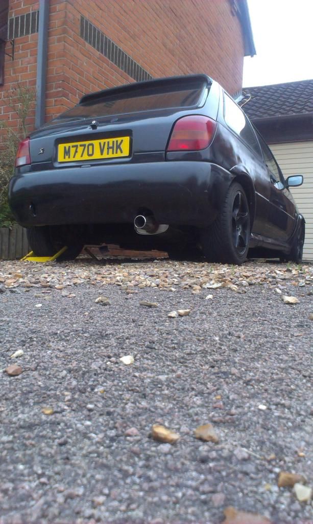

finally finished the Si today, put smaller fuel tank, sills and arches back on after standing on drive for 6 months started first time too. Can visually see the increased rear camber but not really captured in photos.
Now to book some trackdays but they seem to gone up to stupid prices this year, may be the last year for the fiesta, looking at buying another motorbike for trackdays or gearbox Kart again.
