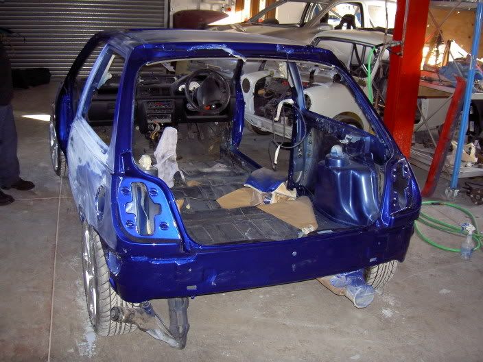

another bodyshop update

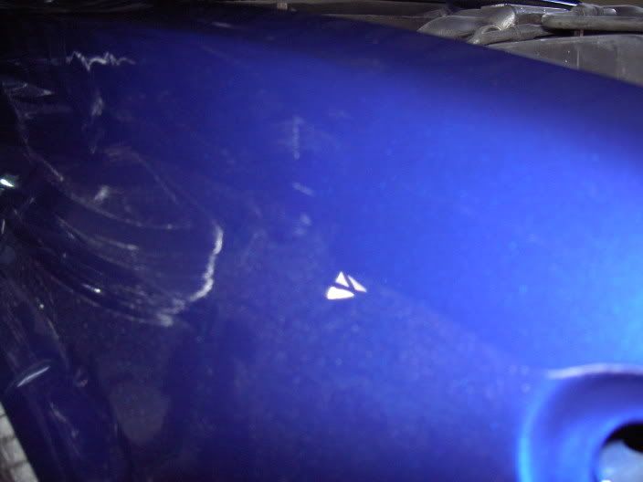

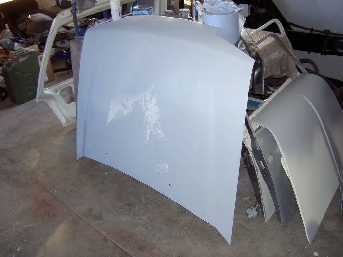

heres the bonnet in a better state, small repairs and the euro bad boy is done, quite happy with how this turned out, must admit had second thoughts when it had only just been welded,

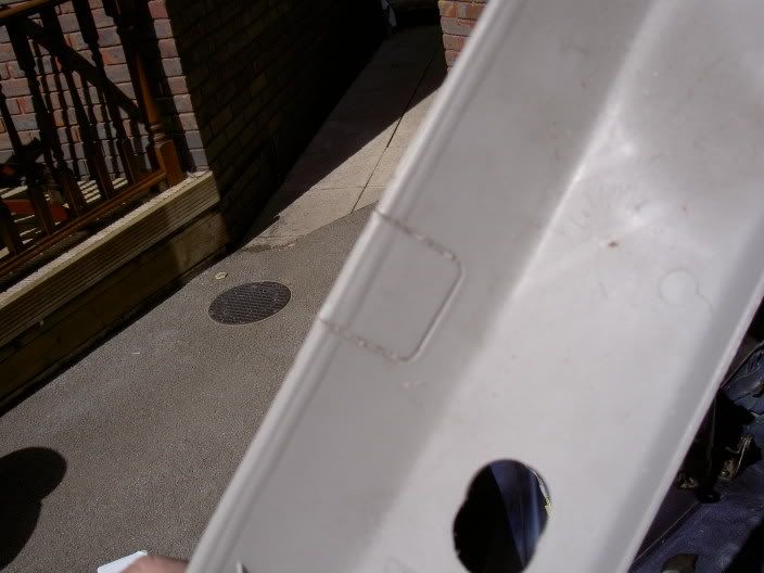

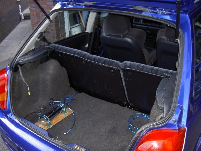

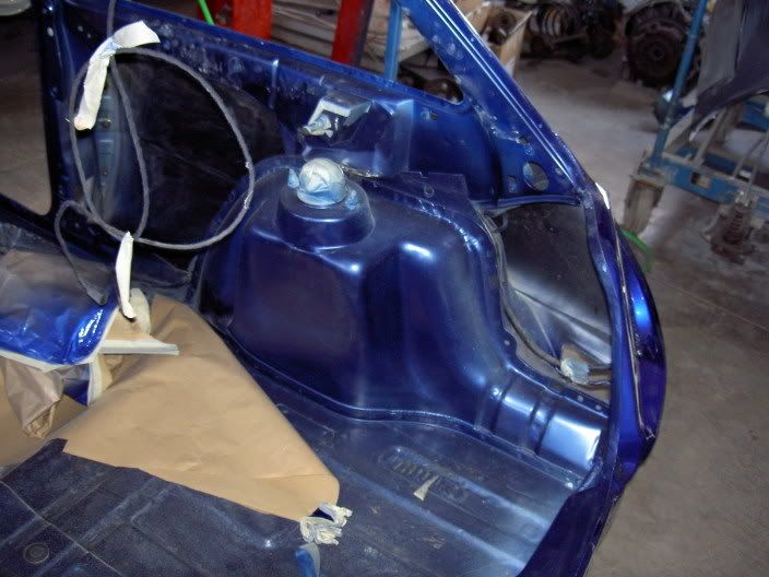

this is the rear strut in the boot, had a slight ripple from where something in the boot had smacked it hard from a previous owner,
all sorted now tho

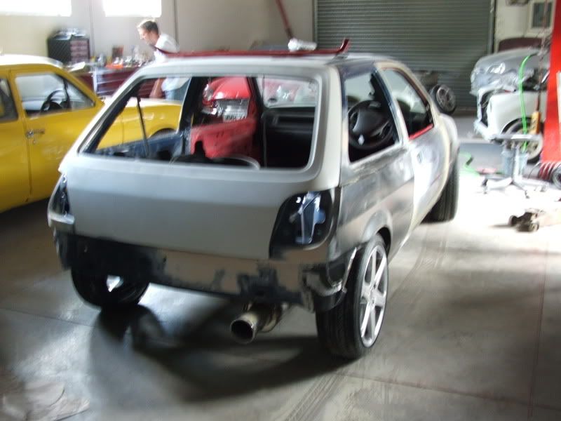

heres the back panel trimmed like i mentioned in the last update,
looks alot better, mentioned reasons for this in the last update i think, will have to check lol

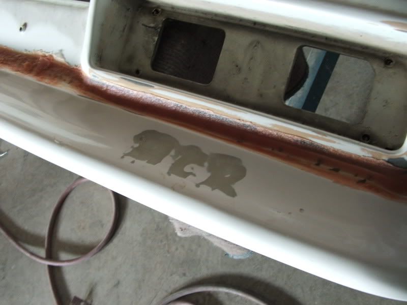

heres the mcr logo being sanded back and smoothed over

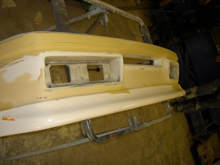

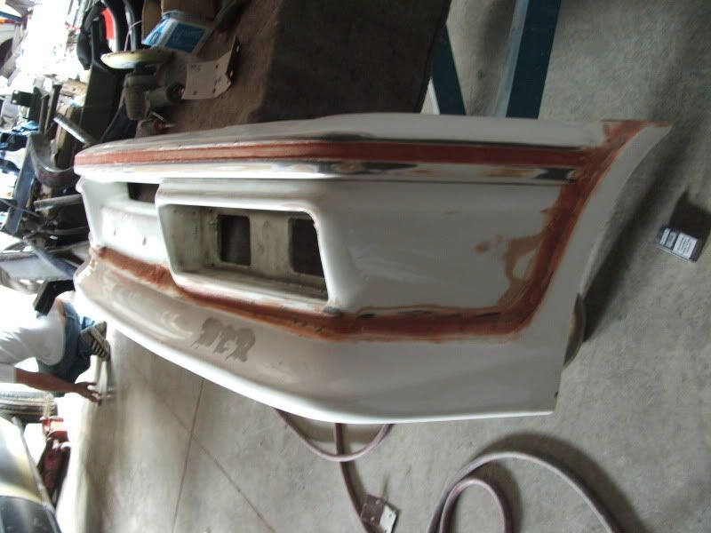

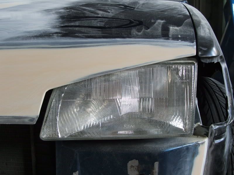

firstly my bumper when i got up there, having some fresh filler on there, but can really see the shape coming now and workmanship being put into it
then it was rubbed down after looking around the car while i was there

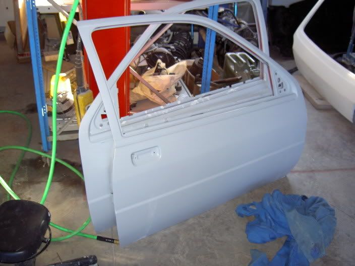

panels in primer and flatted back (felt like glass fair play)

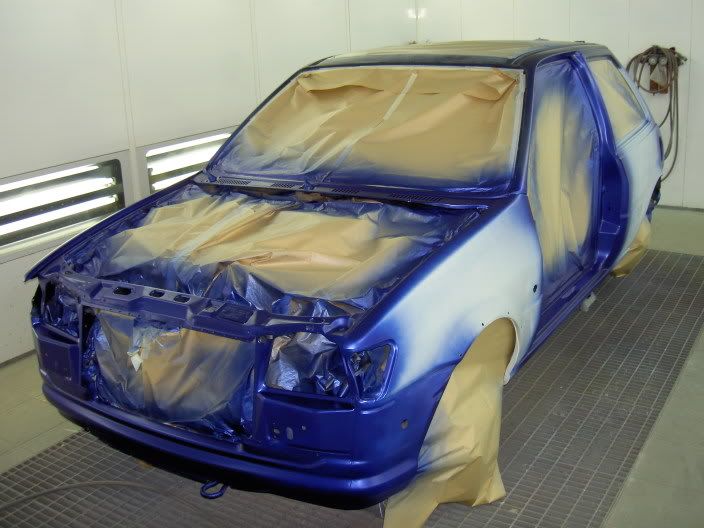

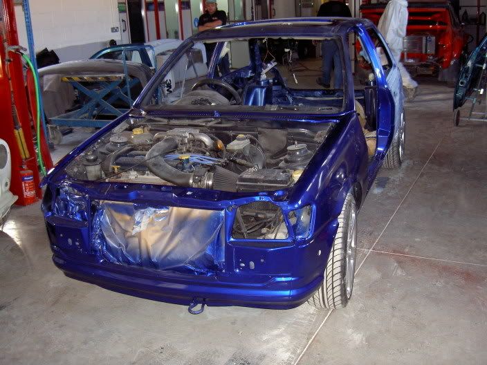

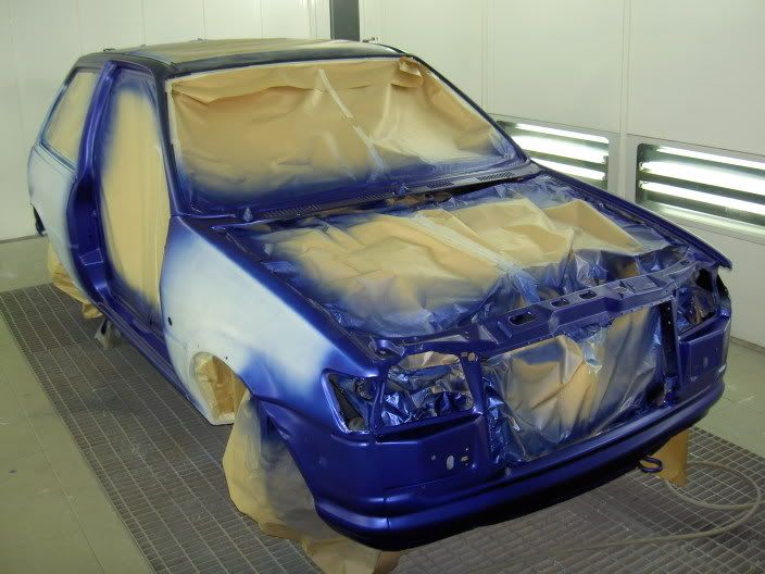

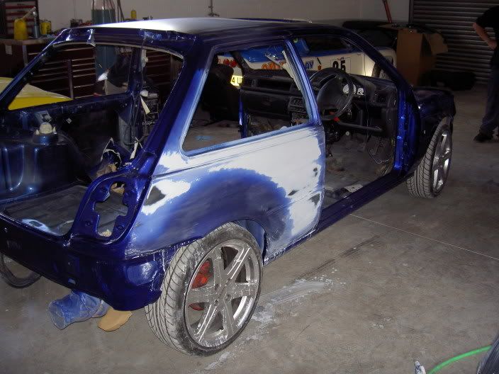

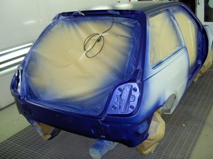

here she is in the spray booth, with wheels off on axel stands
she's had some primer all over and sprayed inside the doors and boot,
its only had some base sprayed on it, so this is'nt how the colour will look when finished

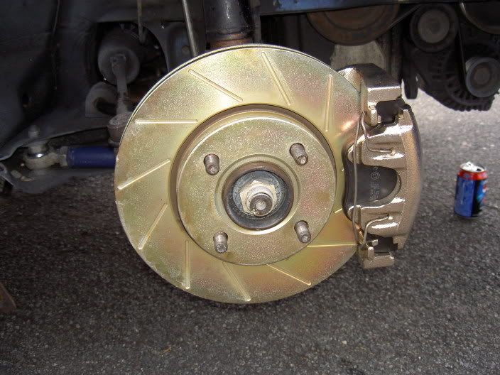

had my grooved disc's zinc cadium plated,
basically the parts which wont touch the brake pads wont rust,
really happy with how they look,

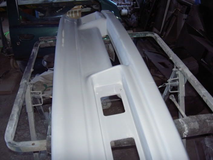

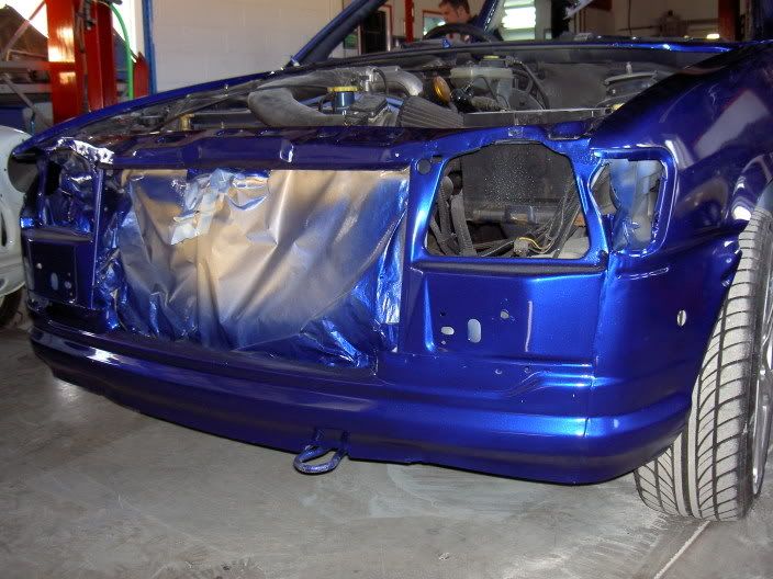

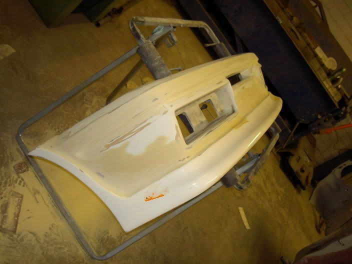

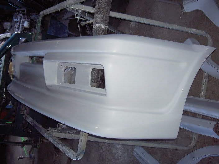

heres the bumper finished and in primer, really happy with the outcome, the workmanship is awesome,

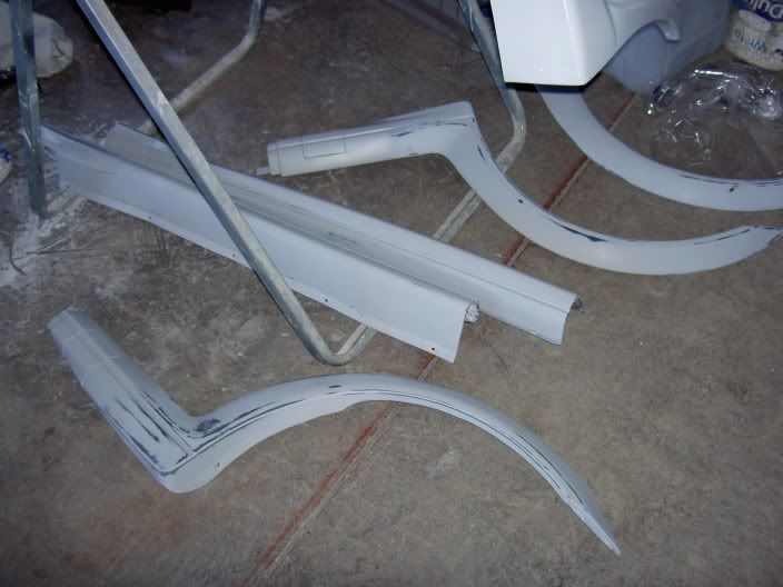

heres a random pic of the sideskirts and arches which have been rubbed down and sprayed in primer, the jacking point covers have been glued in so they wont be going anywhere lol,
was originally going to have them smoothed in, but time has gone on and it would make a things awkward as they would have be smoothed once on the car because the kit flex's alot/maybe crack,
also the boys wanted new paint under the kit,
so that explains why only the front wing has been sprayed, because i decided to forget the idea, on the plus side the colour is bloody lovely and i could'nt be more pleased as these are only rough coats of paint,

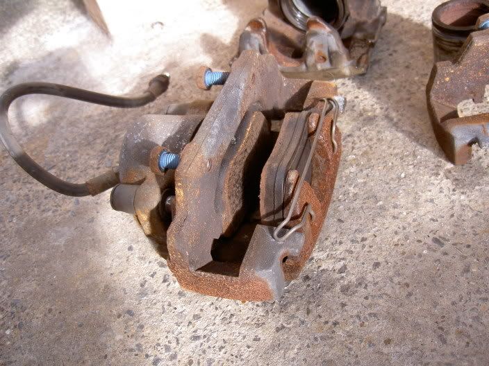

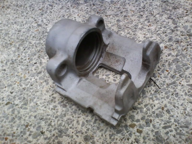

heres my brake calipers from an escort cosworth 4x4,
these are the same calipers that came on the sierra 4x4 aswell
unlike the 2wd sierra cosworth which has 4pot caliper but they dont fit apparently on my fez
although the escort/sierra 4x4 cossie calipers are only single pots, the pistons are larger than normal,
obviously being able to stop a standard 200+bhp cossie

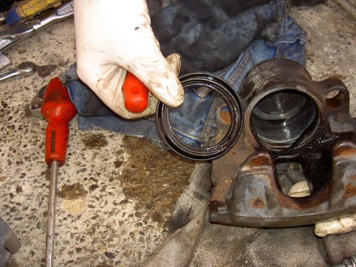

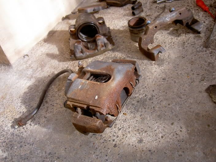

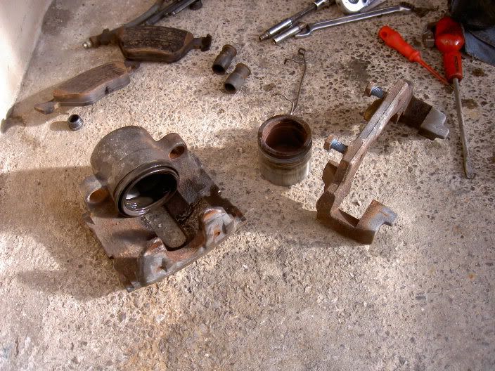

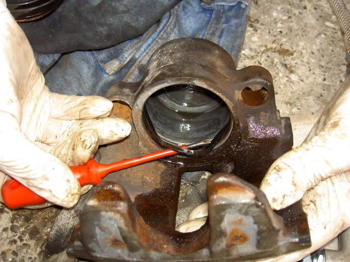

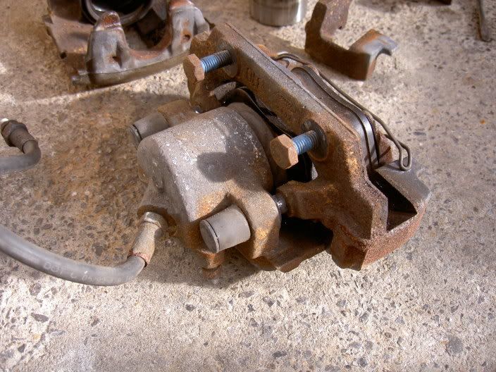

heres a few pics of how mine are currently looking before stripping them down for a refurb
in this pic you can see i've got the piston out and carrier off,
heres the dust seal off
heres the piston seal, all coming off though
looking to have the calipers shot blast back to a nice clean metal, then i'll have the calipers plated and then put back together with new seals etc, hopefully looking alot better
well update on the bodshop side of things aswell,
its all painted except for the door handles, mirrors and spoiler
side skirts and arches are on aswell,
currently being flatted back and polished
the finish from the gun is amazing and i'm suprised their even flatting and polishing it at all,
theres no bits in the paint and feels amazing, also no orange peely effect,
but nevermind all adds to the big respect i have for the bodyshop

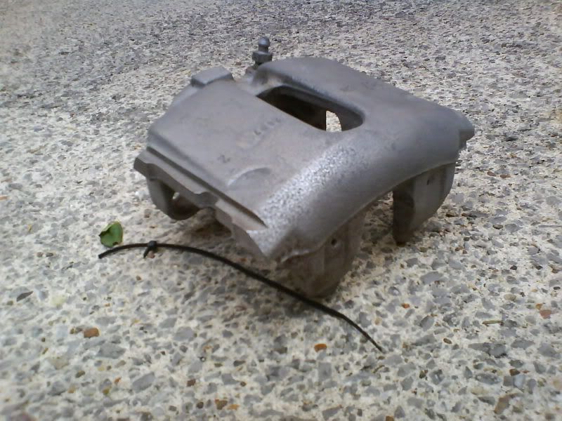

small update, had my calipers back from being shot blast,
as you can see a massive difference,
no rust or dirt and grime lol
few pics below to show the difference,

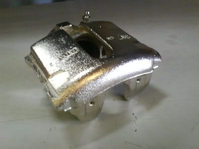

dropped them off to the platers today aswell, so should be having them back on friday
their being nickle plated, should have a nice finish to them
Image.

got my brake calipers and carriers back from the platers,
really happy with the result
only a quick pic from the camera fone at the mo, but you get the idea

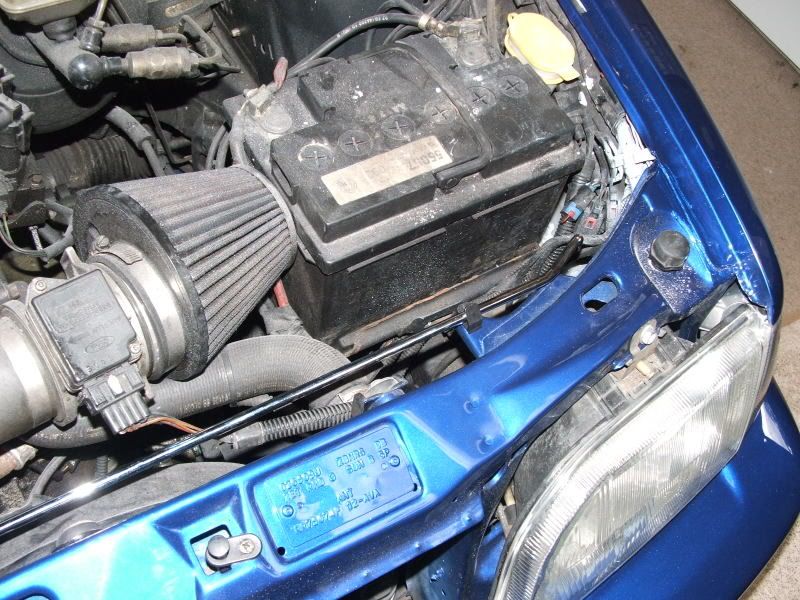

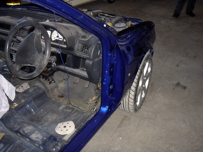

firstly the engine looking really manky, but also old bonnet stay
a new chrome item to update, my first bit of bling for the engine

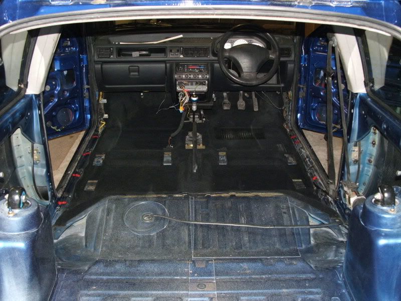

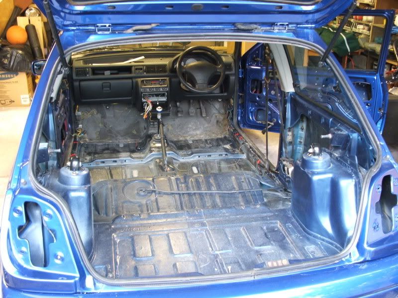

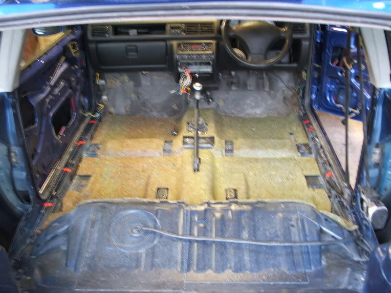

nice bare interior :bad:
new insulation for under the carpet as the old one was wrecked after an accident with oil in the rear footwell,
ah thats better, fresh carpet lol, steam cleaned it to get the oil out, came out really good :D

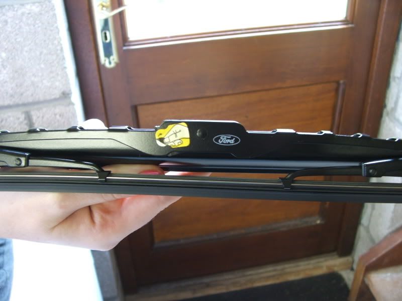

new ford wipers to go with the new windscreen

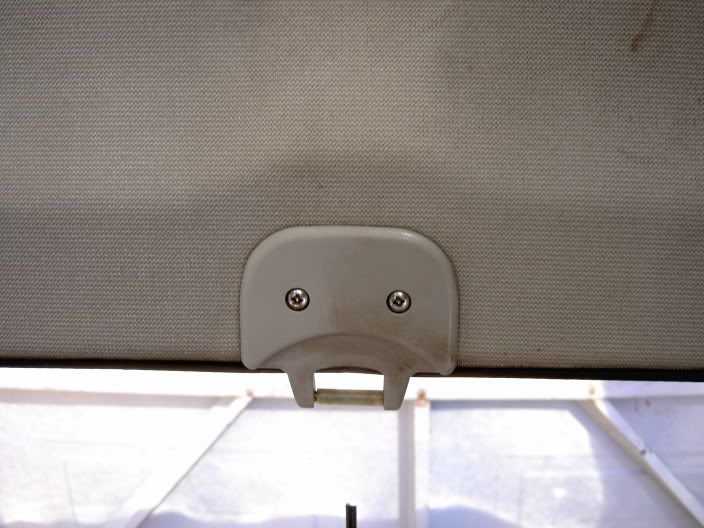

got the sunroof out for a good clean, full of dust etc

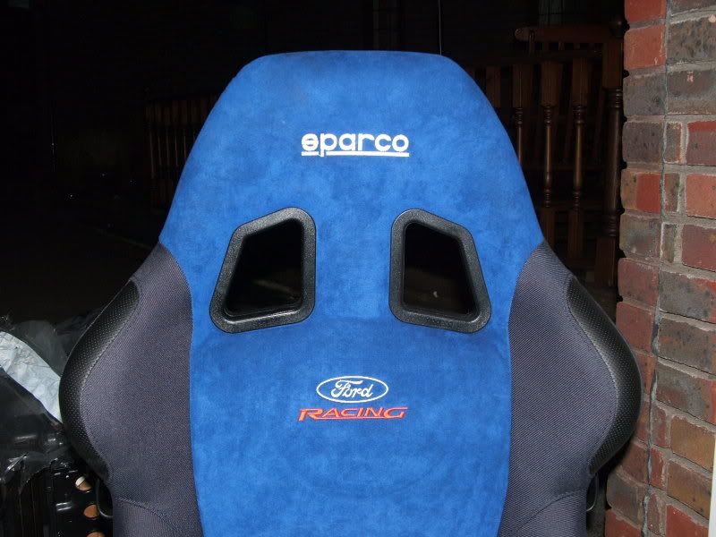

sneek pic of the new seats to be going in

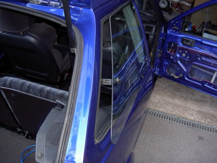

the fiesta turbo rear quarter opening windows, really love these,
big improvement on the fixed rear window with big chunky seals

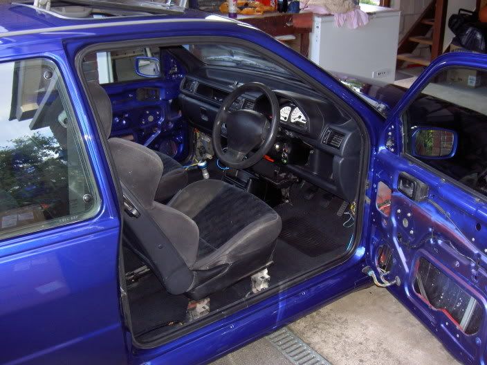

the interior starting to look normal again but a bit cleaner aswell

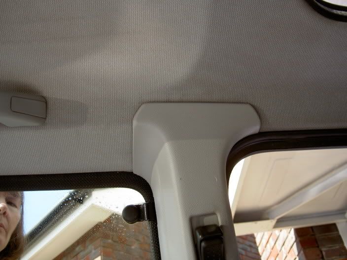

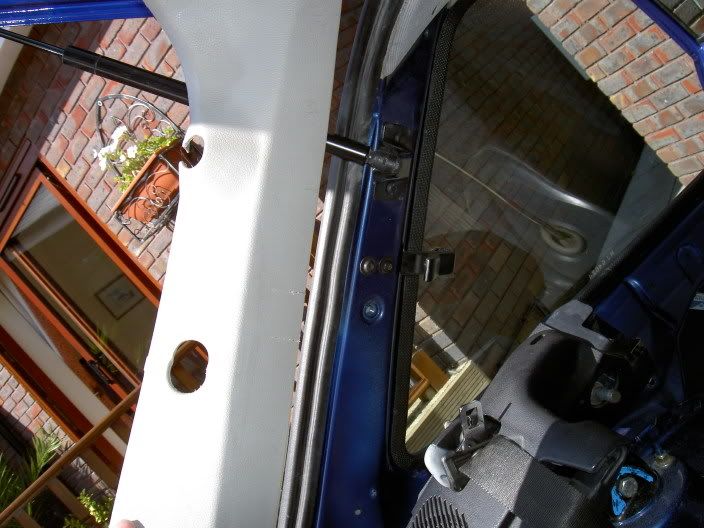

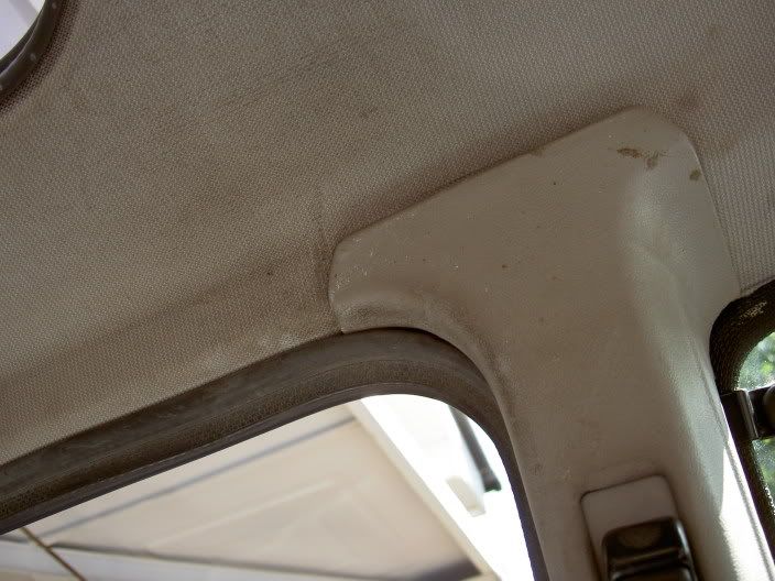

heres a pic the c pillar trim, obviously with the rear opening windows in the hinges would stop this going on,
but on the back of it, was how to cut it to give the hinges room,
heres the back of it

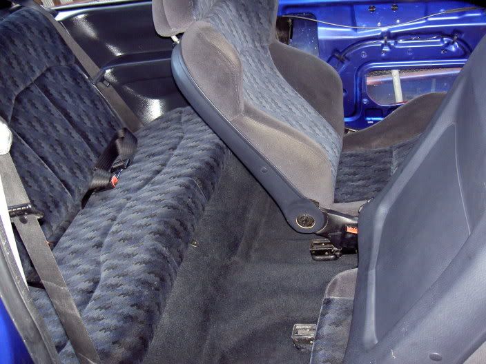

heres the seats back in for the mot, then i'll put the new front seats in after
big thanks to my mum for helping with the cleaning as i was putting the interior back in
:D :bb:

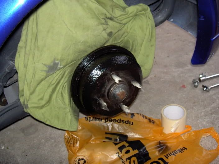

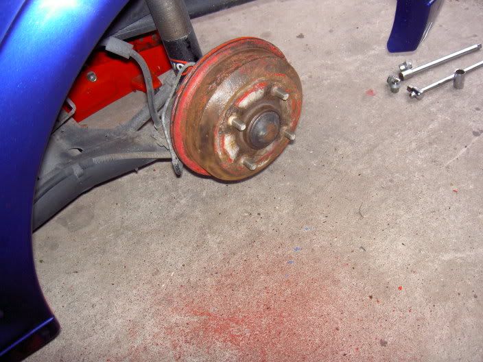

ever since i've had the car, the rear drums were badly painted red,
something i've been meaning to sort for some time,
so took the wheels off and had a wire brush on a drill,
couple of mins later they looked like this
then with a spray of some black paint as in pic below,
(notice the cossie on the paint can and my new cossie wheels in the backround lmao)
the end result, alot more tidy, subtle and does'nt stand out,
job done

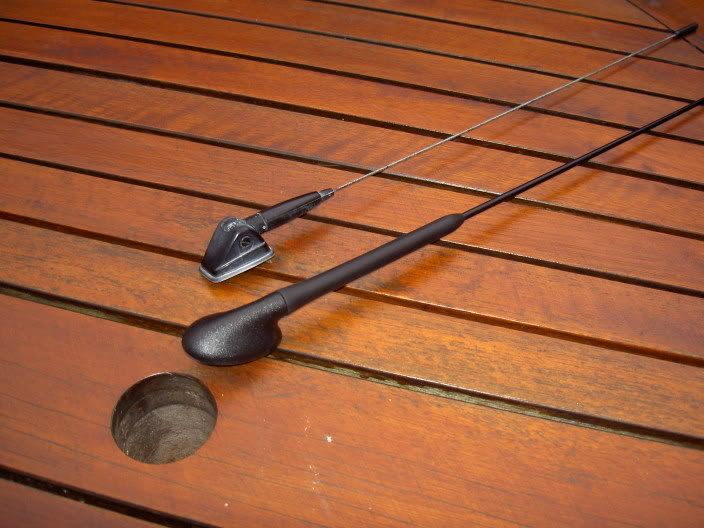

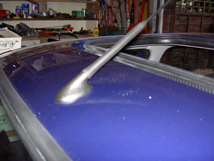

the next thing was the aerial, looked very dated etc and did'nt go with the rest of the car's styling,
so keeping with the ford theme, i bought one from a mk5 fiesta
in the pic below shows comparison of the old one on the left and new one on the right
and on the car

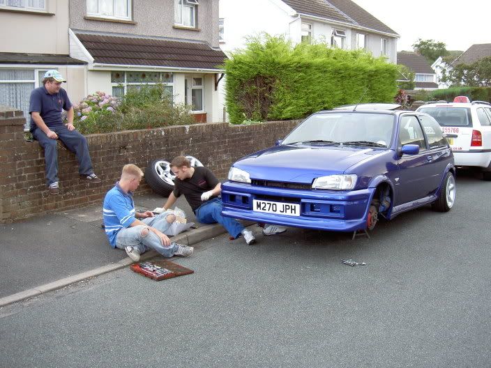

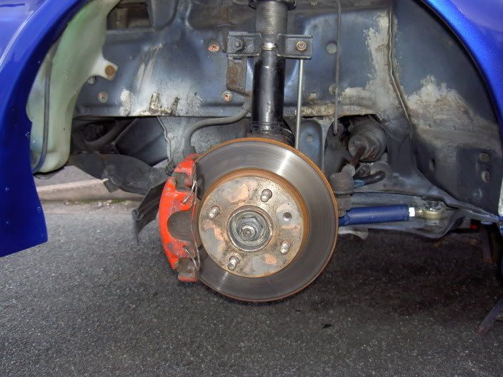

the brakes were done after the mot and tax,
few of the lads from bridgend massive came over for assistance
or actually did it for me lol
jacked up, wheels off, boys get started
dan the man getting stuck in! lol

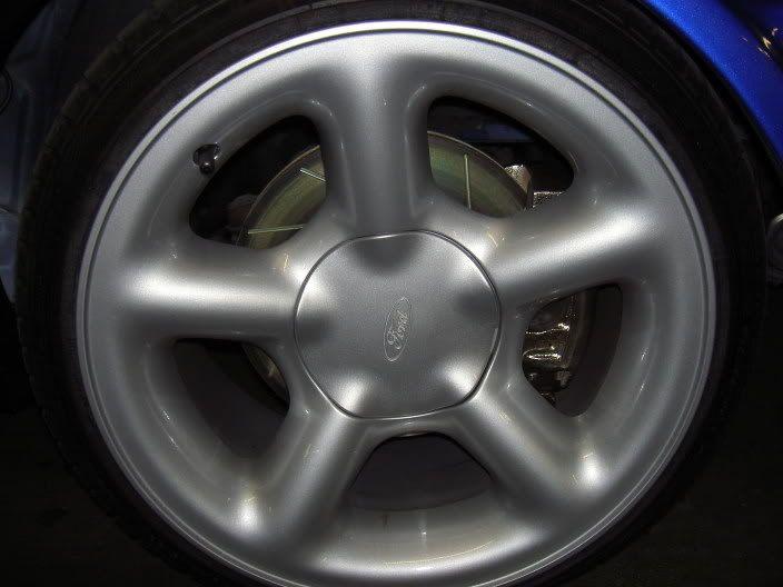

heres the bad part, only now we realised i had the wrong disc's,
cossie disc's are 278mm, these were sadly 260mm
still better than my 240mm disc's currently on the car,
so will be abusing the lad who sold my the brake setup including these wrong disc's
a pic to show the small difference, still better tho
the brakes before
the brakes after
you can see how the disc's are too small for the calipers, but will do for now

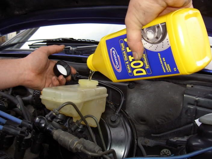

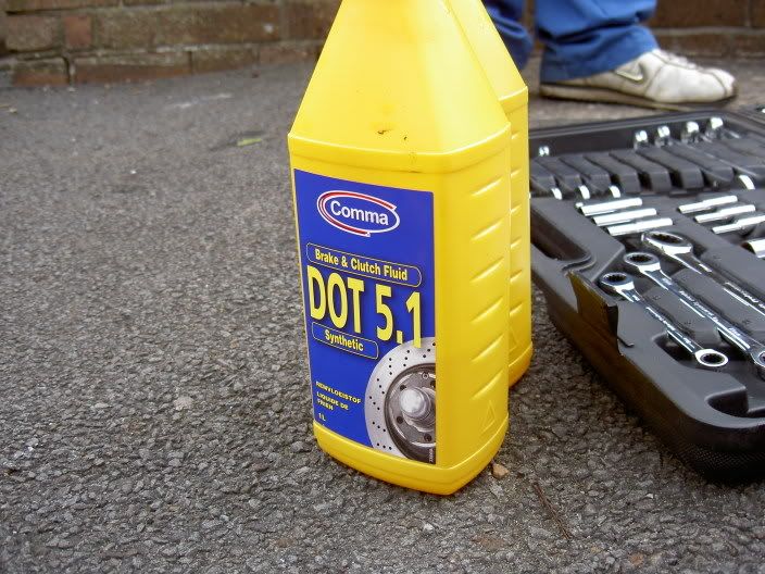

next up drain the old brake fluid out, it was blacker than black,
when its supposed to be a "wee wee" colour as
told by mr wolze (diff forum) lol
new 5.1 brake fluid as provided by mates dinky dave and wolze (diff forum)
hmmm new fluid
all the brake fluid was bleed completely until it was only the new 5.1 fluid inside,
a quick shot to show the brakes behind the wheels, even tho their the wrong disc's,
i'm still happy with the improvement visually, also still much better physically braking
cant wait to see the difference with the proper disc's

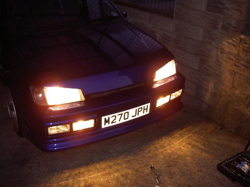

by the time we finished it just started to lash it down, so cant show the pics the new lights on the front aswell.

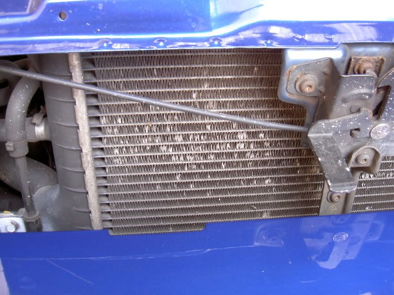

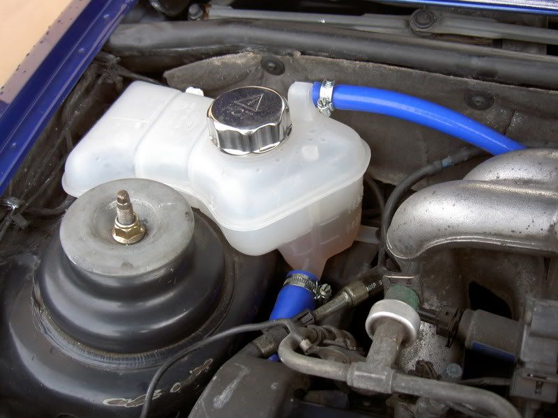

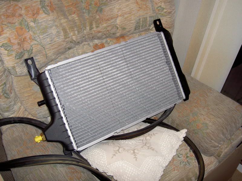

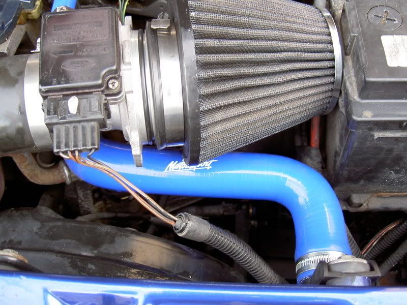

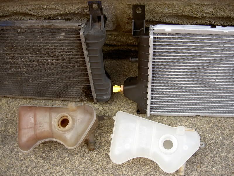

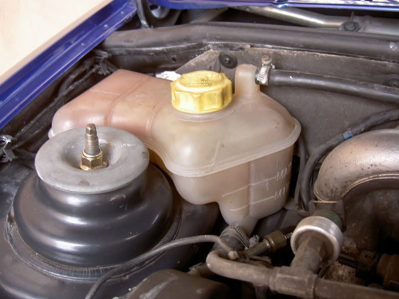

also very soon i should have some silicone hoses etc for the engine bay,
so got two bits ready,

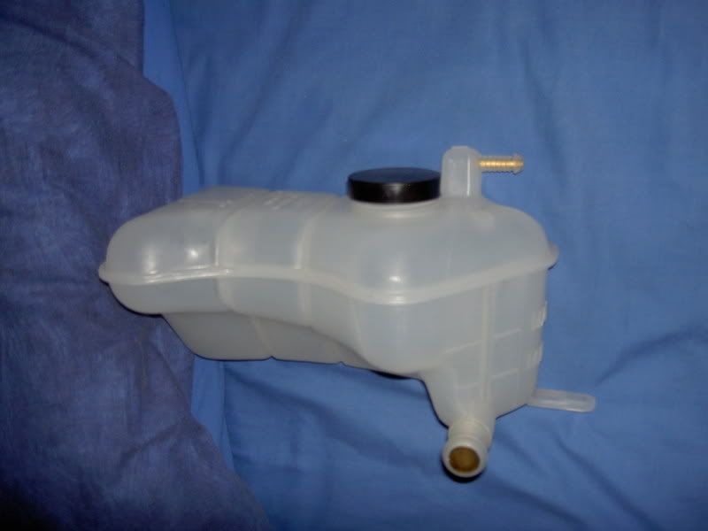

my nice new radiator and header tank

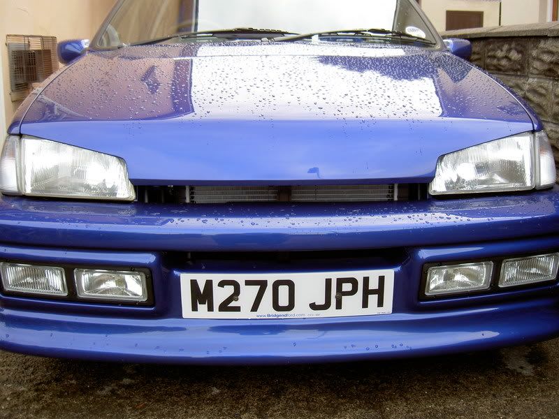

i'll have proper day light pics soon to show them better,
but for now,
you'll notice i've put the clear rears on, this is because my german rear lights had indicators which shined white, so waiting for some silvatech indicator bulbs
also changed all the bulbs and cleaned all the connections and got my lights on the front bumper working,
was only expecting the fogs to work as i thought the loom was different to the xr2i/frst which also have spot or driving lamps,
but much to my shock, they work, so i'm really chuffed

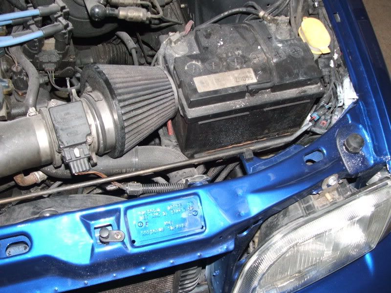

heres how my engine bay has looked for sometime, dirty etc
so with a few chrome bits,new hearder tank, rad and hoses
thought i'd make a start

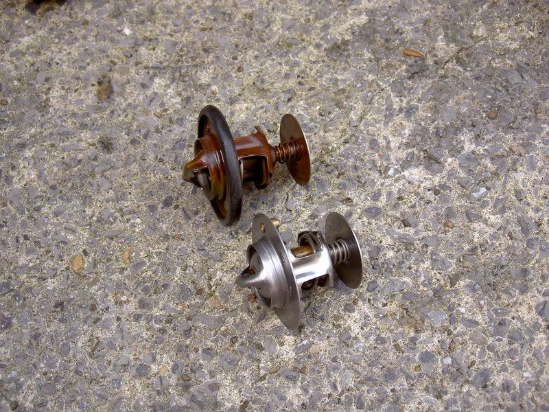

out with the old rad and header tank,
shocking the difference compared to the new
changed the thermo stat aswell for good measure
one of the new hoses on
the new header tank with chrome cap and new hoses connected
the overall engine bay, much happier with the new rad
still loads to change and do, like colour coded cam cover etc
but i'm happy with the changes so far
you can even see the rad with the bonnet closed, so i'm happier :D

also got some other pics,
decided i'd try some different wheels for a change
diamond cut RS 7's
bit dark in the first two
also got some seat covers to help look after the puma racing seats
Image.
