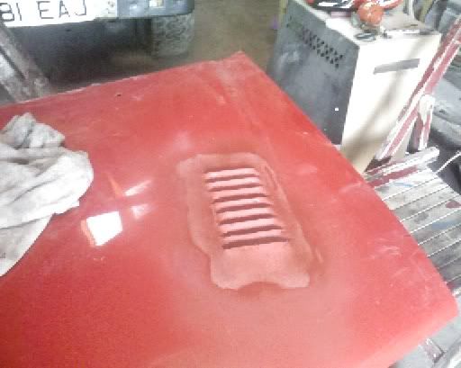

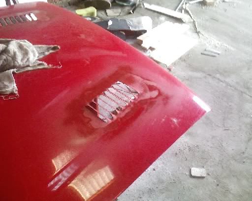

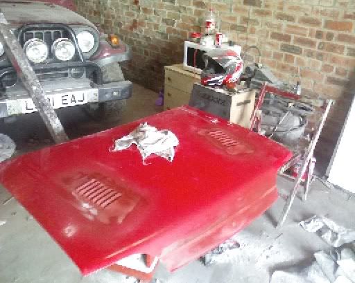

Had a go at some bonnet vents at the weekend. still need another skim with filler and abit more shapping then hopefully finished then save up for some paint. they have got a spray with primer to stop the rust for the minute.
Any comments welcome like normal :)

They look not bad mate, how did you do them?

the longest part so far was marking out where to cut so it was all level. then got the angle grinder and cut 8 line a inch apart. then bent the metal into position with pliers and mole grips. now am just fillering and sanding.

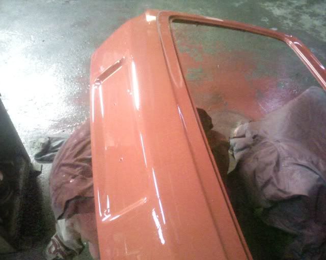

Got a new boot from scrap yard. £15 which is cheap i think. Strpped it down filed in lock and wiper holes and gave it a spray. Used the spray gun and compressor for the first time. got a few runs but should buff out. heres a photo of the area i have filled looks good i think.
