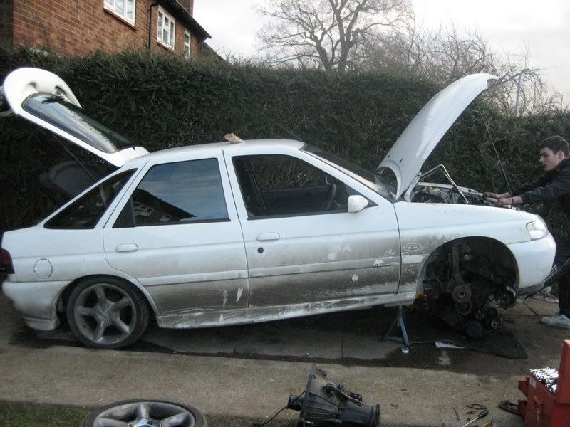

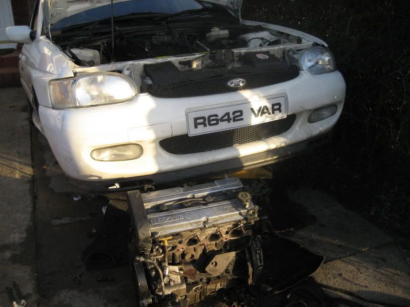

Not much of an update, but ive now got an engine.

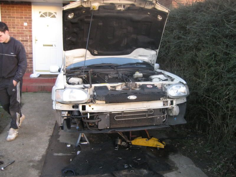

Got it from a mates Escort which he is breaking, managed to get it out in a couple of hours today.
Here it is at the beginning
The car that its come out of, with the engine out an on the floor
My new engine
A sad looking Escort :(
So now the work can start, need to source a few more bits so it wont be ready for a while yet but at least its moving along.

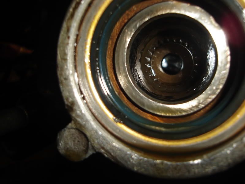

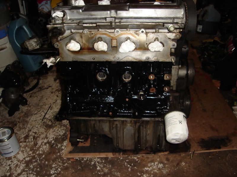

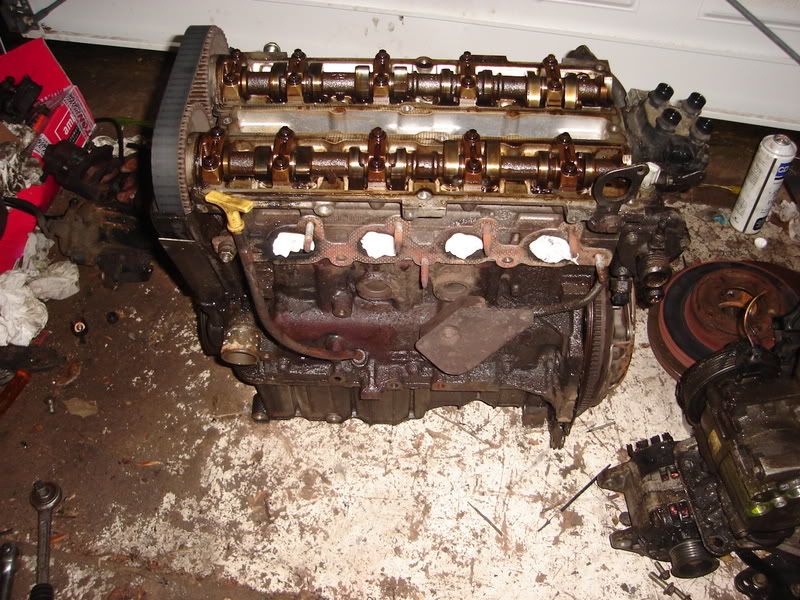

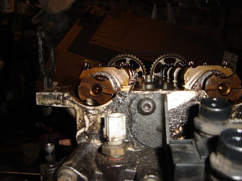

Another small update, ive not been doing much with it lately. The engine wasnt running right in my mates Escort so after id stripped off all the Escort shit from it i thought id see if i could find the cause. I took a look at the timing and it turned out the exhaust cam was about two nothes out of time :aaah: So i sorted that out then painted the block since it was a bit rusty and dirty.

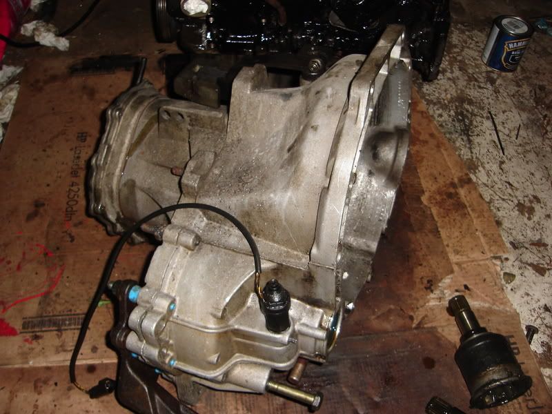

Also got myself an S2 LSD gearbox this weekend, so i fitted all the mountings, release bearing, arm, inner CV joints etc to it from the Si box
