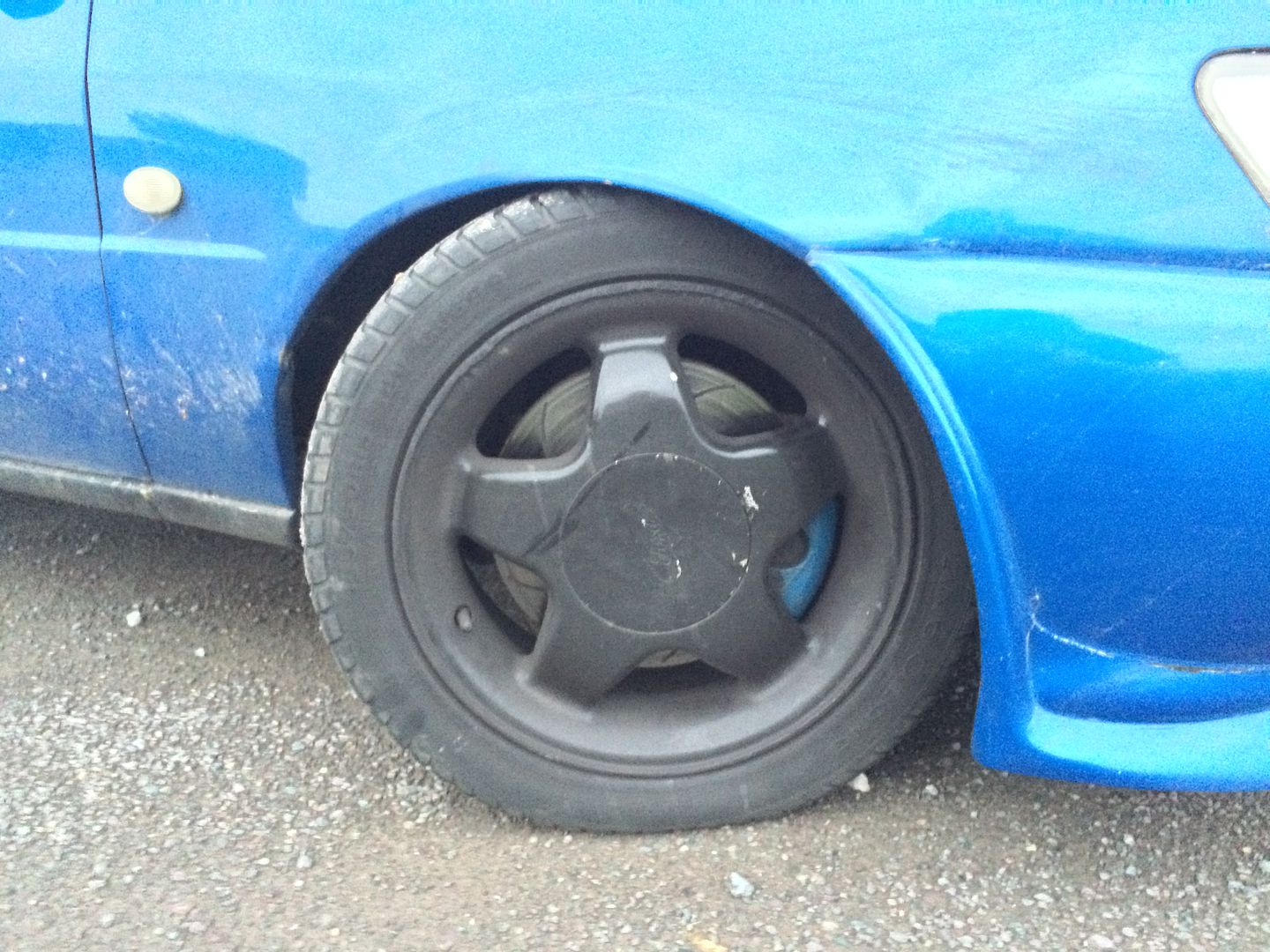

This was before the new tires, wheels look a lot better with 45 profile tires now. Just need to sort out the water ingress problem, any ideas at all? Drain holes in the floorpan are clear, door seals dont weep, sunroof looks good just seems to be right in the centre of the footwell front and rear every time it rains :/

Also got another pic with the new tires on, sits hell of a lot better now on these.

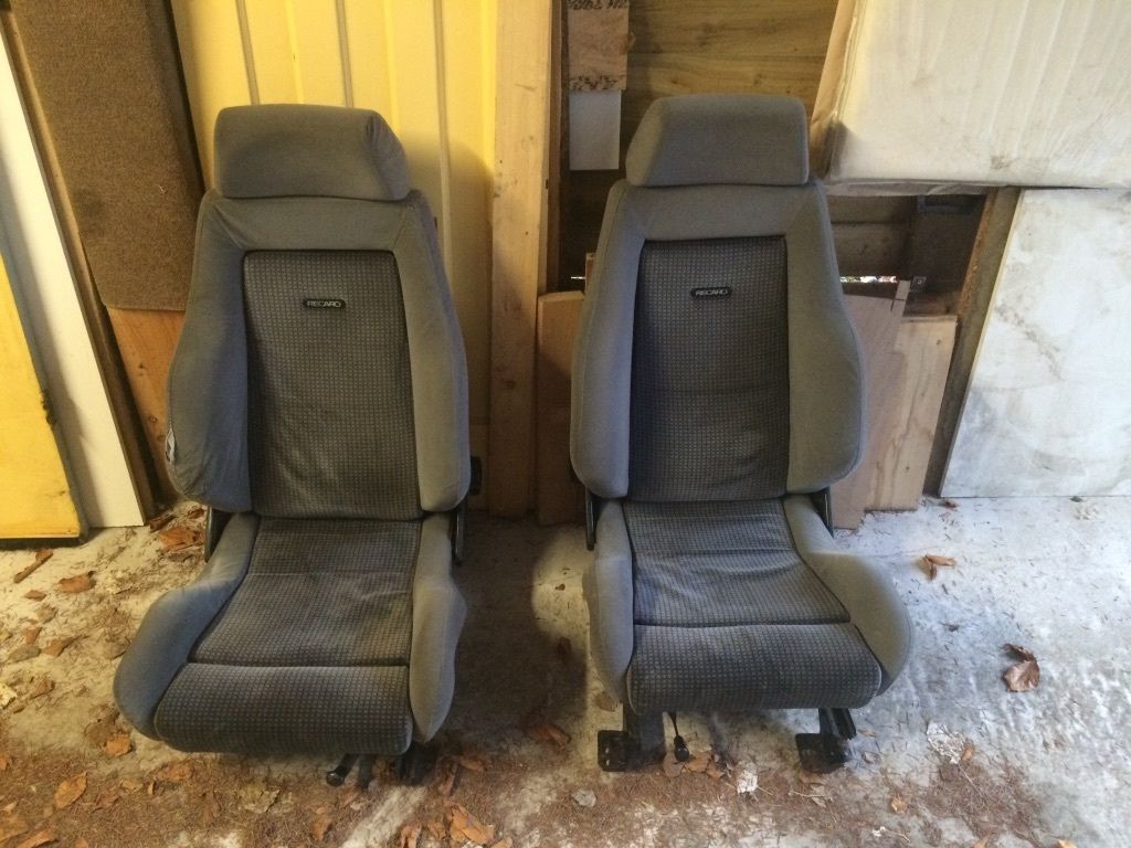

Think they are straight swap sean, got new brake hoses to go with it, the set up on the MK3 looks a bit different to the MK5 but I'll figure it out. Going to be fitting the beam next Friday. Also, think I've sourced the water ingress issue, seems to be coming in through the blower motor seal and tracking in. Don't know if this is also the source for the water build up in rear footwell but once it's sealed up I'll soon see. Also, thought I'd treat myself to an early Christmas present so I got these today, absolutely love them, had two sets in the past and they are mint seats! Best set I've owned, only small rip scuff on the front and a little rip on the back!

Tried getting the recaros in today, Still using the 3.5 runners off the wingbacks but the seats don't bolt in, its like the metal base of the seat isn't wide enough? Any ideas, did yours go right in Sean?

Yeah interior is totally stripped, sealed up heater blower motor cause seal was perished, got some new recaros now, swapping my escort ones for frst ones tonight so the fiesta ones should go straight in. Problem with the escort seats is that the base itself is too narrow for the runner but the fiesta ones should be the right size cause they come from a mk3
