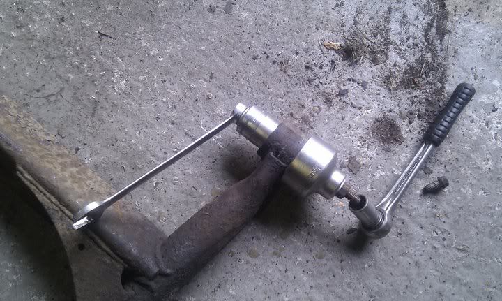

Yeah I dunno which ones it is but i've heard setting them on fire is the pikey way.
Really stiffens it all up polying everything, its something i've wanted to do for a while but I just know i'd never get round to getting someone to fit them for me.
PostPosted: Mon Aug 22, 2011 12:16 am
Posts: 741
Location: Cheshire
nope im not setting them on fire it makes the job harder in the end as you have to remove the rear beam completely from the car to be safe where as you just press them out you can do it by letting it off the mountings and supporting it with blocks or a jack. either way hopfully i will be doing it at work.
To rebuild?
PostPosted: Mon Aug 22, 2011 12:34 am
:lol: As long as you've got the right tools to do it then will be fine I bet. I've never done it i've just heard thats how some people do it. i'd assume they take the bits off first ha.
PostPosted: Mon Aug 22, 2011 12:43 am
mines fully pulied, but im put off now, been over a year but its so stiff!
PostPosted: Mon Aug 22, 2011 12:50 am
heres a good way of doing it
(not mine btw)
 Post subject: rado red zs
PostPosted: Fri Aug 26, 2011 9:08 pm
Posts: 741
Location: Cheshire
right i have decided that the rear bushes are totally screwed as i can rock the back of the back of the car side to side while the wheels still stay still. best way of describing it is that if i grab the top of the back wheel and shake it the body wobbles from side to side but the wheels stay still.
must say somthing for how bad my si was as this feels much more stable even like this.
To rebuild?
PostPosted: Sat Aug 27, 2011 12:29 am
Deffo fit polybushes mate, and they arnt that hard to press out, done it twice myself before now :thumbsup:
PostPosted: Sat Aug 27, 2011 12:37 am
Posts: 741
Location: Cheshire
where sells them at a decent price then? is it any different to fitting normal bushes?
To rebuild?
PostPosted: Sat Aug 27, 2011 12:42 am
When fitting them to the rear beam, its actually easier than standard ones as polybushes only have one lip rather than two so just push straight in with the grease they supply :thumbsup:
Floflex are cheaper, or proflex, and powerflex are the most expensive and best quality
