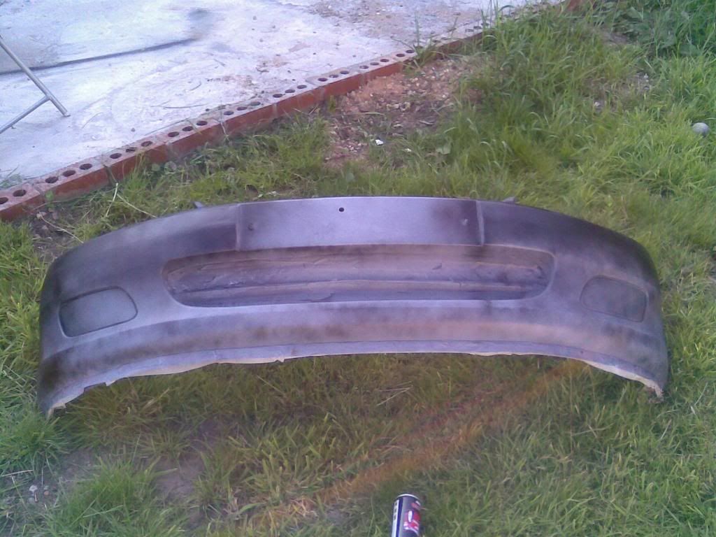

Well time two do a update: I went to the scrap yard to get my c/c bumpers after being mest around by one i went to a nother one and they had the bumpers so i got then then i taken the strips out to start fiberglassing the bumper hear are some pics not the best.
this one is sweet hardly a mark on it

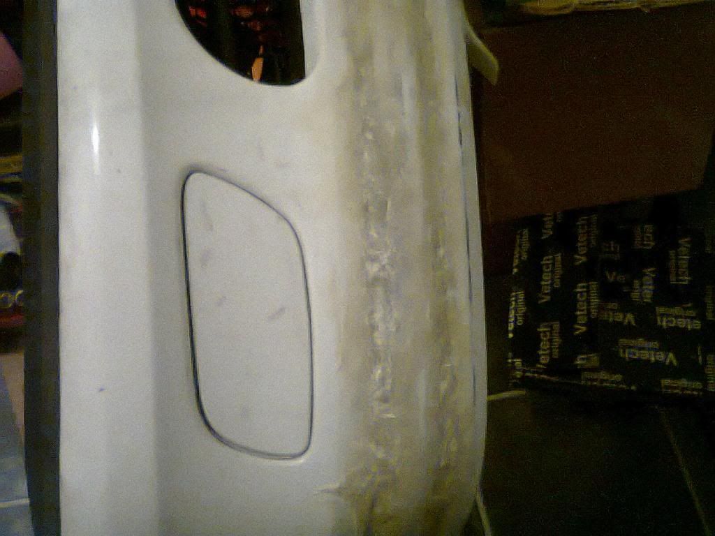

just sanded down the top bit needs a bit more fiberglass then filler

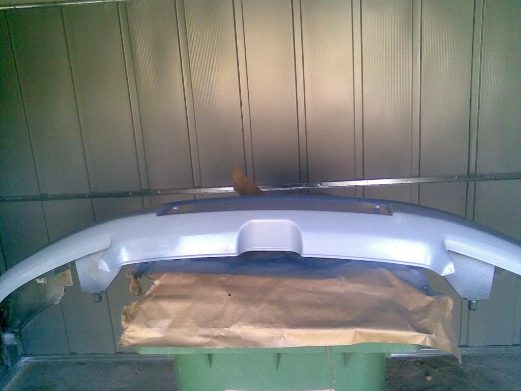

Well i have done a bit more to the bumper will do the back one tomoz when this one is done
Any way pics

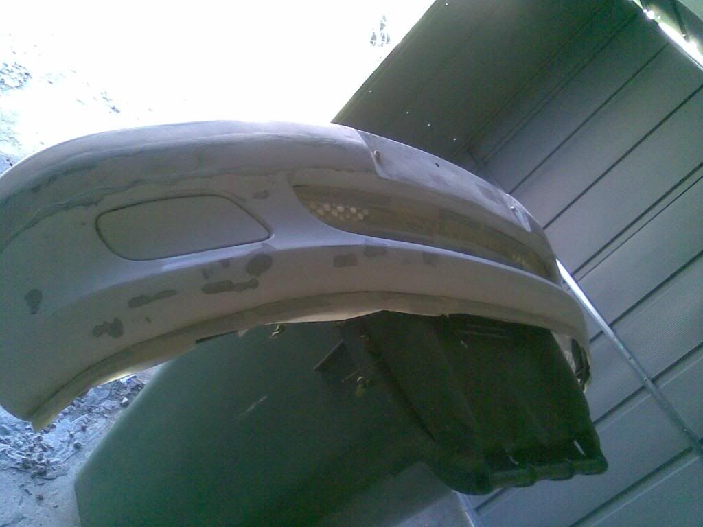

1st coat / wet and dry
2nd coat
Guide coat to see where the high and low points are

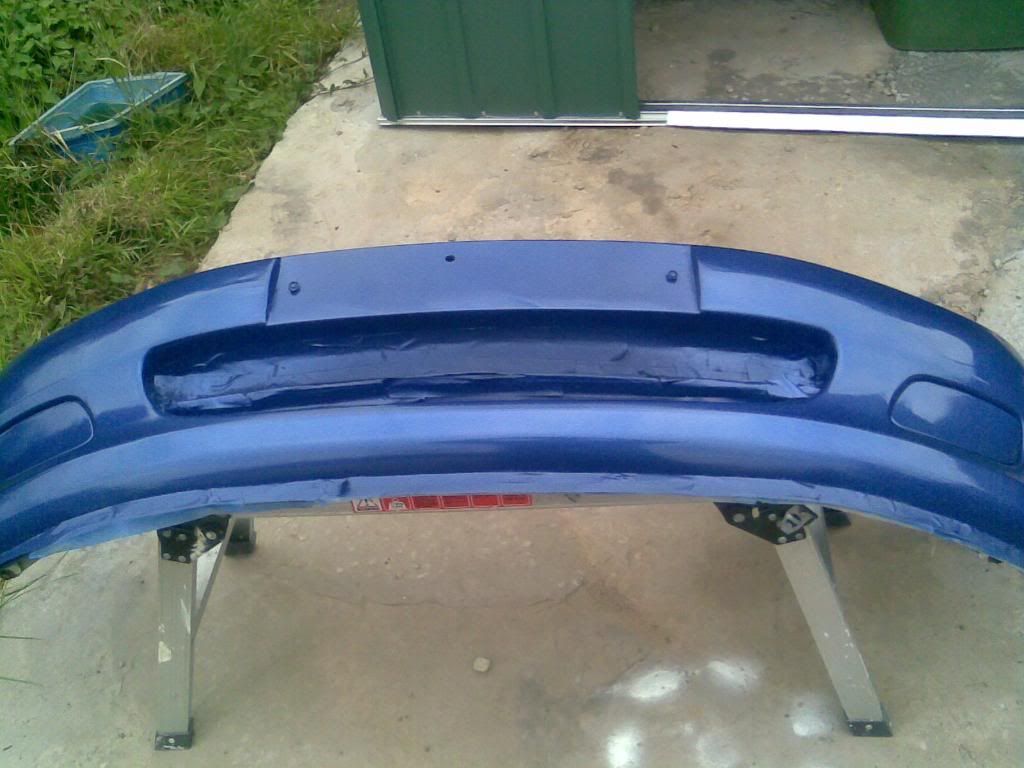

well the bumper is done
it matches up to the car very well
painted

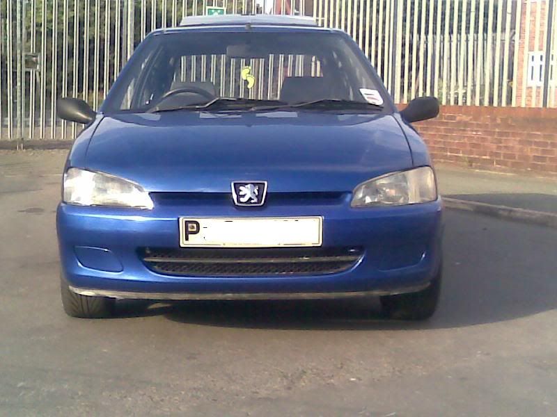

stript car for the bumper
on the car
what do you think rob

nice, looks really smart!

That looks impressive, great without them strips, good work mate.
