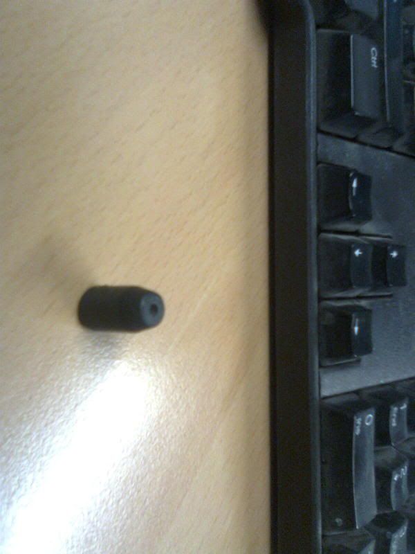

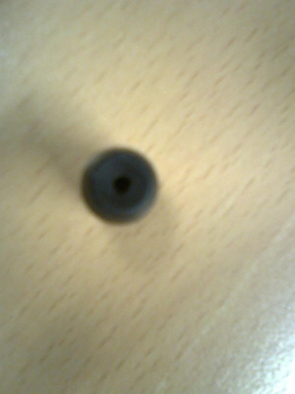

So while doing that I found this little fella inside a small pipe which runs from the side of the stat to the top of the header tank....
I could not understand why this was inside the pipe, so asumed it was some kind of one way valve, but it isnt!
And on all the other ford dervs I have had, I have never had this little thing inside the pipe.
It seems silly as it would restrict water flow... but thinking about it, it would hold the hot water back and trick the stat into opening quicker to send the water to the rad!
Now I would imagine this morning that was frozen as its only a small hole, or blocked with some shite from the rad/heater matrix core, as this little pipe was freezing cold this morning, when it normally gets hot before the rad!
So hopefully this will sort out any further issues, along with my awesome -36 degree antifreeze :lol:
