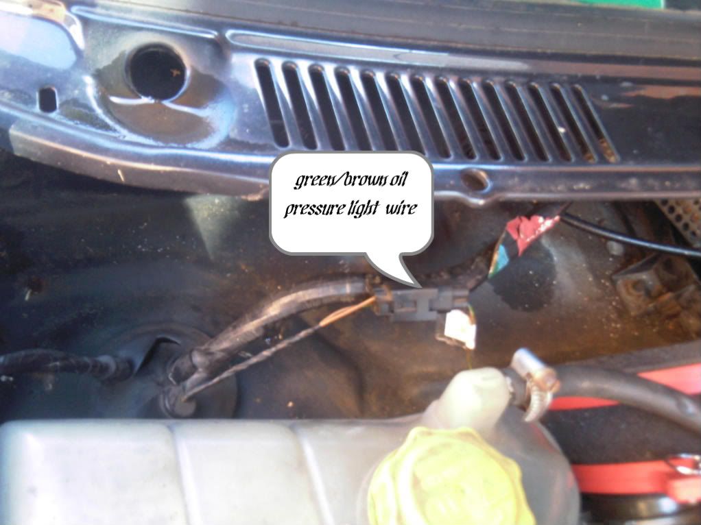

looking good :thumbsup: wish i had stuck to plan of bike carbs, lot easier to set up than throttle bodies,
as for wiring just been throught this, the oil pressure dash light is the 4way (2wires) connector behind the coolant header bottle green/brown wire, as picture. rev counter is green wire engine bay going into main loom think its pin 2, as for coolant temp gauge i gave up with this as think it was faulty anyway and fitted a separate one.
Will
