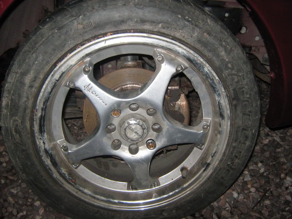

might get this if get them for good price 2 good tyers 1 ok 1 fu*cked
hear is some pics off them on the car
1 got kurb damage n they need a cleen
what do you think
PostPosted: Thu Nov 26, 2009 8:41 pm
Think ford ones would look better if im being totally honest mate, but everyone to themselves ;)
PostPosted: Thu Nov 26, 2009 8:42 pm
they look ok thow n ford 1s are ££££ n none around my area

know 1 know if they stick out it a mot fail going back to plan b ford alloys :D
PostPosted: Fri Nov 27, 2009 7:23 pm
lol, glad to hear it! :thumbsup:

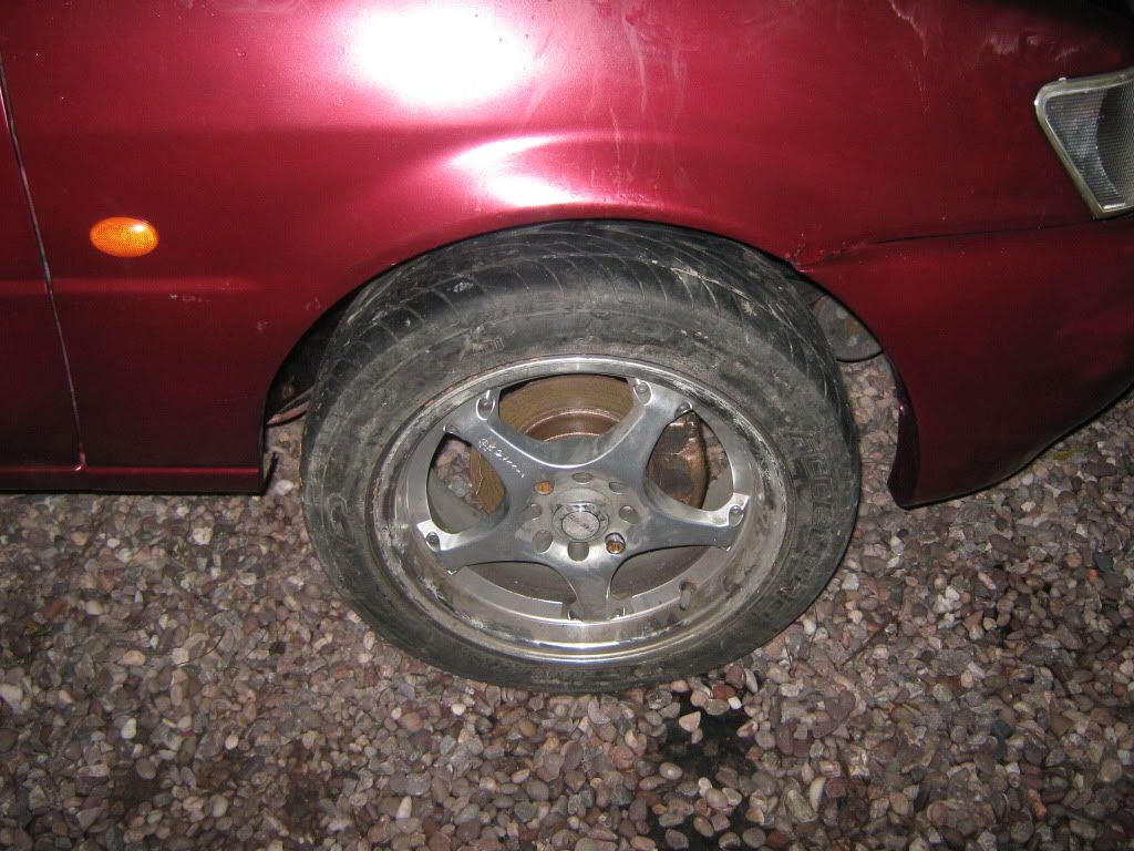

PostPosted: Sun Dec 13, 2009 5:12 pm

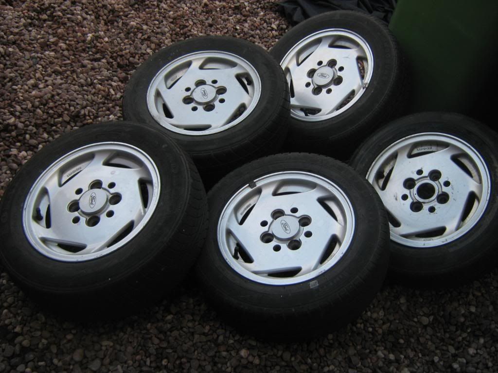

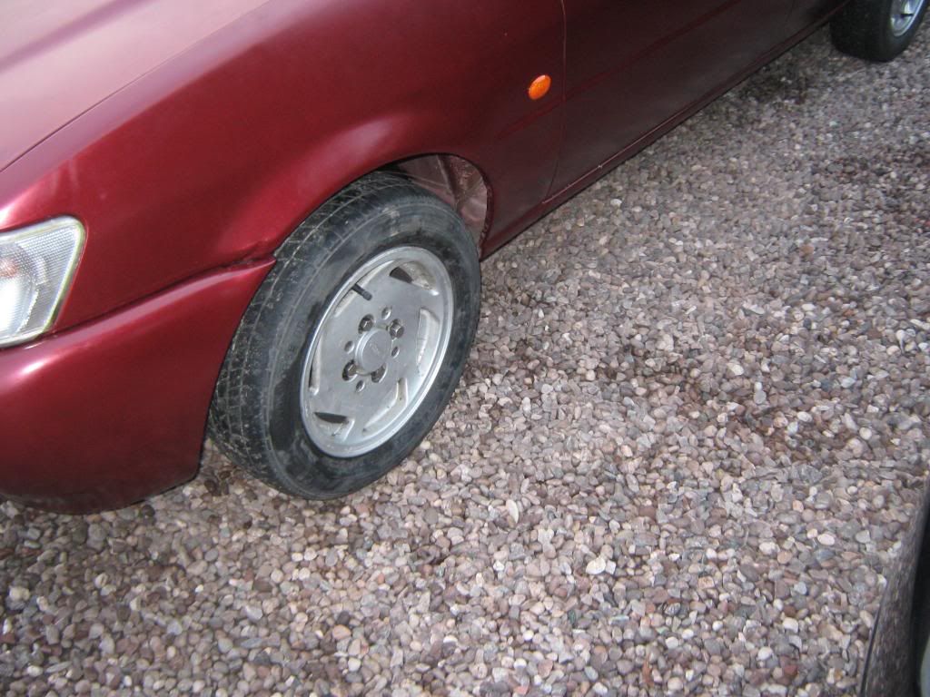

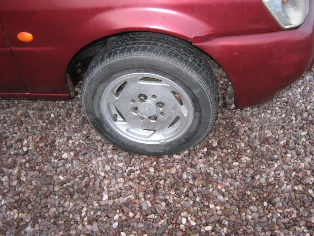

what do you think of these
Image i know there is only 3 nuts my one thread is dead so need a new hub :evil:
they spare is on the car because the other good one is flat :x
what do you think and what colour would you say do ?
i think the colour of the car with a black lip and black center cap
PostPosted: Sun Dec 13, 2009 8:06 pm
you wont need a whole hub assembely for that nut problem. take the wheel off.....undo the mounting bracket for the caliper and wriggle it off...remove the disc..twat the offending stud with a hammer and out will pop out. new one fits in the reverse way you just whacked that one out. New wheelstuds are less than a pound each. if any of the others are a bit wanky just do them aswell
Hope that helps
Jam.
PostPosted: Sun Dec 13, 2009 8:11 pm
sound where do i get one from ford
PostPosted: Sun Dec 13, 2009 10:20 pm
yup!!
PostPosted: Sun Dec 13, 2009 11:56 pm
Wheels are looking good mate.
I would recommend that you put the plastic inner arches on the front to stop the wheels flicking all that salty water behind the wing over the winter :thumbsup:
