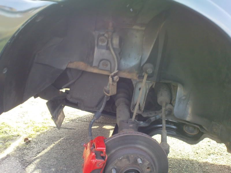

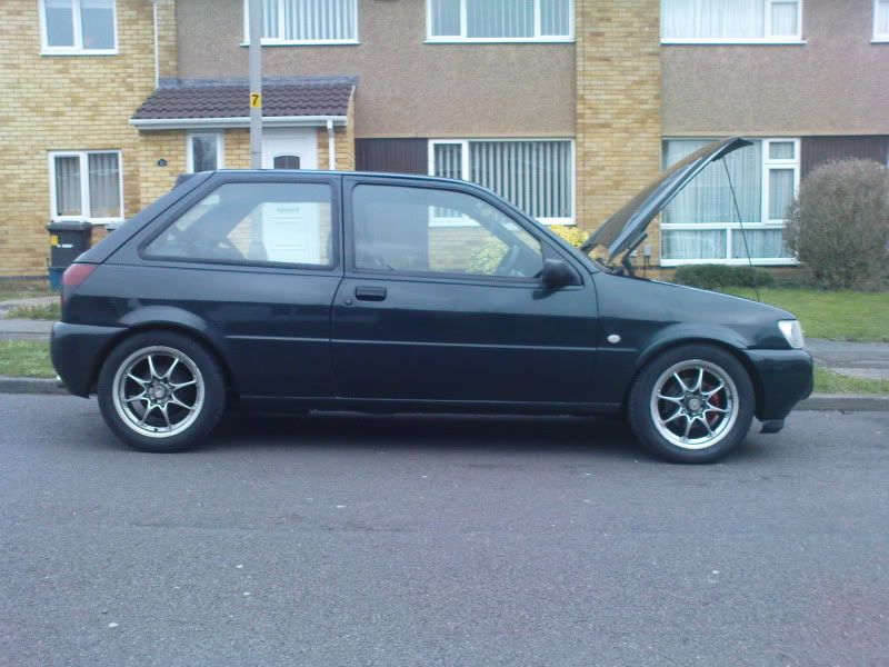

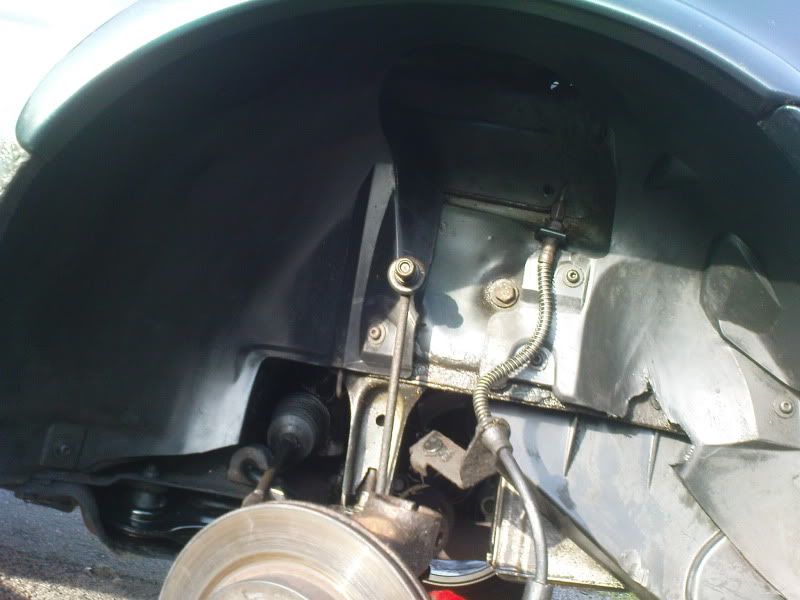

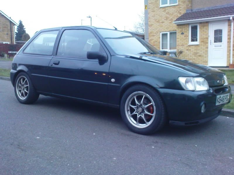

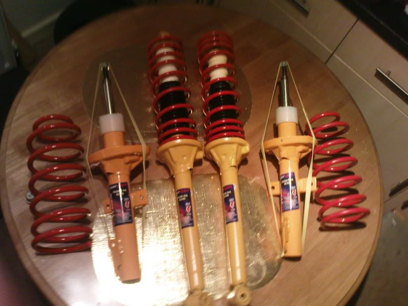

the suspensions on and god dont it make a difference to the handling!!! my old shocks and springs were shagged so these have really made the car feel more planted through the corners. they still need to settle though as they have just been put on but heres a couple of pics just so you can see the difference from before and after!
before
After
and only a couple of progress pics as i was in to much of a rush to get them on lol
hopefully have my tints fitted tomorrow (even tho they have XR2I stickers under the tint :cry: ) will get them sorted soon tho.
all comment welcome :)
Grant

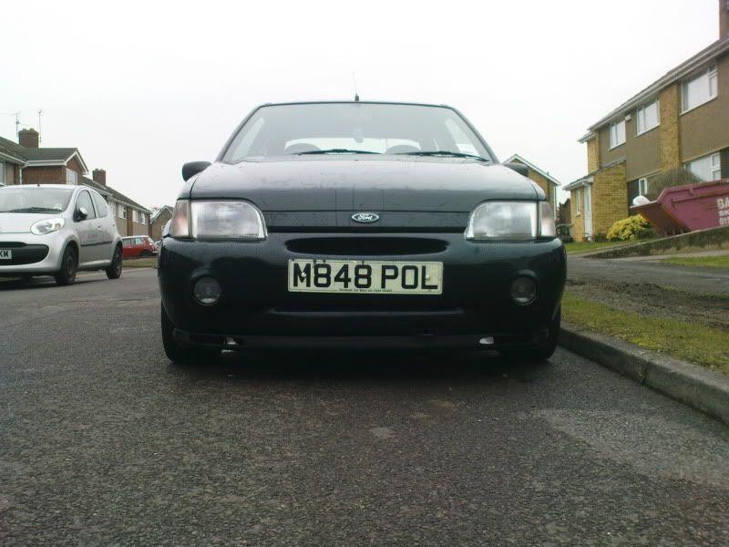

just got myself a set of mk5 phase 2 Zetec S alloys :D at the minute im spraying them panther black, will get some pics of them when they are done and on the car.
also got a bloke making me piece up for my 4-1 manifold so hopefully that will be on very soon!!
i'l also get some pics of the car now the suspension has settled a little more, looks really nice from the front with the laguna splitter :devil:

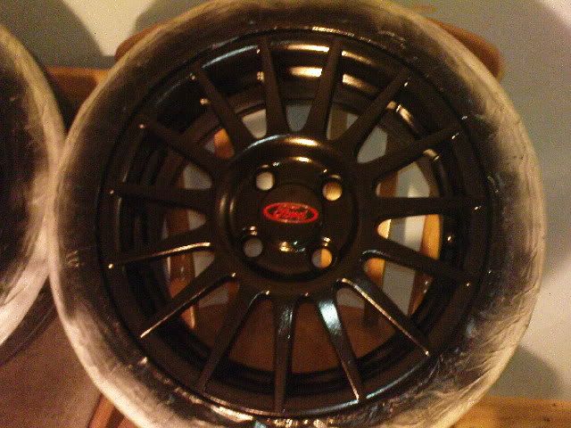

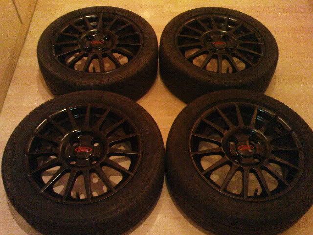

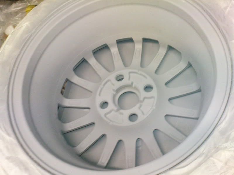

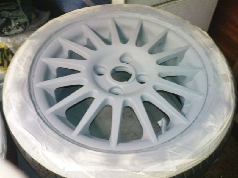

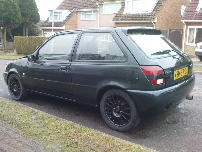

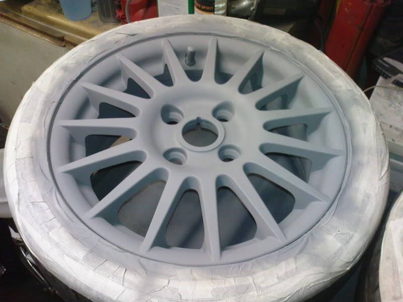

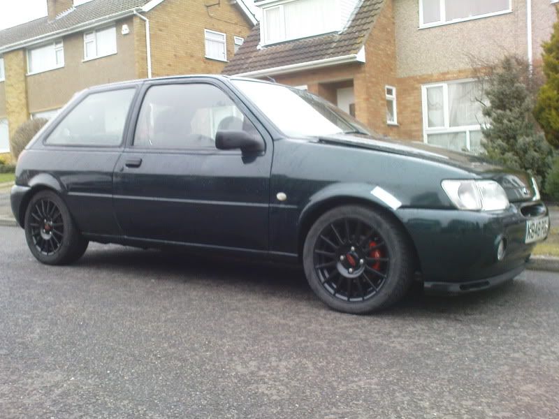

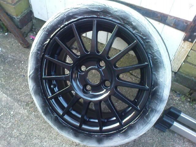

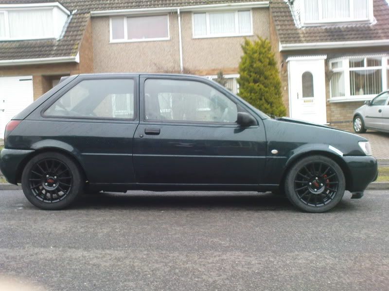

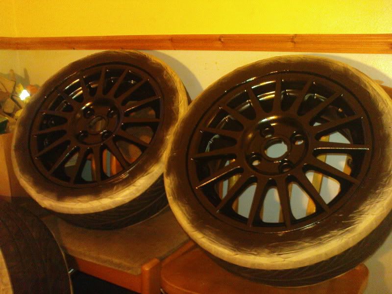

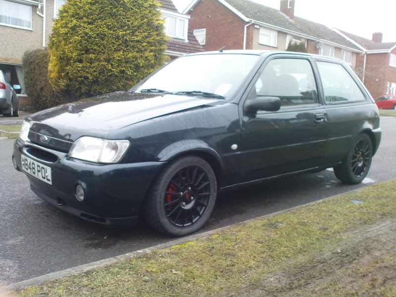

well i've got the Zetec S alloys sprayed and on the car. I really like the way its looking now just need to get round to sprayin and fitting the xr2i sideskirts and arches i've got.

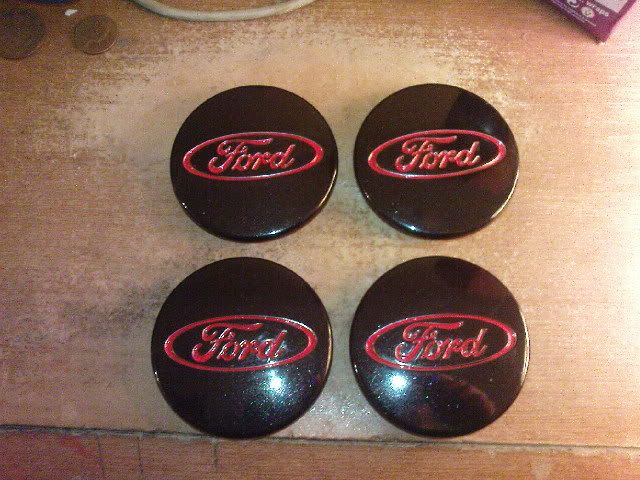

anyways i got them beed blasted as it would have took me weeks to prep by hand! so after that i primered them and gave them a lick of paint and laque. also did the centre caps black and painted the Ford bit red, which i think make them look really nice with the red calipers. anyways heres some pics.
sorry about the quality they were taken on my phone in the rain

 Post subject: Re: my 2ltr Si
PostPosted: Wed Feb 03, 2010 9:49 pm
Posts: 1516
They look really nice mate. Glad you got rid of the old chrome Zetec-s centre caps and got smaller ones. Off a mondeo?
