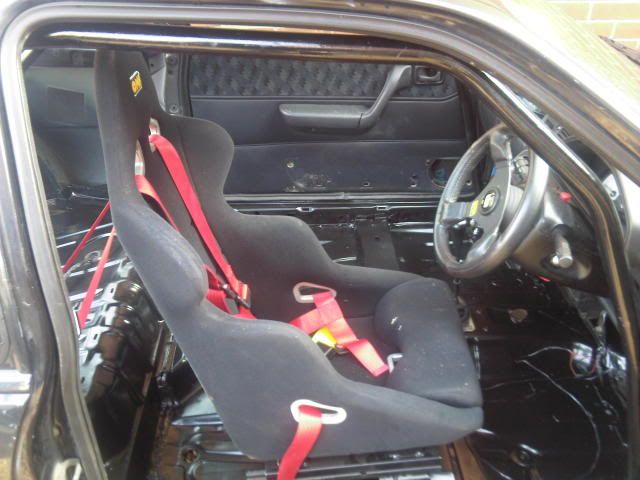

roll cage now fully fitted, sound deading removed and inside painted and finished, just got to get it running again now!Image

PostPosted: Fri Feb 20, 2009 12:37 pm
Posts: 777
Location: Cambridge
:0 door cards?
lol, coming along nicely

looks spot on buddy :thumbsup:
moved the thread into the members gallery for you :thumbsup:

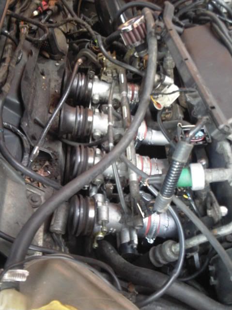

finally got the throttle bodies fitted, bit tight for space :doh: but hopefully just enough room for the air box

PostPosted: Sat Feb 21, 2009 6:49 pm
looks spot on buddy
would love to hear this bark :devil:

PostPosted: Sun Feb 22, 2009 2:25 pm
Mod the bulkhead to gain some space :thumbsup:

throttle bodies are fitted, made the fibreglass airbox and fitted along with the MAF, hope to get it all wired up and running tomorrow

wired up the throttle bodies and sensors, and it started first time :) took it up the road and the throttle responce seems much chrisper than before, only one problem came when trying to stop, i hadnt connected back up the brake servo :doh: will get it on a rolling road again soon to see if its any better

PostPosted: Sun Mar 01, 2009 8:35 pm
looks ace buddy and sounds mean!! :D
liking the idea of the fibre glass air box :thumbsup:
PostPosted: Mon Mar 02, 2009 2:08 pm
Nice 8-)
I want to see power figures with using standard ecu, should be interesting!! :chill:

hi Emlyn, think when i first got it on the RR it was about 128bhp at the engine which was then upto 139bhp so a gd solid engine, body work still the same and not improved with age as just a track hack now. runnning with the ford ECU was a cheeper trial following on from sk8xtrm inspiration, if doesnt work/improve will go down the megasquirt route as know someone in Norwich who produces it for under £300 just didnt fancy the setting up hassle but ment to produce 160bhp on a otherwise standard engine.
i based the plenum on the pipercross idea which just has a single end feed, as for the idle valve i did wonder but just left it unplugged and used the standard idle adjuster on the gsxr throttle bodies and seems to tick over well at about 900rpm
