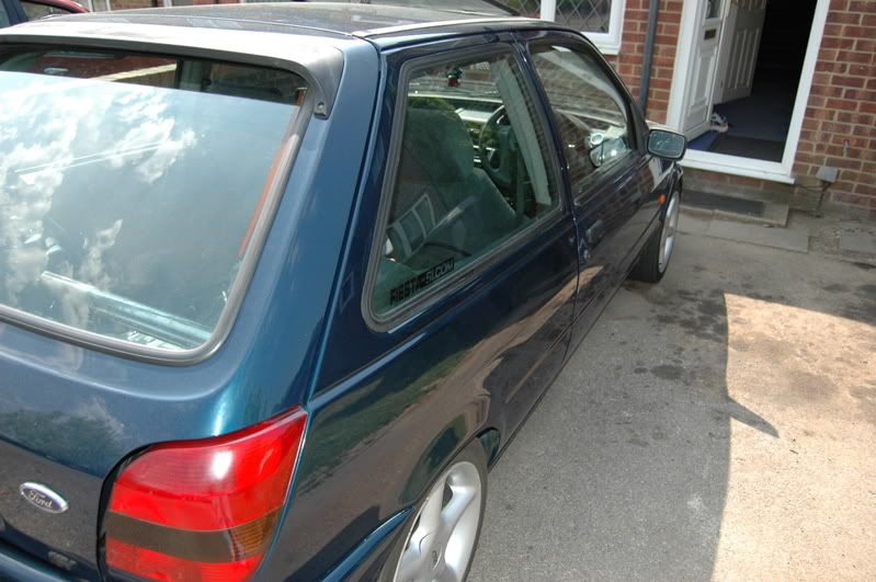

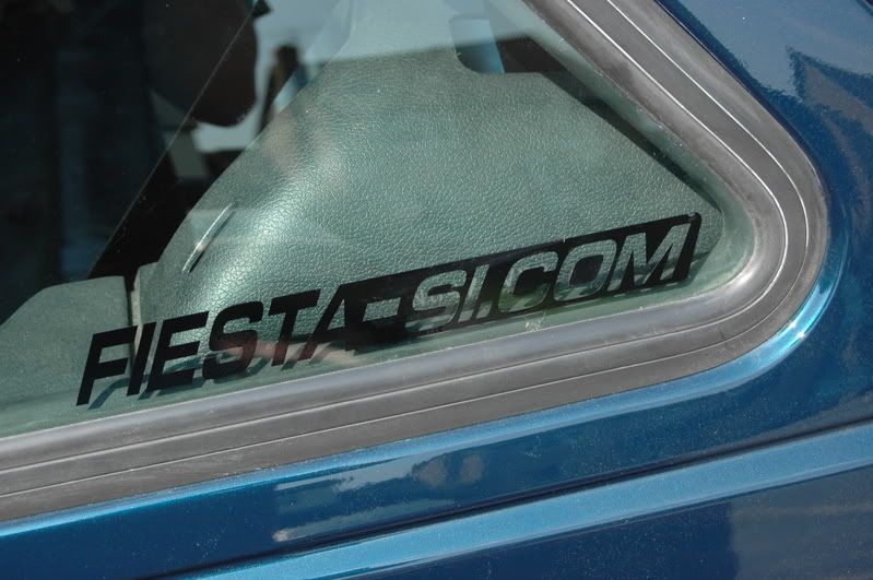

morning people thanks for the comments , poped in to work to day as iv been off for a week and my FSI stickers had turned up, so come home and set about fittin them with me ;) one eye lol , they dont look to bad so heres some picks

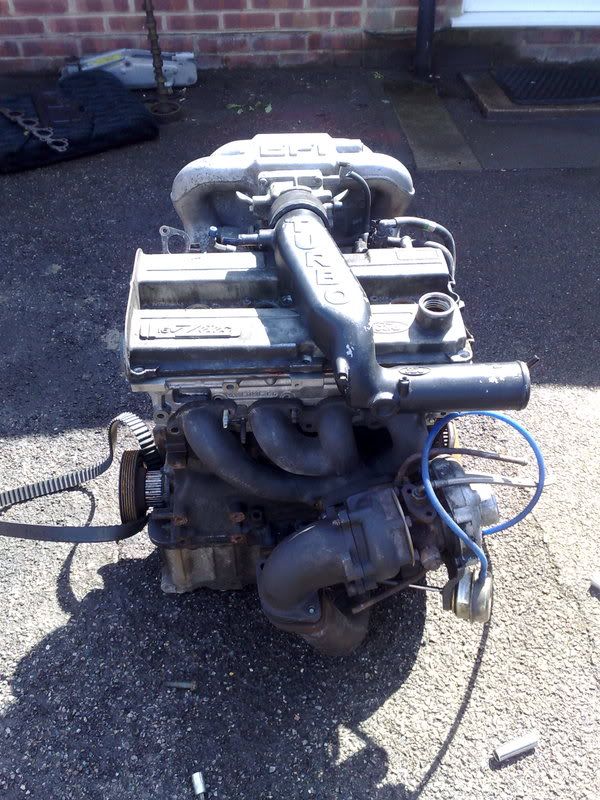

heres my turbo mock up engine all bit and check
nothing fancy , 2.0 rebuilt , new rings bearing , decomp plate , custom breather , stage 3 t3 cosworth turbo , escort turbo down pipe, drilled and tapped head with polished ports , std size valves just re-lapped rs1800 inlet, modded injecter plate to take frst injecters, black top zetec fuel rail , or maby festa turbo if i can find one lol
(note 1.6 inlet on there for mock up , rs1800 one is at work painted white with st orange bits and i havnt been back for to weeks lol )

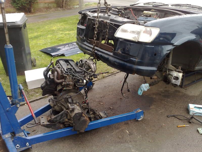

and a radom pick of me engine swap
agen not the engine in there now thats the one that is now the turbo one lol
PostPosted: Tue May 20, 2008 11:08 am
Nice 8-)
I take it your gonna run FRST management?
PostPosted: Tue May 20, 2008 11:23 am
Posts: 277
Location: sorting the SI
yeah mate iv done megasquirt before just seems to much hasel , cossie managemnt is old skool, dizzy and everything lol, altho many upgrades out there, im gonna go with fiesta turbo OFAB as it should be fine , if i ever get ound to makin a proper one it will go autronic and be mapped at MADevelepments
PostPosted: Tue May 20, 2008 11:46 am
I would have thought megasquirt would have been easier as you need to get the OFAB mapped properly anyway :)
PostPosted: Tue May 20, 2008 11:56 am
Posts: 277
you have to have anything mapped proply, i would be gettin it live mapped anyways , so wethers it ofab mega squirt or omex it will still havin live map, i can run the zt with out it mapping it to start with , think its about £500 for a live map

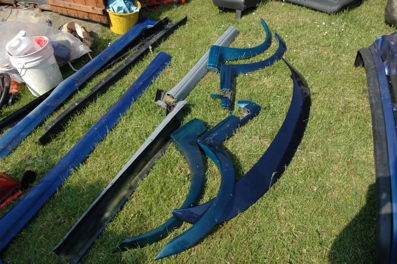

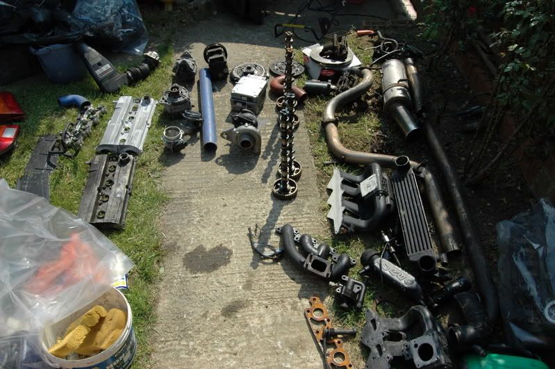

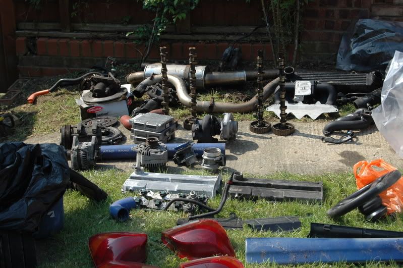

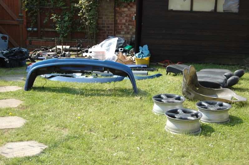

on anothe note cleaned out my shead and this is what i found !
took me fuckin ages to clean that lot up! more car bits than i no what to do with
PostPosted: Tue May 20, 2008 4:25 pm
Posts: 1570
wow you really do hoard car parts dont you!
engine looks like its going to be quick! might be a tight squeeze getting it back in?
