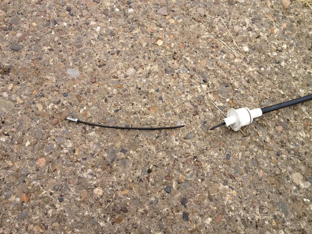

That's the pedal end where it snapped. The other end looks decent actually.
PostPosted: Fri Jun 01, 2012 12:29 pm
VERY strange for it to snap there.
It couldn't have been installed correctly for it to snap there. The breakage looks clean as opposed to frayed and stressed.
But they usually break due to friction and snagging on the rubber block where the nipple does into the block. Copper crease can help it not break. But thats no use to where it broke on yours.

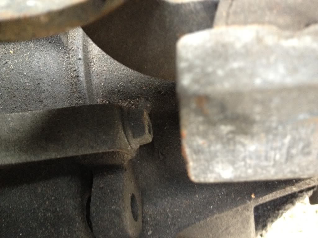

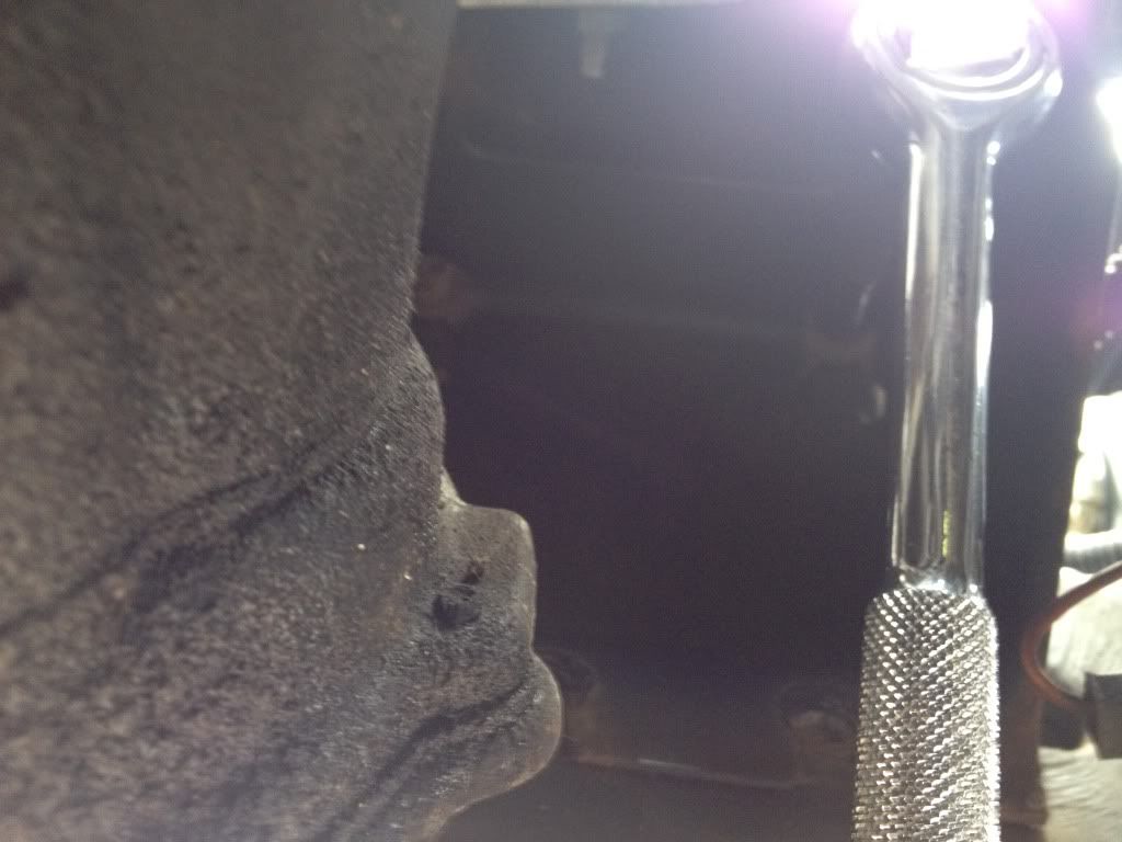

Also while I was there I started preparing the car for converting to hydraulic.

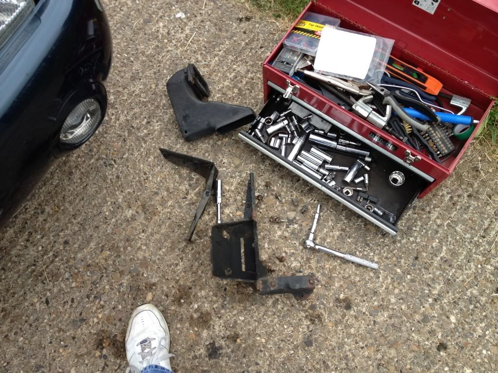

Up he goes and off comes the MAF and cone filter.
Next, the bracket that holds the standard airbox needs taking out as where it holds the inlet feed, it gets in the way of the plans...
That's all the bolts needed to undo it, plus three holding the two parts of it together.
And out it is:
Always got to have that random foot shot.

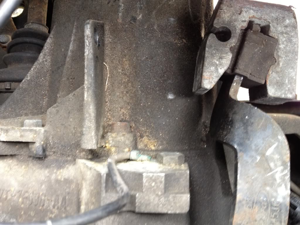

Then the bracket for the slave cylinder will go on this bolt (extended new bolt of course):
Then a little supporting bolt here:

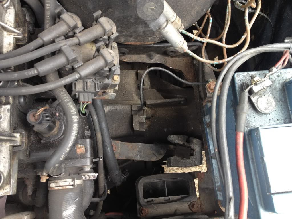

And here is the 'empty' area:

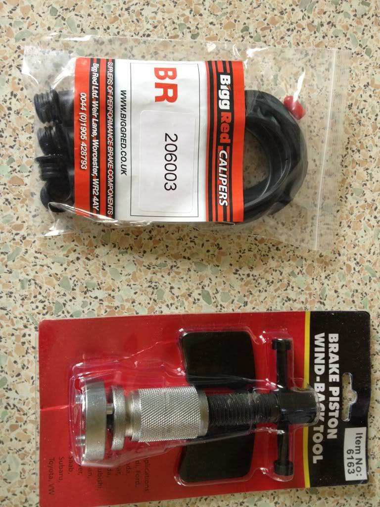

Going to fully recondition the front calipers. So proper seals and also the rewind tool to help push the caliper in straight. That's next week though when the car isn't going to be used for two days.

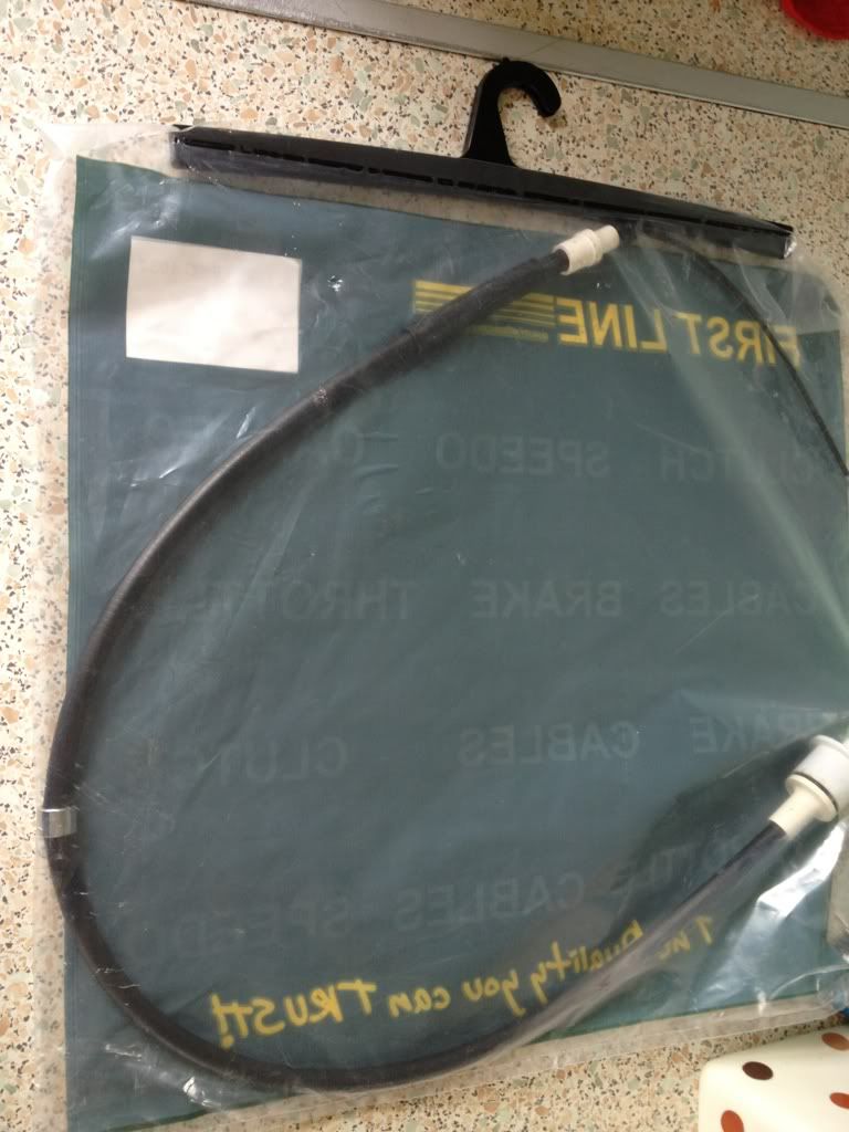

PostPosted: Fri Jun 01, 2012 2:36 pm
That clutch cable wont last a week, firstline should be called lastline because they are so shit!

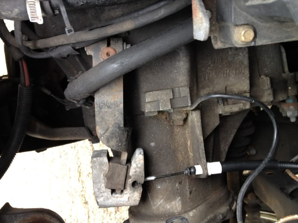

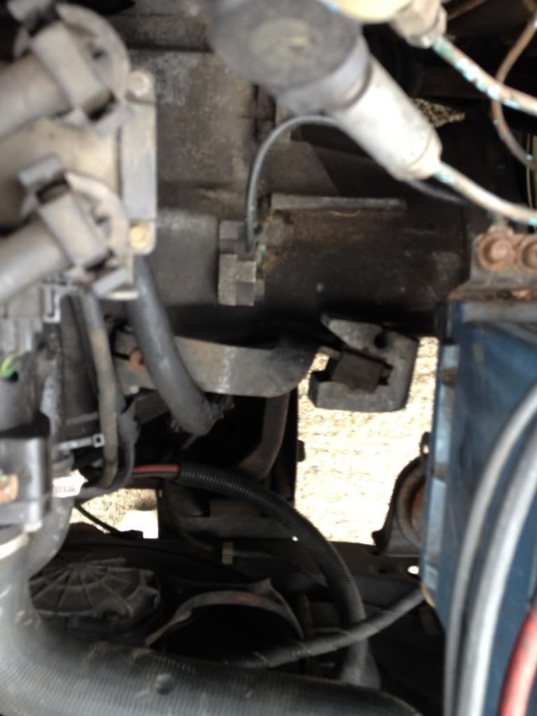

Here we go with the little guide:
With the old one removed (as you usually have it very easy with it snapping on our beloved Fezzies!) you just need to raise one wheel on the car like so:
Shove the new cable in like so:
It needs to point towards the oil filter along the brake bar. Too difficult to take a quick picture.
Push the lever end through the hole on the gearbox and connect up the end into the lever.

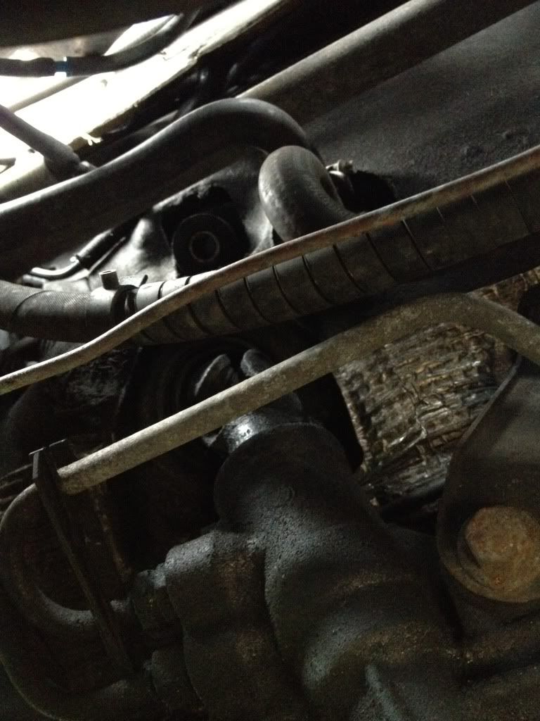

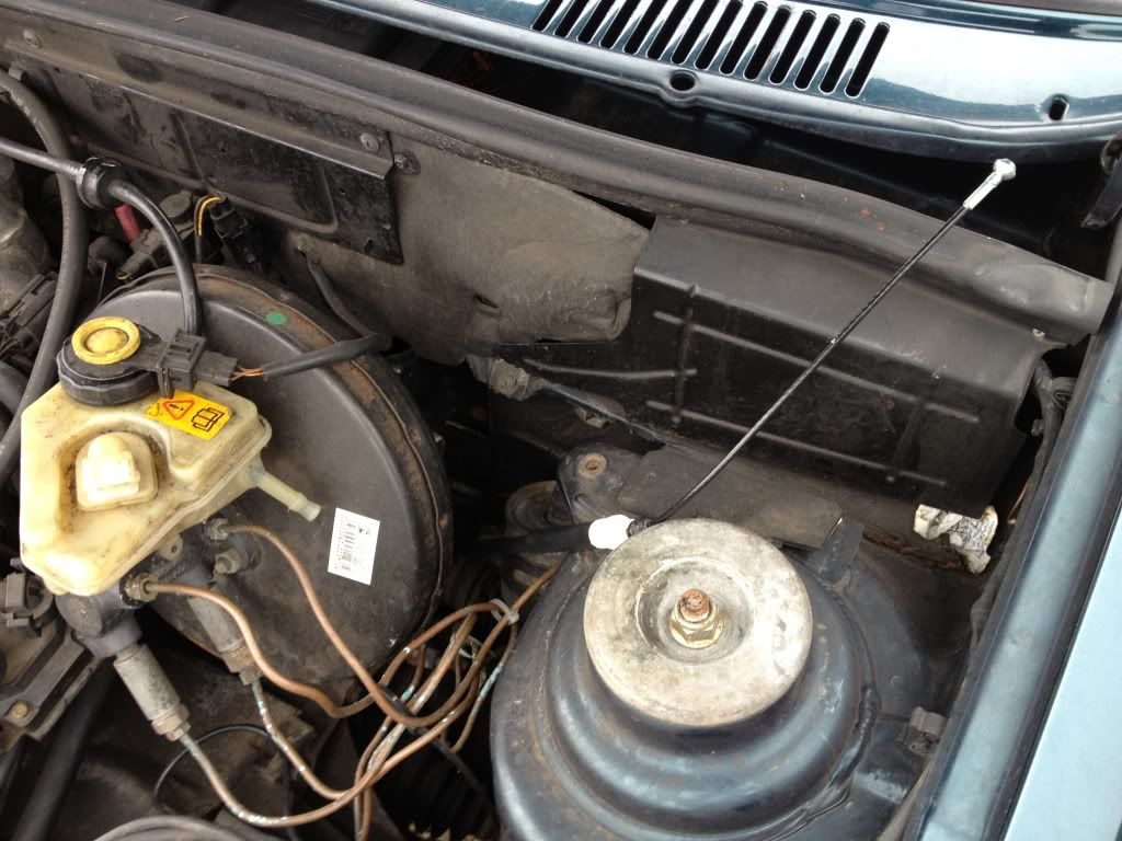

Looking up at the bulkhead you'll see this:

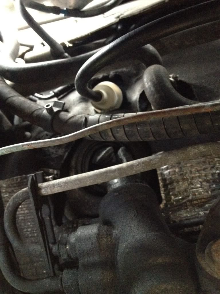

Fiddle with the end of the clutch cable so it goes into the hole like so:

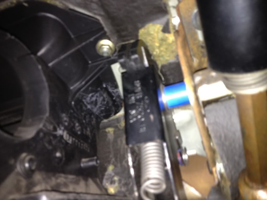

Then get into the car (push the drivers seat all the way back, it helps) and then look under the dash at the top of the clutch pedal.
See the quadrant at the top?
It's actually easier to not use tools such as a screwdriver here. Feel around and you'll feel the other end of the cable where it's come though the bulkhead. Pull on it a little and move it to the side a touch, then PUSH that bloody quadrant back and over. It's awkward but it's doable in the right position, then hook the cable over the end and under the stays.
And done. Takes around ten minutes when you fight with it, because it is fiddly.
