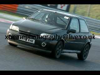

done another trackday on 13th November, the video camera failed me though, it was a eventfull day Fiesta went great with the new Limited Slip Diff, it was wet in the morning but even managed to put the slicks on after lunch what a hell of a differance they make,one lap and they warmed up after which they stuck like Sh1t.
One car through a con rod putting oil down before afast approach to a 180deg corner, the following clio spun and went head on into the armco one written of daily drive, explain that to the insurance
On another note I recently brought a set of Neway valve seat cutter and cut 3 angle valve seats on a ported cylinder head im doing, dont know what difference it will really make to flow but hopefully make lapping in of the valves easier

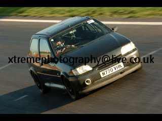

done another track evening at Snetterton on Thursday, not off to a good start as failed the noise signification at 106Db max was 102db, had to then change the whole exhaust laying in the rain for a spare one i have with two silencers in it, that got it down to 96db.
Think i will leave the quiet one on as didn't seem to make any performance distance.
Track was damp so had basic toyo road tyres on which rolled a lot in the corners.
i had issues with the brakes before, i changed the rear cylinders for larger ones as a better match to the bigger RS2000 master cylinder, OMP front pads, crap when cold but great when warmed and didnt fade but that might be a bit down to early braking as damp.
