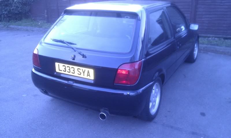

Small update today...
Past few weeks I have been doing little jobs here and there.....
- Fixed rattling fan (didn't realise the bottom of the fan slots into a guide!!!)
- De-rusted inside of one arch....bit of a shoddy job but it will do till summer
- Fixed boot rattle!!!! Re-aligned the boot catch for this...
- De-rusted boot and hammerited it black (not a great job)...fitted boot carpets including turrets
- Re-tined rear lights pure red.....Technically has to be addressed still. looks good though :). Check my thread in 'Modifications'
Pics:
Rust:
More rust (i nearly cried!!)
After some hammerite
and again....Fitted the arch liner back on so its covered anyway. Mission was to remove rust and seal...
Boot floor once painted...It was a rush job tbh, but atleast it's covered now with my carpet
Lights :thumbsup: :thumbsup: :thumbsup:
and again...
Also, update coming up soon...
I've bought some new wheels. They are SUPER rare, infact so rare I have never seen them before....16" Ford wheels made by Ronal. I think they may be European as they have a funny offset (ET46) which will be a fun task to address i'm sure!
Anyway, opinions appreciated...
Andy

PostPosted: Sun Mar 20, 2011 6:08 pm
looks good mate
