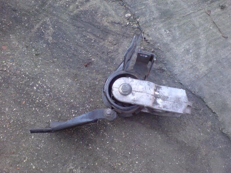

You might be able to use the rear one, not sure though. Front one will need changing for a zetec one. The alternator bracket one looks like this:
Well thats the part that bolts to the wint, the other bit bolts onto the bracket.

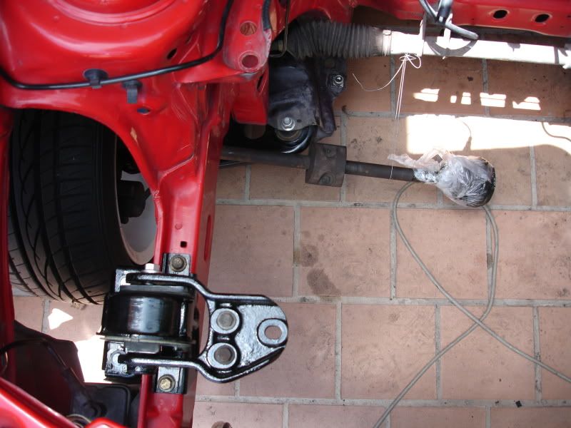

Goes on like so:
