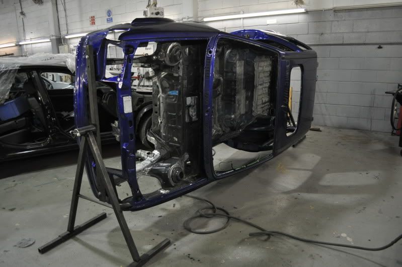

connected the front end of the car-spit

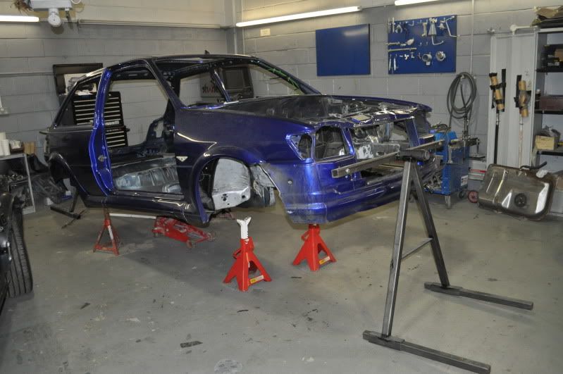

in the end after playing with the jacks with no joy as they would'nt go high enough,
i got the engine crane out and lifted it up high enough so that the car is now on the spit 100%
its very wierd being that high off the floor
you can see how much higher i needed the car from the gap
between the axel stands/jacks and the car

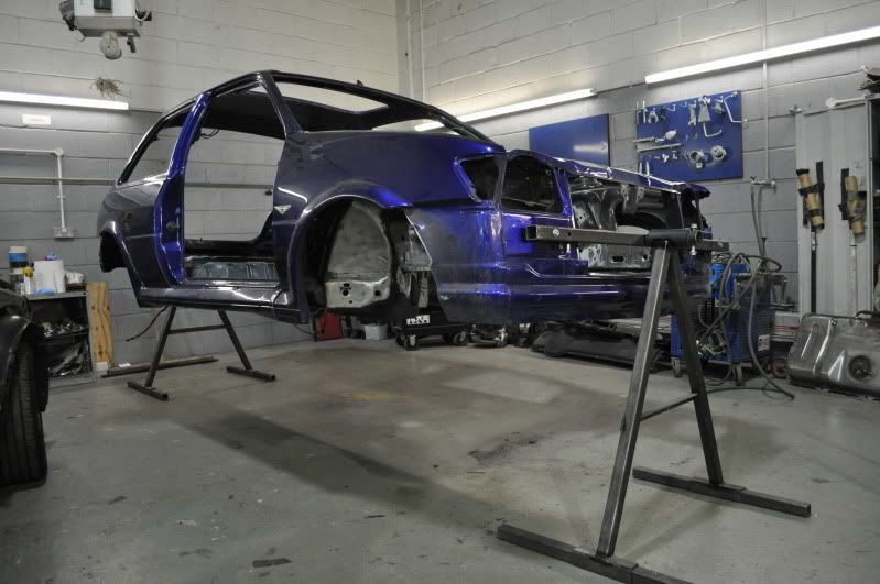

more progress of the fez on its side

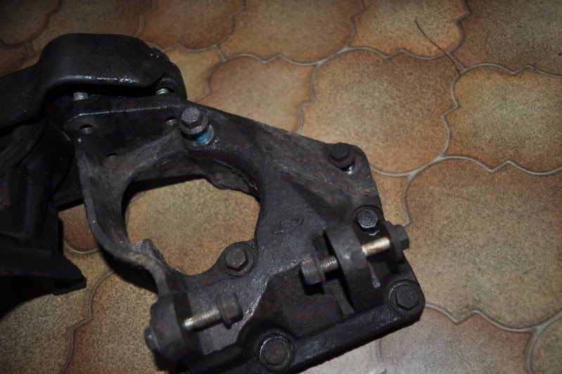

heres the current powersteering setup on my old engine i'm ditching for the new setup
