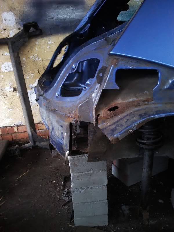

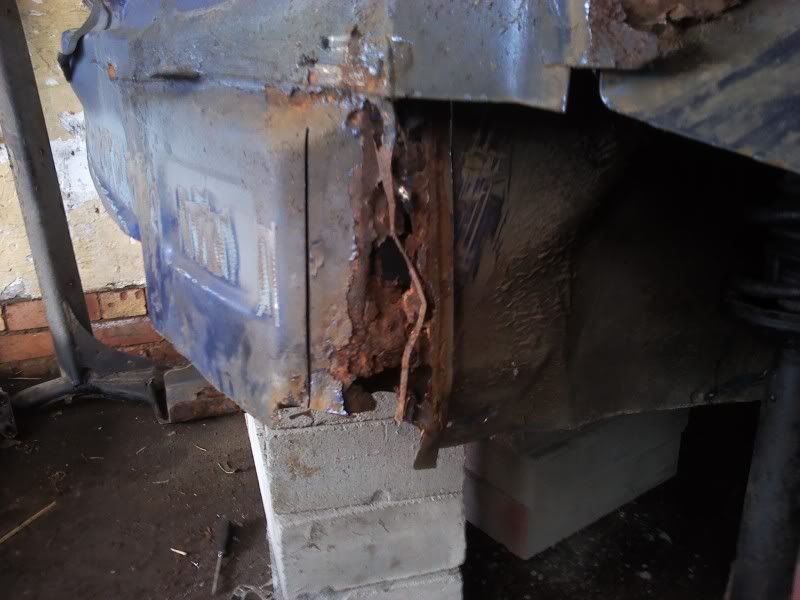

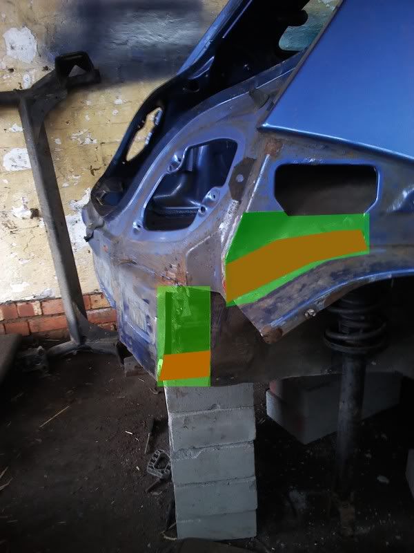

Far from exciting, some awkward parts will need patching up too :squint:
Gonna buy another filler repair panel to use on the inside bit which is grotty, exactly same size hole so wont be too bad to sort out.
Will cut more of the bootfloor out once I get it down off the blocks, its too high for me to move at the moment.. will be cutting down to the next set of raised section, and box out a place for a battery recess.
YUMMY

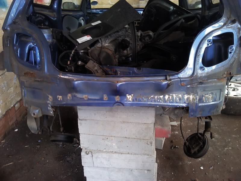

This is the arse.
I need to get rid of the spot welds for the inner rear panel, the light panels and then cut away some of the boot floor.
Patch the inner bit first and respot the other panels back on, then the outside im simply going to patch up in one go, as its covered by the arches anyway.
Will need to fab abit to go around the air panel thingy onto the inner rear arch panel.
Luckily the other side is near perfect!!
showing the welding idea lol
