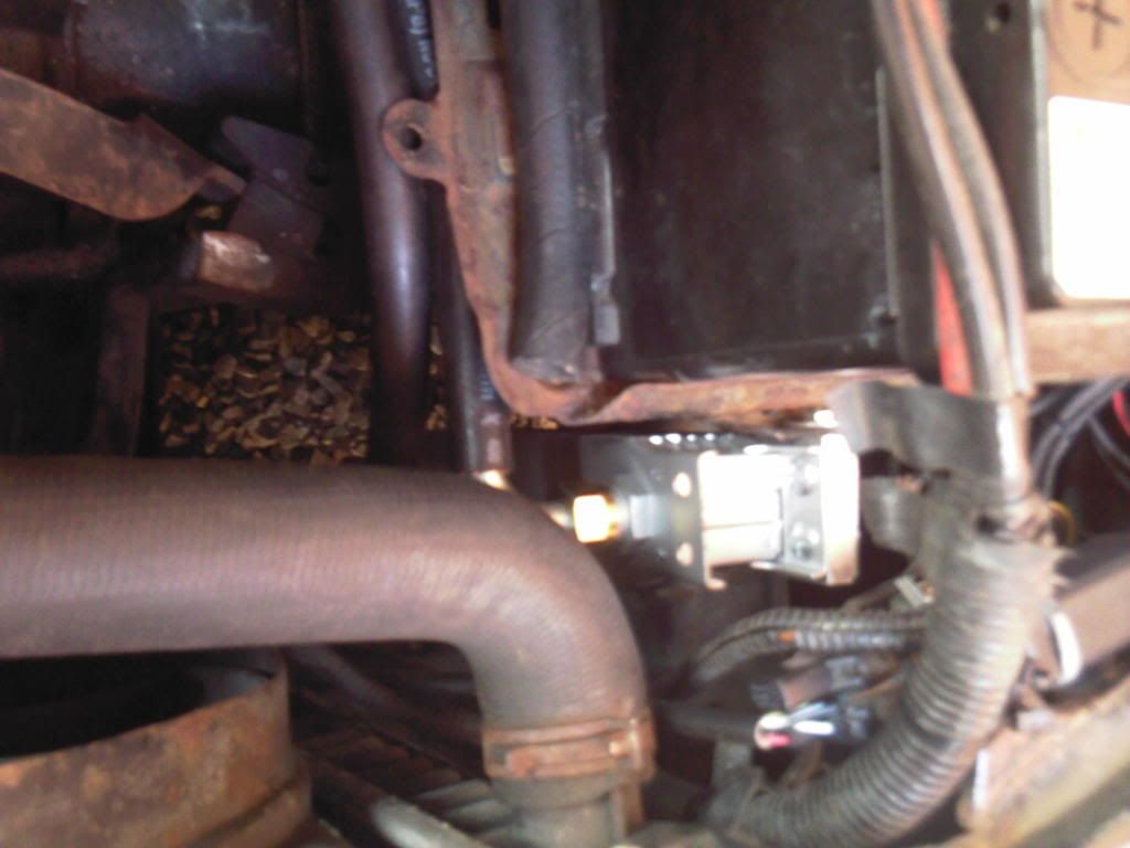

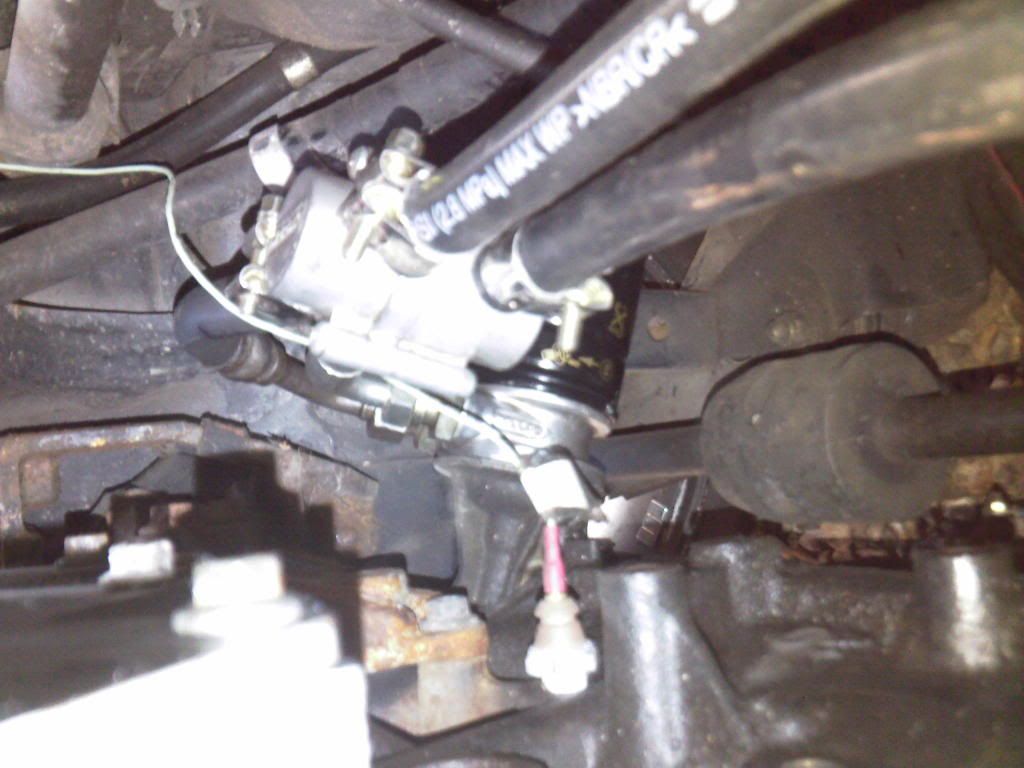

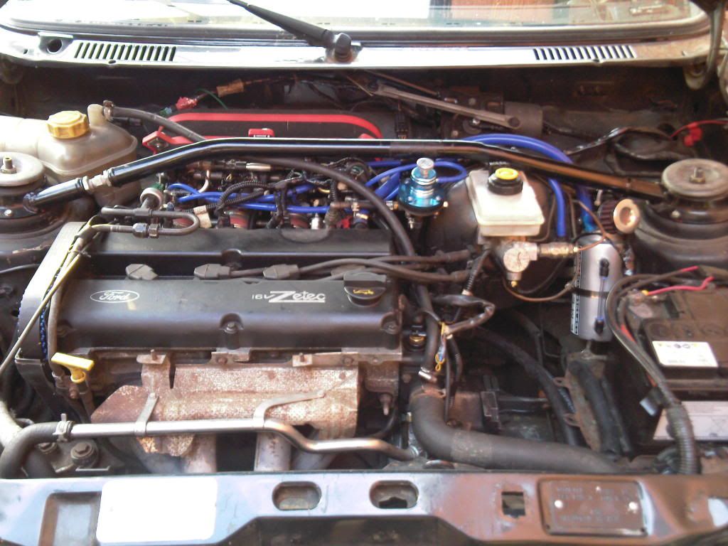

finally managed to get a few jobs finished, fitted a oil cooler with sandwich plate and thermostat as last time out oil temperature was 120degC whan air temp was only 6, its not the best place to be fitted but should get some air with a bit of ducting, also fitted a new fuel pressure regulator as the cheap ebay one wouldnt hold a constant pressure.
Now just got to book another track day.
