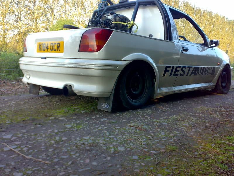

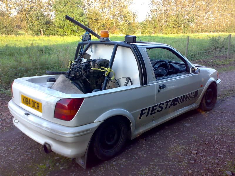

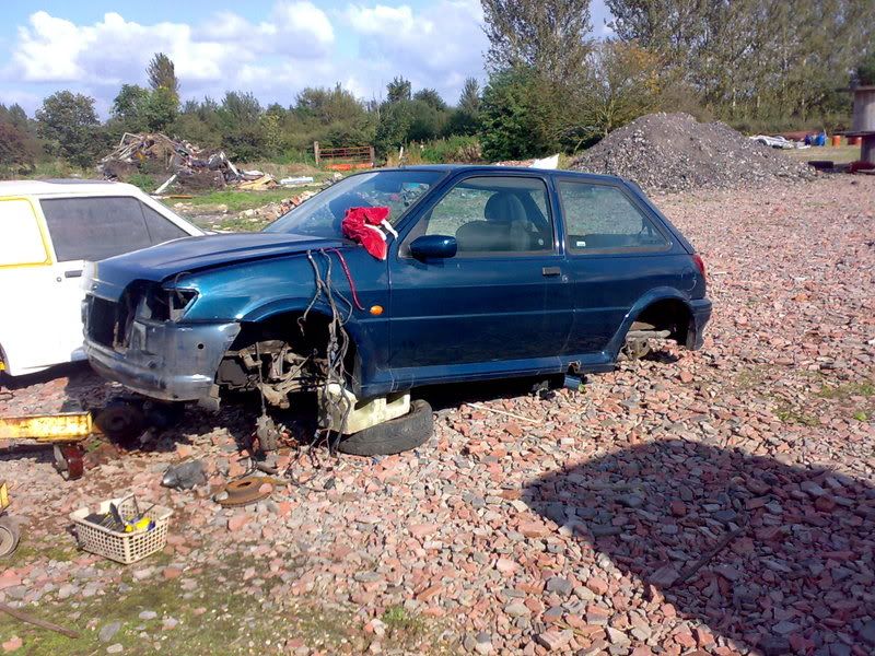

PostPosted: Thu Sep 25, 2008 9:24 pm
Well this is what you call an RS1800... :cry:
And this is what you call slammed pickup! :lol:
Yes that is my exhaust out the sunroof. And yes that is the complete engine box and cradle in the back of the pickup. :red:
Saturday is a new era. RS1800 MK3 Fiesta Pickup!! :chill:

PostPosted: Fri Sep 26, 2008 8:14 am
:cry: @ the rs1800, soon to be restored to the track slag i bet though :devil:
:lol: @ exhaust out the sunroof
Heres to a pain free conersion :thumbsup:
PostPosted: Fri Sep 26, 2008 10:55 am
Rs isnt in too bad condition, i was suprised to see no rust on front end at all, but its getting treated to new wings anyway, which im gonna cut up anyway :lol: the engine conversion shouldnt be too bad, engine loom and tank from rs, the pickup has the breathers for tank as it was petrol in first place, so less hassle there! Just a case of swapping gearboxs, clean up and change aux belt. Was gonna paint engine but stuff that u cant see it much. Lol
