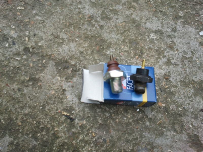

since putting the white fiesta back on the road I noticed the oil pressure light wasnt coming on at all, so I test the switch and switch came up as faulty 5 quid for a new switch sorted :)

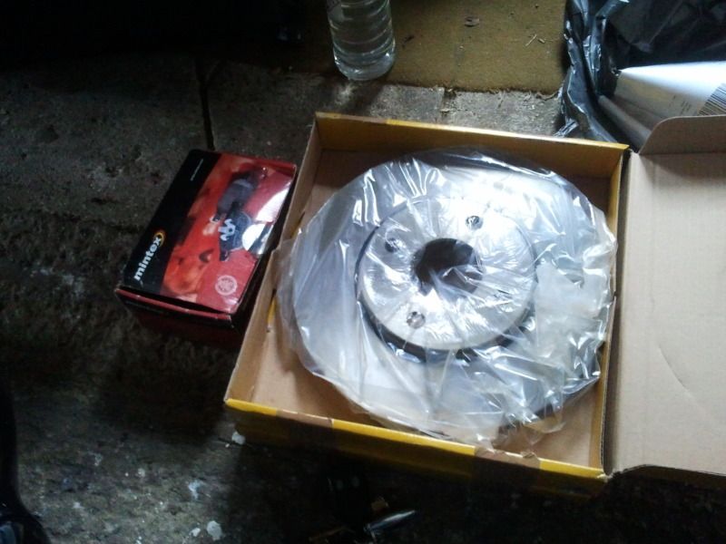

also bought some new escort cosworth discs and pads for the si and the proper spacers this time

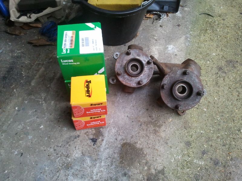

also bought new wheel bearings and hub flanges and rubbed down 2 spare hubs I had in the garage which will be painted once there back from having the new bearings pressed in :)

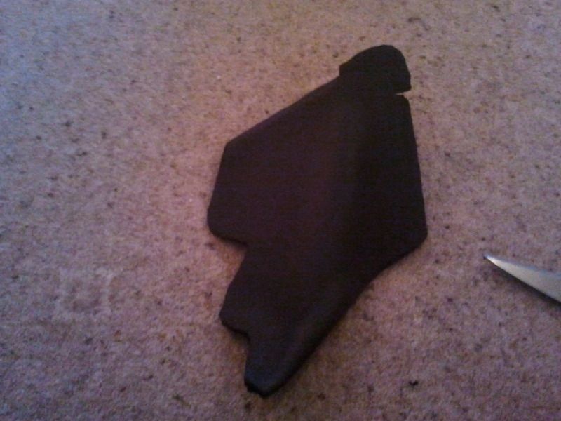

also I trimmed the metal plate with new sound deadening

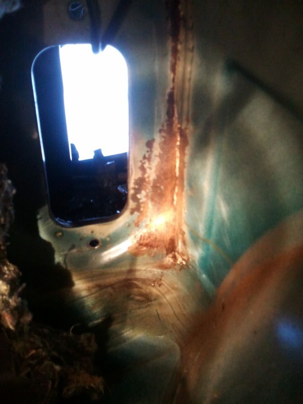

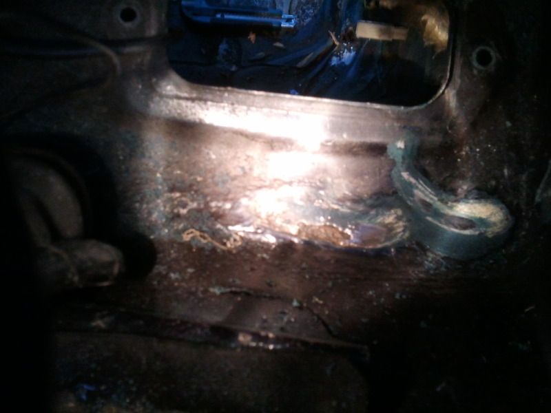

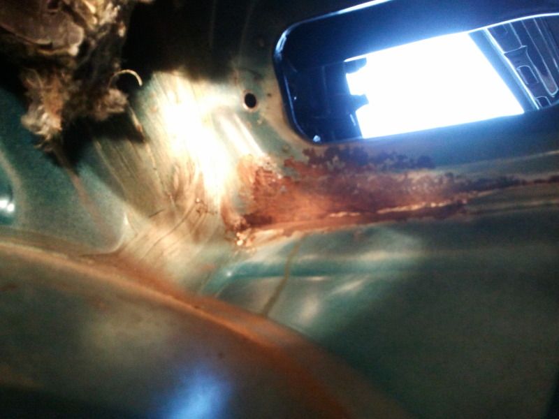

another update found where the water was coming from, it was coming from the ecu mounting on both sides the seam sealer had come away letting in a small amount of water and destroying the underlay
heres some pics
engine bay view after grinding part of the area down
since the pics ive rust killed the metal luckly theres no holes :) should be getting it primed and re sealed sometime next week :)
also since putting the runabout back on the road theres been no oil pressure light coming on when turning the key so I ordered a new oil pressure switch for a fiver and job sorted :)
