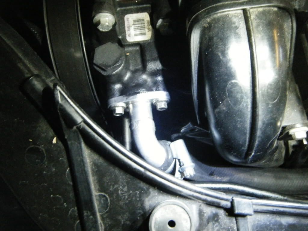

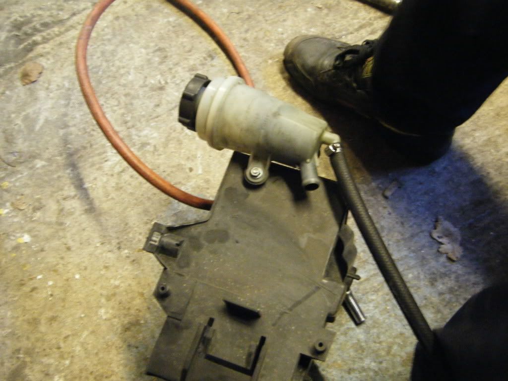

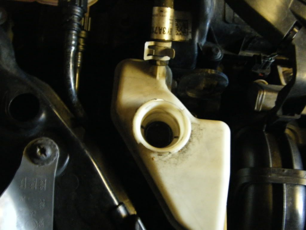

power steering relocated and quiet as anything :) well happy :D

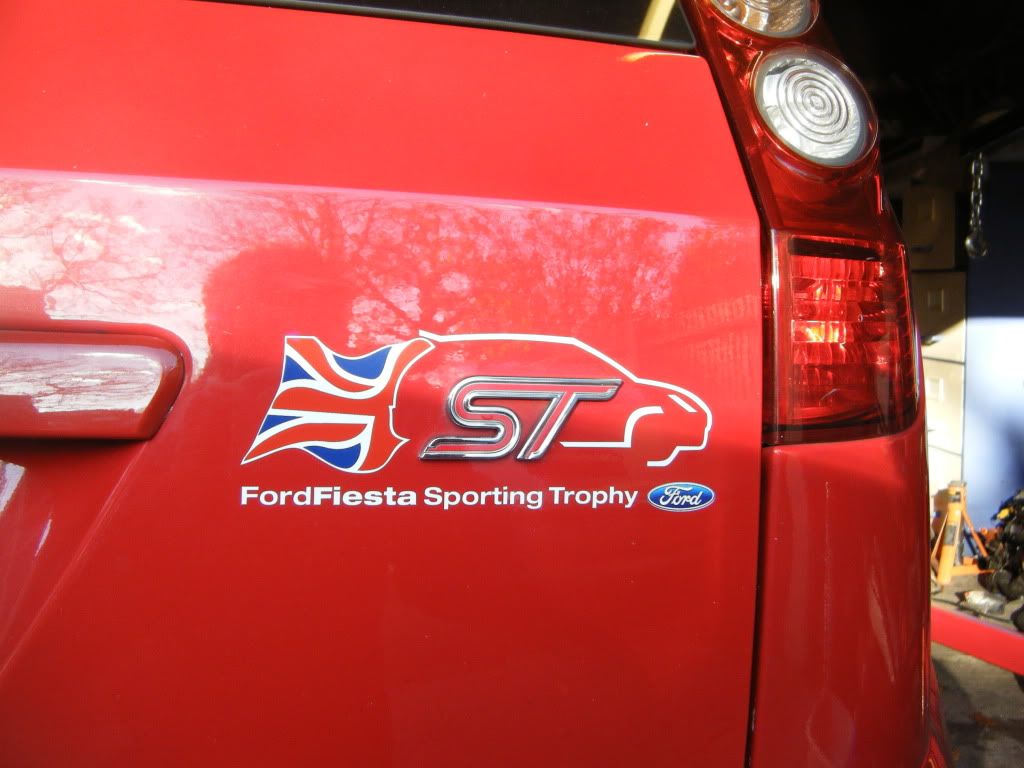

Pics from yesterday
Old Set Up
Kit
Fitting
Decal
Other

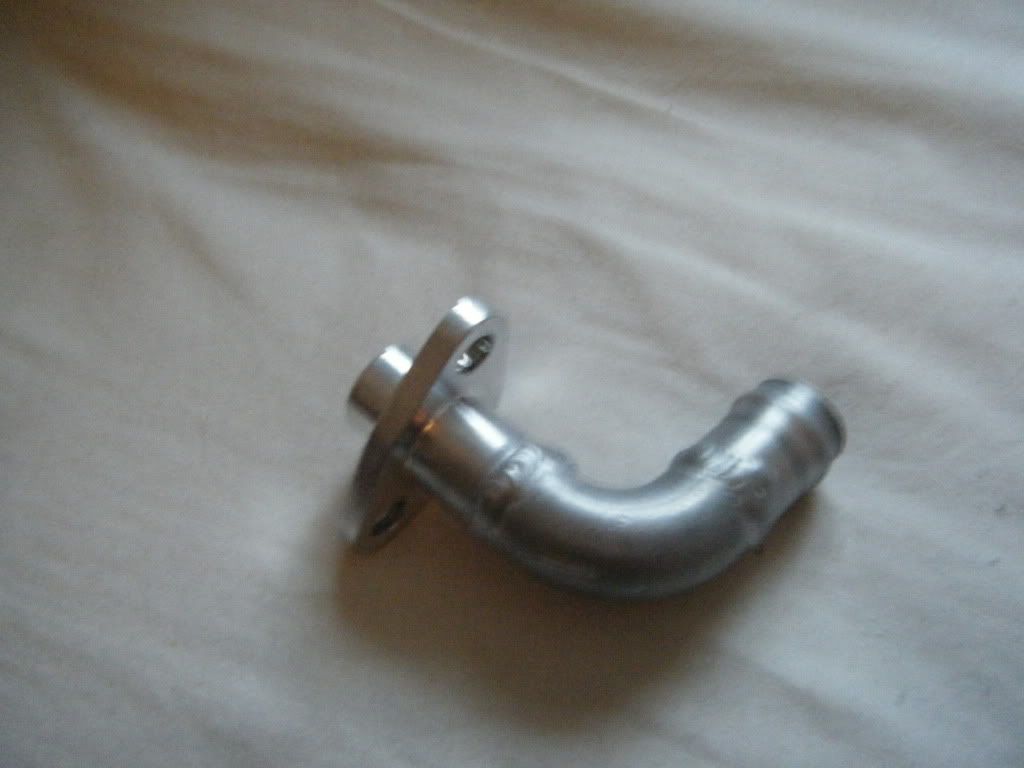

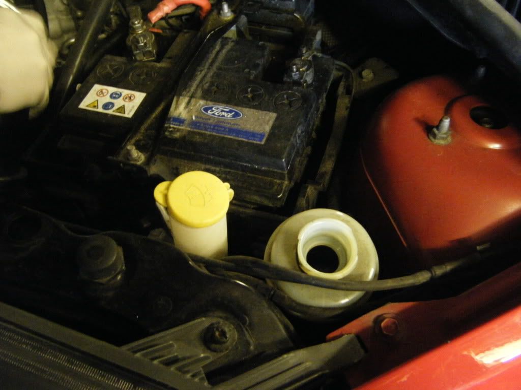

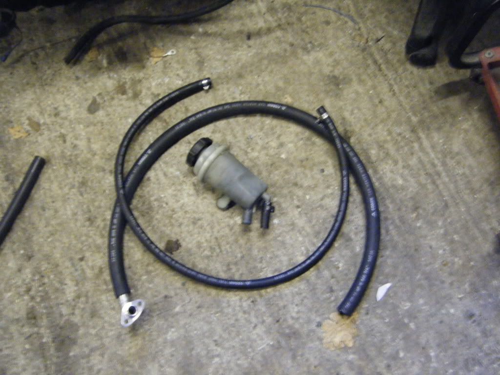

it might have been mentioned before, but why the need for the kit of the pas?
PostPosted: Fri Nov 12, 2010 1:07 am
PostPosted: Fri Nov 12, 2010 1:12 am
why does its position cause it to make a noise though? I cant be bothered to read back through 3 billion posts to find out!!!
PostPosted: Fri Nov 12, 2010 7:24 am
where the bottle was, a: there was a pitiful amount of fluid due to being a small system and b: being right on top of the engine the engine heat would boil the fluid as there was no cooling.
Where the fluid is now, the fluid goes round the back of the engine to the new bottle, along the front of the car where it can cool and back into the pump. It still makes a bit of a noise if you gun it for ages but it is 99% better :D

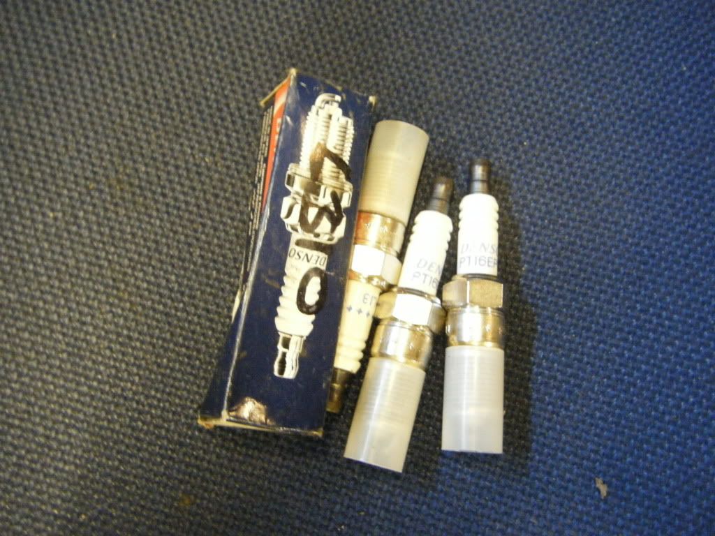

you really left it 11k overdue for a service? :0

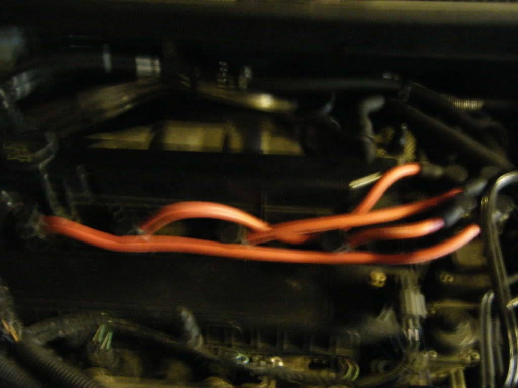

what spark plugs did you go for? NGK iridiums ftw.
PostPosted: Fri Nov 12, 2010 3:07 pm
Yeah it works fine :lol:
And well the plugs were that overdue did a oil change at 41000 so the oil was on 7000 miles :)
PostPosted: Fri Nov 12, 2010 3:58 pm
Mine works fine too.
I use to run denso iridiums, but use bosch super 4s these days.

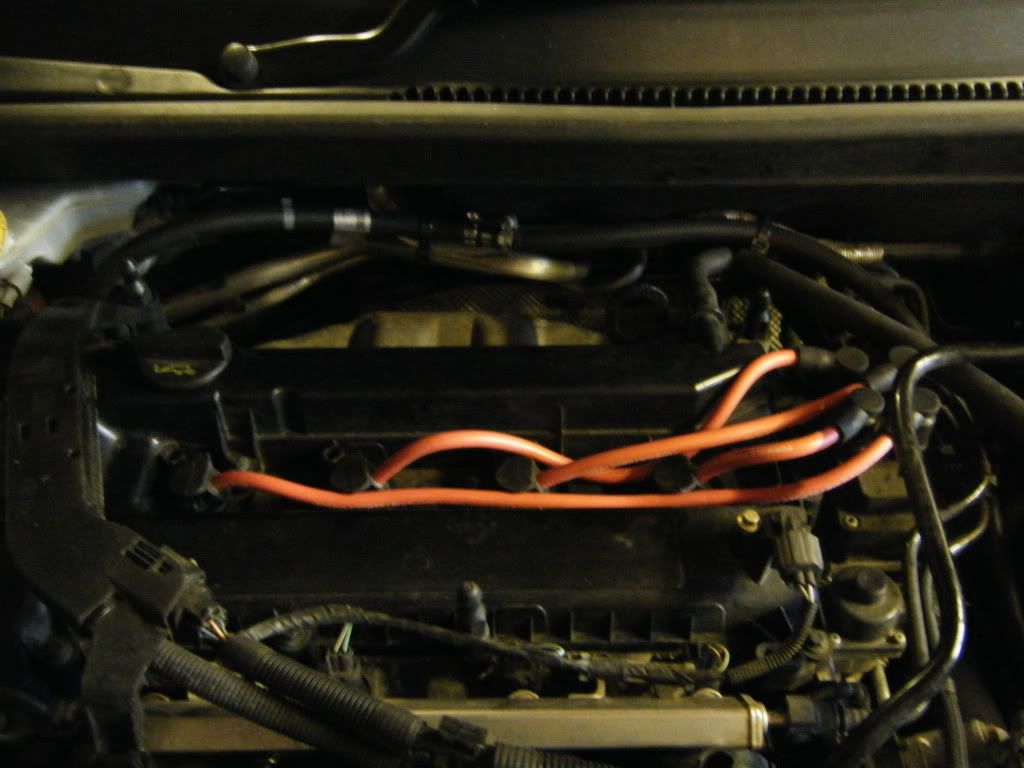

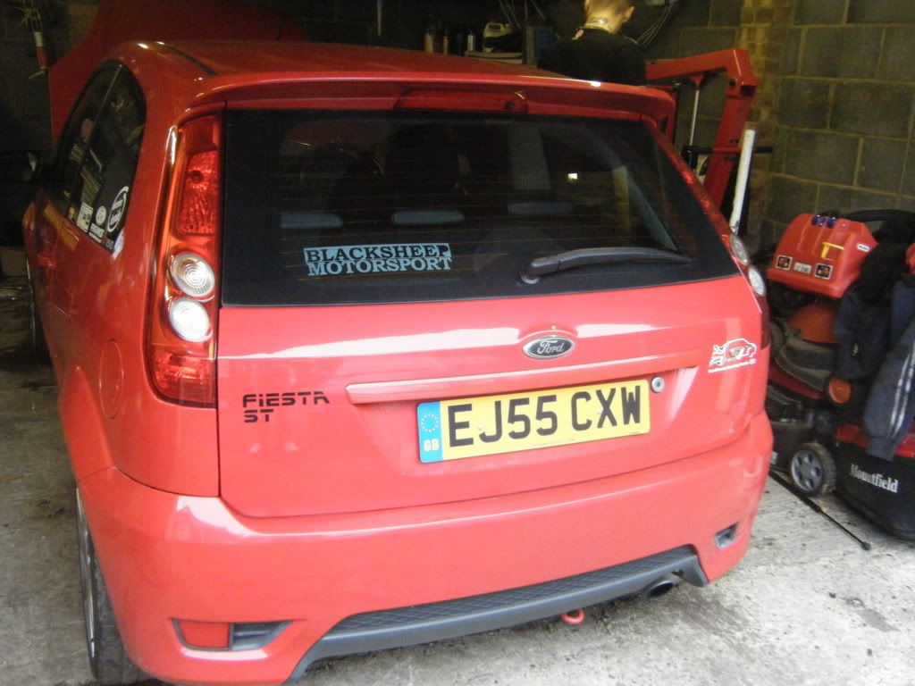

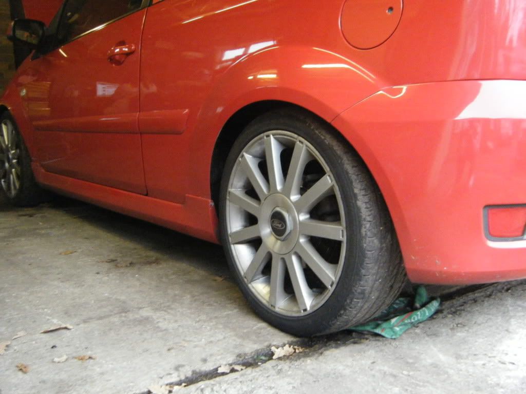

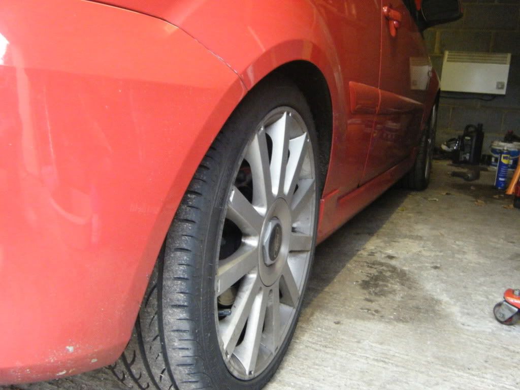

Lowered.com :D and red 10mm HT leads:
Leads:
45mm spax springs =
it's lower then i thought :lol: handling is improved feels much stiffer, no body roll :D
not to bumpy :lol:
