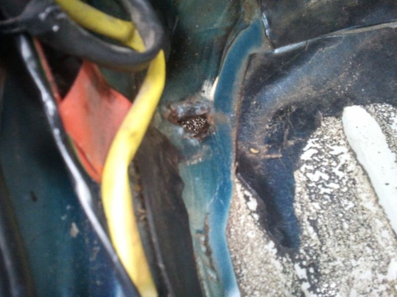

another update found some nasty rot on the inner sill on my si

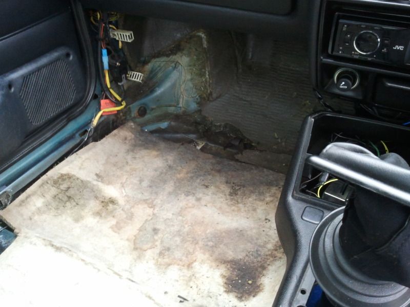

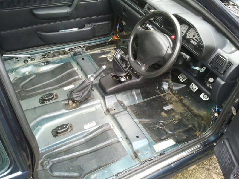

so i took the carpet out to get ot ready for welding and the underlay was wet and falling apart
took whole lot out
found another hole :(
so decided to work out where the water was getting into the car as water washing it water was dripped down behind the dash and the water is getting in from some rust thats caused the seam sealer behind the ecu mounting to split so has been letting in water for sometime :(

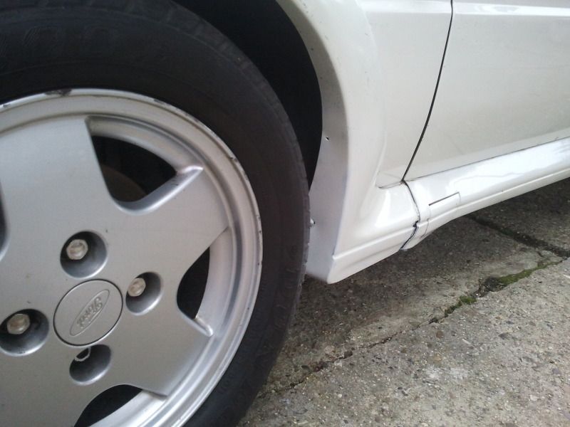

ive been tidying it up in recent months with the bumper etc and painted the inside front xr2i arch as it was stonechipped badly its not perfect but it looks a lot better
and a better condition rear bumper

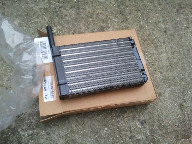

and fitted a new heater matrix as it was blocked and a new stat :)

The sound deadening is what will have made it worse. Its like a sponge. Just keeps hold of the water. Id not replace it, i didnt when my si leaked. Just asking for disaster.
Good to see your still sticking with it. :chill:
PostPosted: Thu Nov 01, 2012 9:04 pm
very true matt, im going to replace the main underlay with another one but was think of using sound proofing mats for the footwell/under dash areas instead but im not sure as the dash has probably got to come out to fix the leak
