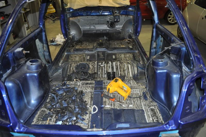

been cracking on with stripping the sound proofing
suprising how heavy that lot is
bulkhead panel now soundproofing free aswell,
so when seam welding underneath i dont have to worry about anything melting,
also with the age of the car it could be hiding rust
alot of the seam sealer has looked like this
until you strip it back to find small scabby bits like this
