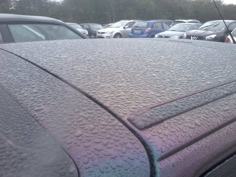

Also used a jetwash at tesco last night to wash off the soot from the powerstation that was covering the car..
Don't think this counts as good beading tho :lol:

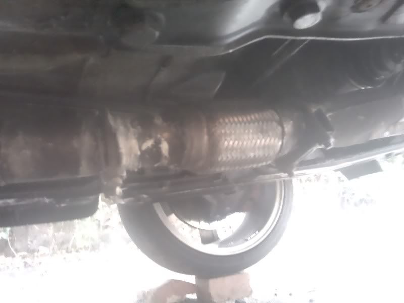

I now have a Magnex exhaust system on the car! I can actually hear the engine now! :lol:
The Magnex system had a length welded in to make it longer to fit to a turbo downpipe, and as I have an Ashley manifold on this.. I was hoping it might be the right length.. it was actually 2" too long... but thats better than short.
The Powerflow was modded to fit the Ashley with a flexi pipe, welded on the stainless and clamped onto the Ashley.. and as the Magnex had a section sleeved on and welded which was slightly bigger diameter I cut that down 2", cut off the flexi from the Powerflow, made some slits and clamped it on...
Was worrying that it blow its tits off and force me to either weld or get a longer clamp on flexi.. but lucky.. its perfect :D
Looks a mess because I wanted to make sure it didnt blow, so caked it with exhaust paste :lol:
3" tip actually looks good, will probably keep it as is!
And because I am now an exhaust master (I have done that many Fiestas now) it doesnt even hang down..
BOOYA!
Now to do the driveshaft sometime this week and jobs a good un till I can be arsed to do anything else.
