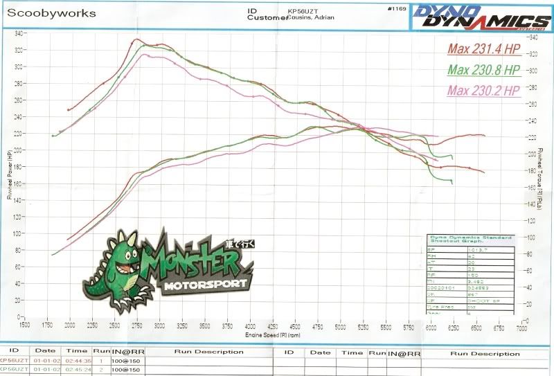

Unfortunately not what i hoped for, the reading was a bit iffy and the power was down substantially, however upto about 4-4.5k it was running fine
Heres the graph for my run
Should have continued up beyond 4k but doesnt only making about 230bhp, should be nearer 260-265
However the torque was just awesome, one run, the first one, no doubt with cooler intake produced a -whopping 330+ lb ft torque :D
I think a custom remap would be better than plug in jobs, but a lot of other ST owners believe that higher up, especially made worse on a rolling road, hence feeling better on road, i would be suffering very bad inlet temps on a standard intercooler on DSCi map :(
This may very well be why it didnt produce a high power at higher RPMs, either way i will besorting this out
