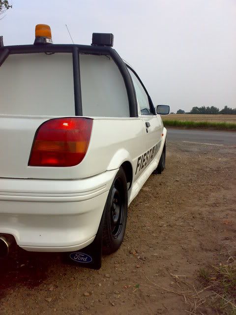

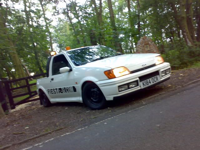

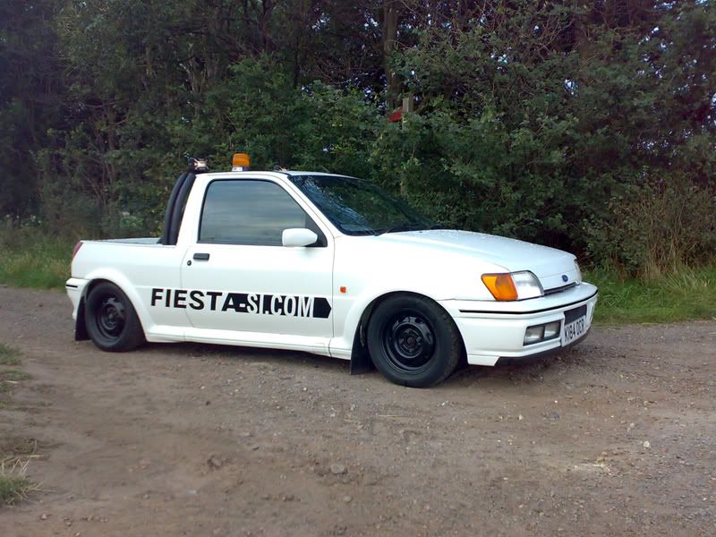

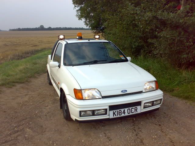

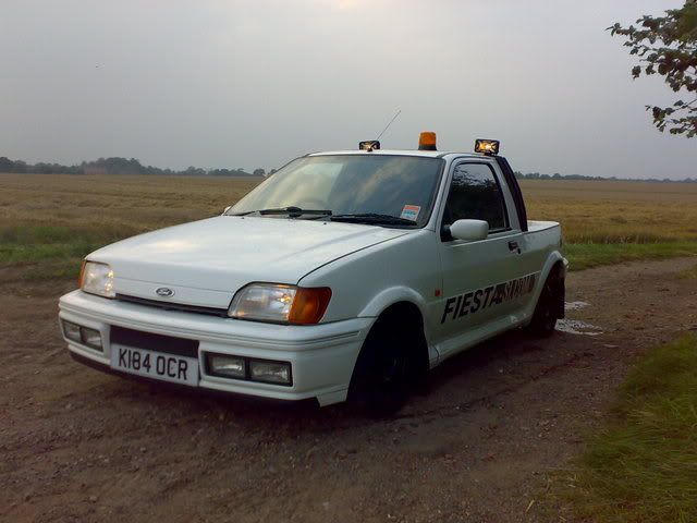

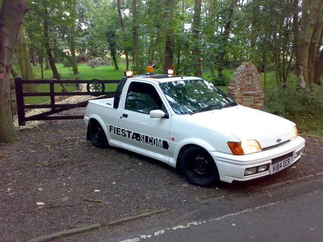

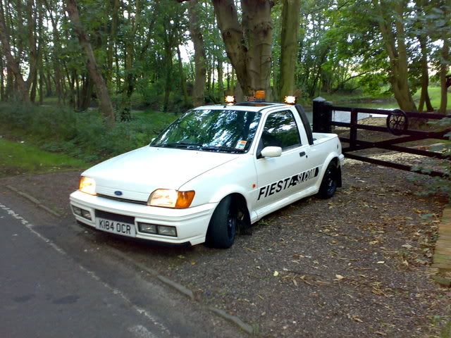

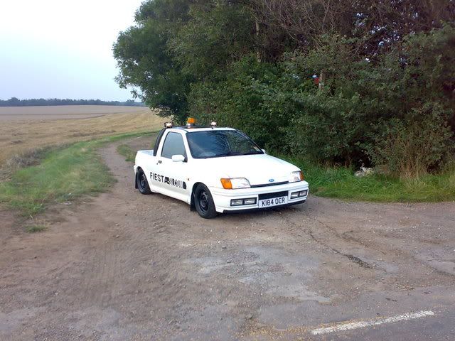

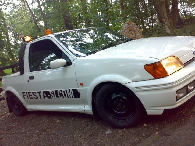

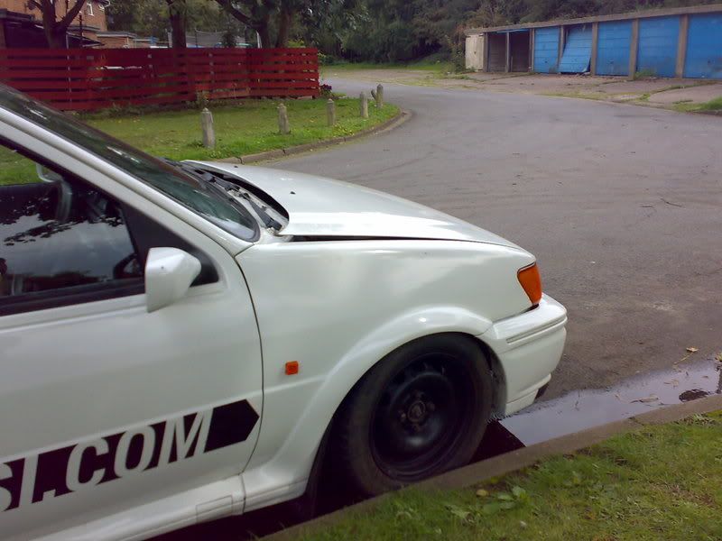

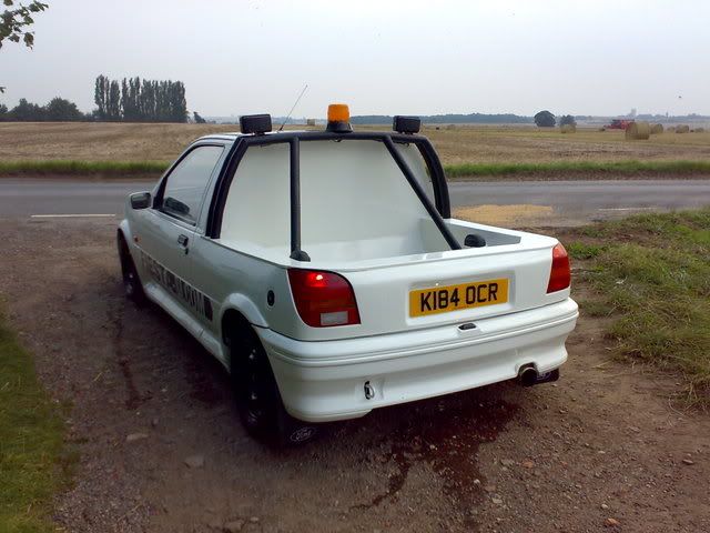

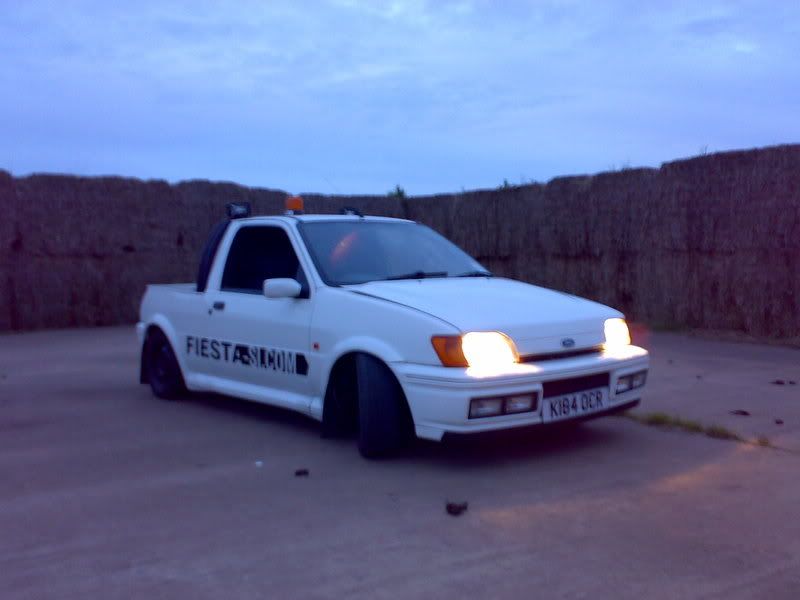

Well I fitted the flappers from the RS (which it kindly donated me :lol: )
Didnt get boost gauge in post so that was on hold and didnt bother turning fueling up.. and didnt find any 15" steelies so ah well!
But I cleaned it and took some nice photo's...
ps. I hate the image auto resizer as it makes pics look poo.

resize them to a width of 800 and the forum will leave them alone :) looking good tho :D
PostPosted: Sat Aug 30, 2008 9:05 pm
How low is that :shock: .....coillies?
Looks mint....deffo black steelies as it suits the theme better and looks like a proper pickup......i think you need one of them raising crane tow hook things :lolz:
PostPosted: Sat Aug 30, 2008 9:07 pm
cheers luke :chill:
(the photos get resized to 800 width before I post them on here, thats the problem :P )
alex its on 60mm gmax all round :lol: and with them 13's on it sits a tad lower, had a few issues with a kerb earlier and got it stuck :lolz:
and dont you worry, that idea has already been in the works as a mess about.. but i said no! lol.
PostPosted: Sat Aug 30, 2008 9:53 pm
looks ace paul!
seems to get better and better!flaps suit it really well as do the wheels :thumbsup: , but i'm torn between the white wheels and the steelies now :lol:

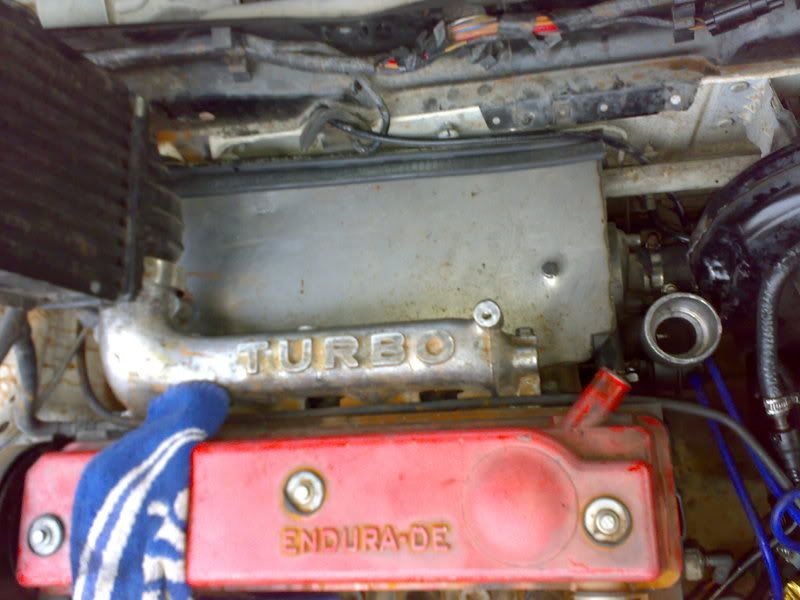

PostPosted: Wed Sep 10, 2008 9:49 pm
Well after alot of faffing about the pickup is now boosting properly!!!
Things were pointing to either actuator stuck or wastegate stuck.
Removed the exhaust manifold/turbo today and got an actuator rod from an escort td (as they are easier to remove than mondeos while in engine bay!)
Removed actuator, wastegate was fine.
Fitted the escort actuator which has a shorter rod anyway
Fitted back to pickup.. had a major problem, oil to turbo decided to leak and therefore all the contents of the sump ended up on the road instantly :lolz: :rolleyes:
Sorted problem.
Drove car, boosting to 20-22psi, standard is 15psi apparently 8-) but it used to boost 10psi.
Major improvement, just need the fueling upped some more! mainly the max fueling screw inside the pump, which I may do one day but will have to remove radiator to get to it.
Get some proper boost pipes and plumb in my front mount, top mount keeps popping off :doh: so may just get a tiny bit of silicone pipe for that to keep me going :thumbsup:
Wonder what BHP it makes at the RR day? :look:
Hoping to get fueling upped some more by then, needs upping as I have no black smoke, best to have some when you boot it :chill:
Once Ive got all that done I am looking into water/alcohol injection or some NOS injection for flooring it / sprints.. or may just leave it as it is.

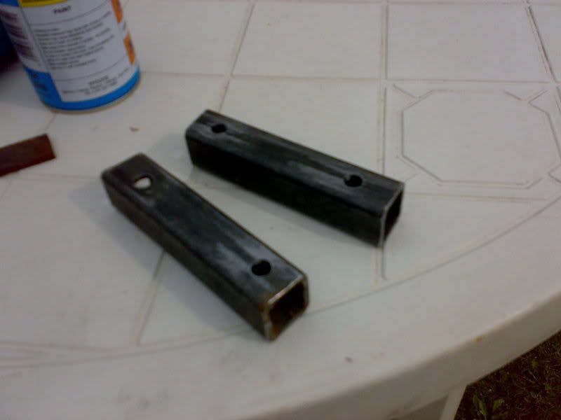

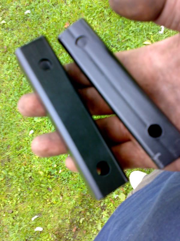

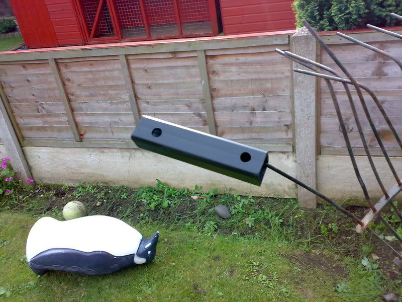

So first things first.. B&Q for some longer bolts for the bonnet, and made some bonnet raisers from my spare inch box section. These are needed due to engine temps and the interwarmer :red:
So cut them down, drilled some holes.. and sprayed up black!
:thumbsup:

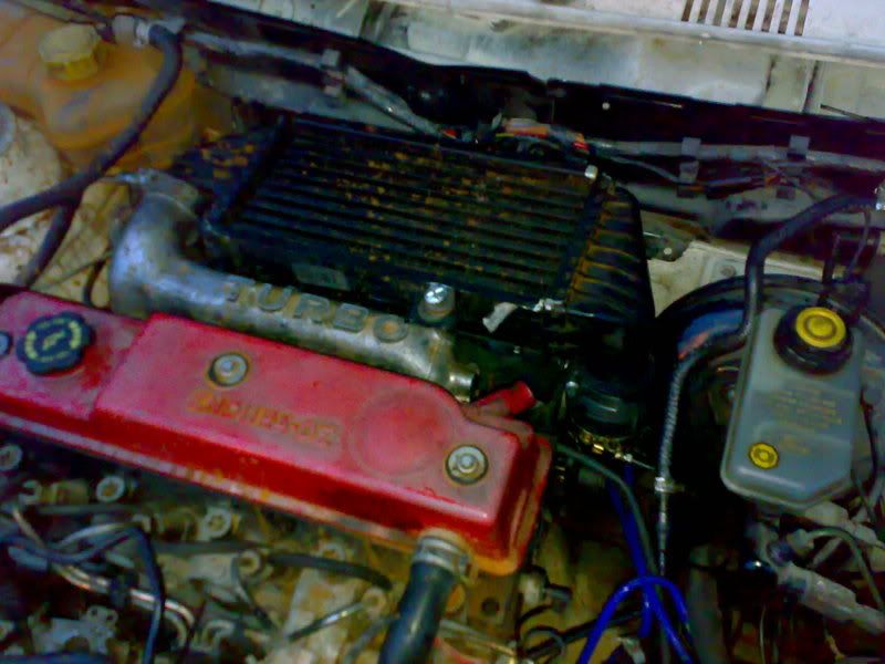

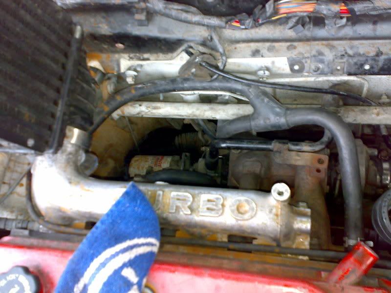

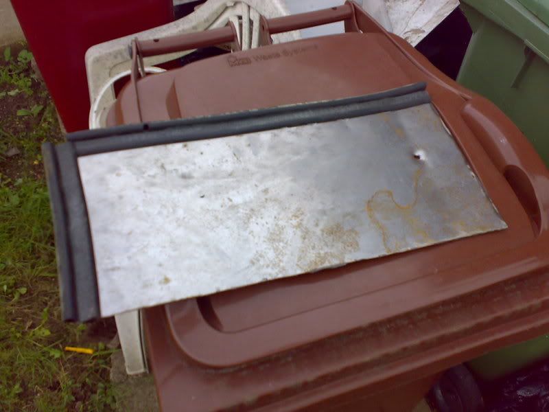

While I had the IC off I suddenly thought hmmm, IC is above the hot exhaust manifold and turbo:
So went about and cut up some of my spare steel sheeting to use as a heatsheild for under the IC.. might make abit of difference. I used an old sunroof rubber to stop pipes and wiring rubbing on the sharp edges.
Fitted:
If anything.. it looks better, and will remain even when I get my front mount piped up.
:thumbsup:
Then next was the boost pipe... few attempts at this to get correct.. and then also added a bolt to the IC where it bolts into the inlet manifold, as it should on the Mondeo setup..
This should therefore stop the IC moving and making the pipe pop off also...
Went for a blast around on the B roads giving it some 20psi boot to see if it pops off.. came home, pipe had not moved.. which means so far its safe from popping off, but I wont say never :rolleyes:
:thumbsup:
(excuse the dirty engine bay, been spraying excess water from the system as I put too much in.. I will eventually tart the bay up :lol:)

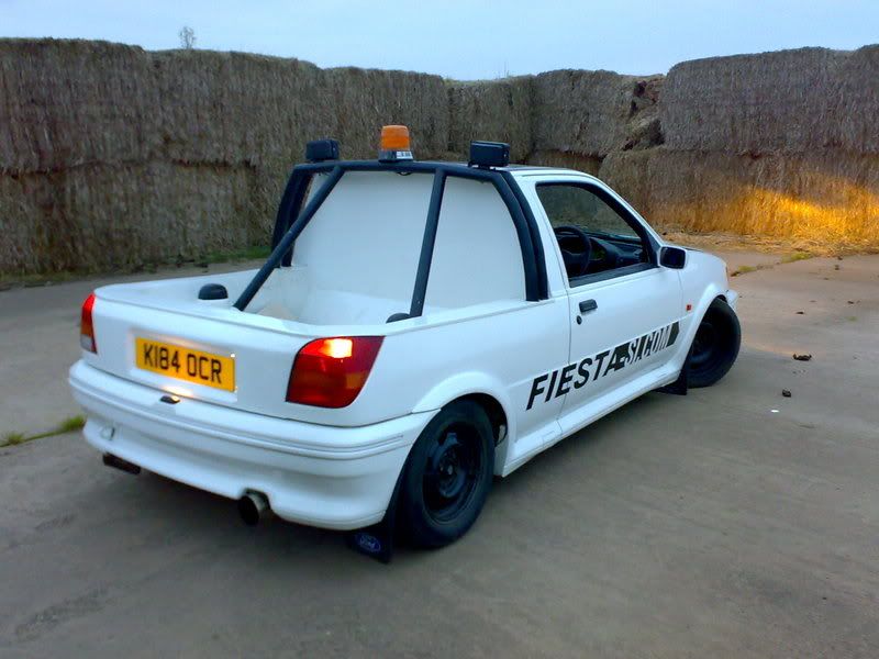

Few randoms:
:FSI:
