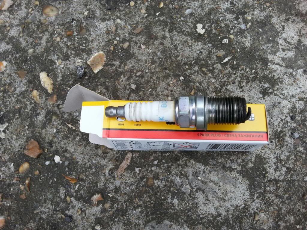

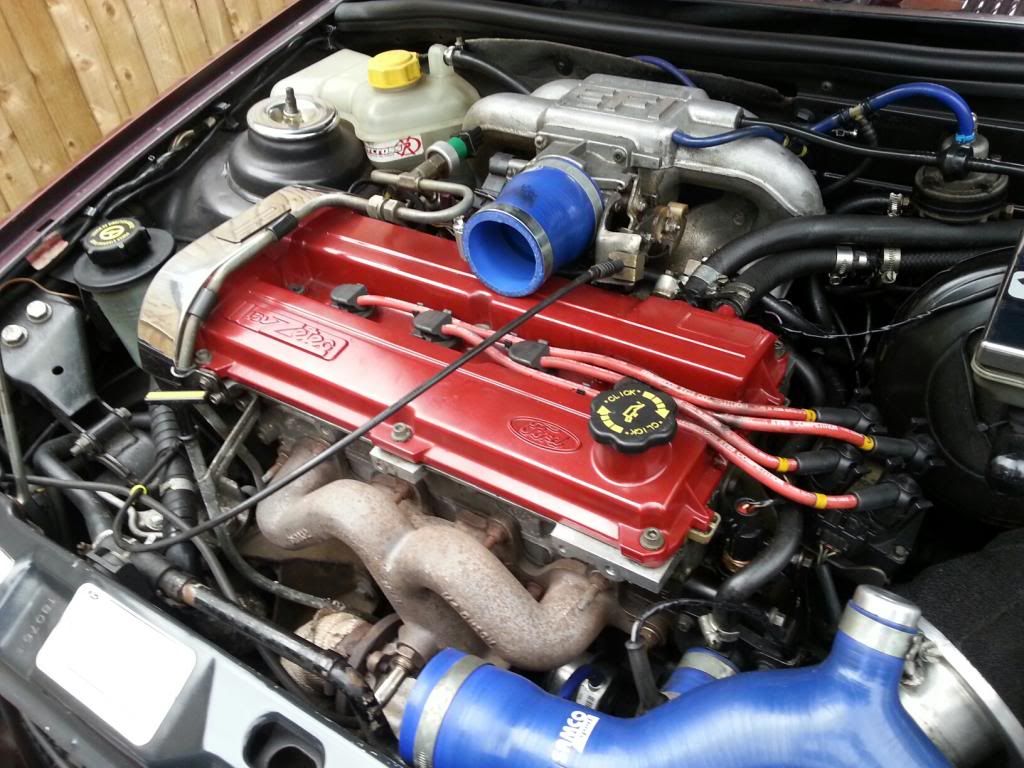

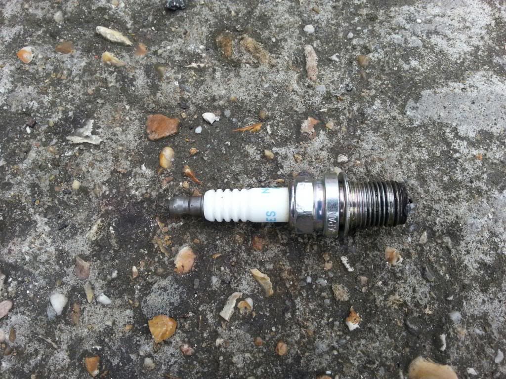

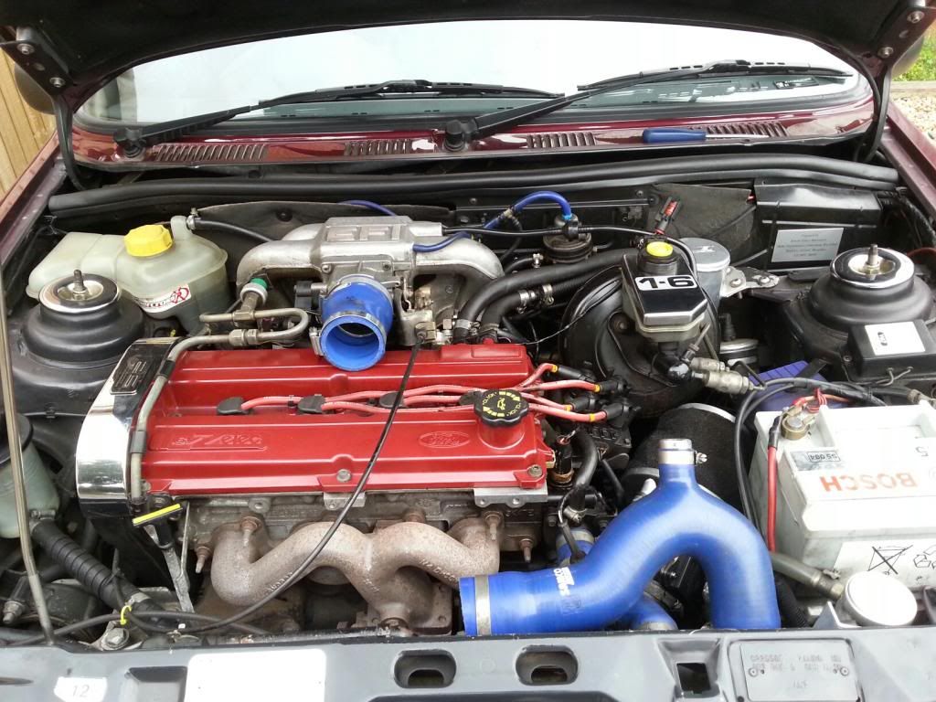

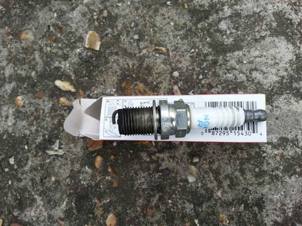

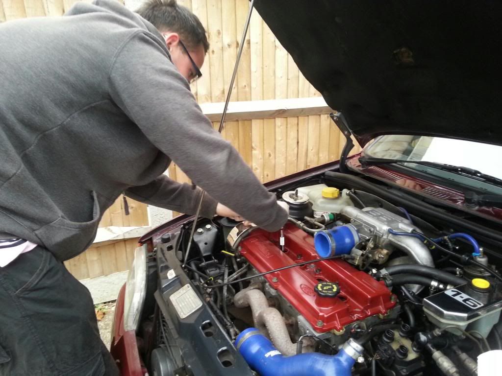

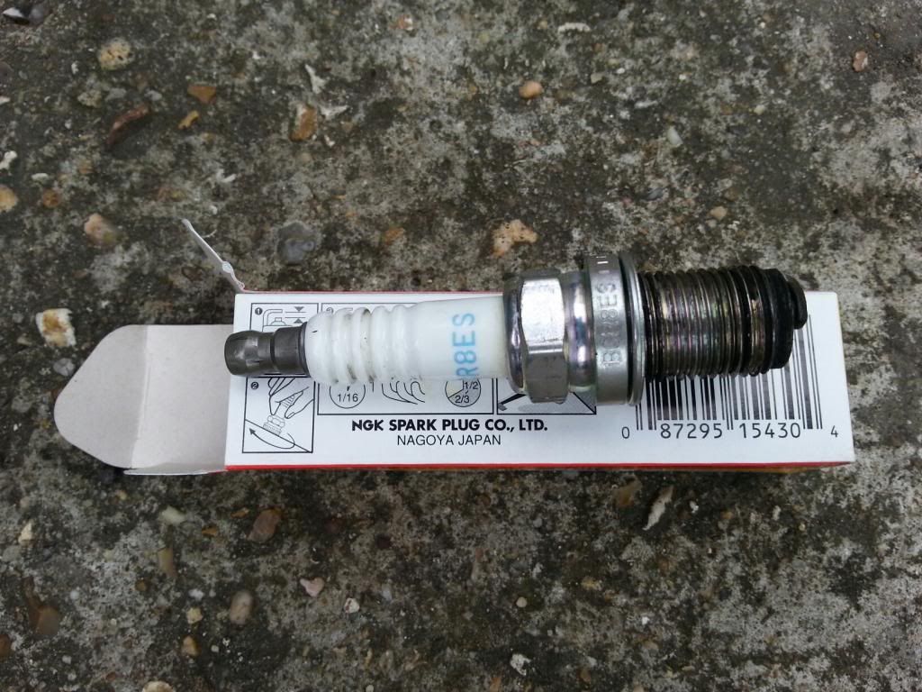

Well steering rack will be changed soon but me and mole did the following on Friday.... (cheers pal ;) )
Plugs had done 6000ish miles
- Changed Oil & Filter
- Changed Spark Plugs
- Re-Heatwrapped Crossover
Pics:
Plug 1
Plug 2
Plug 3
Plug 4
Changed and leads on
Heatwrap
Temp Parking Spot away from bush!

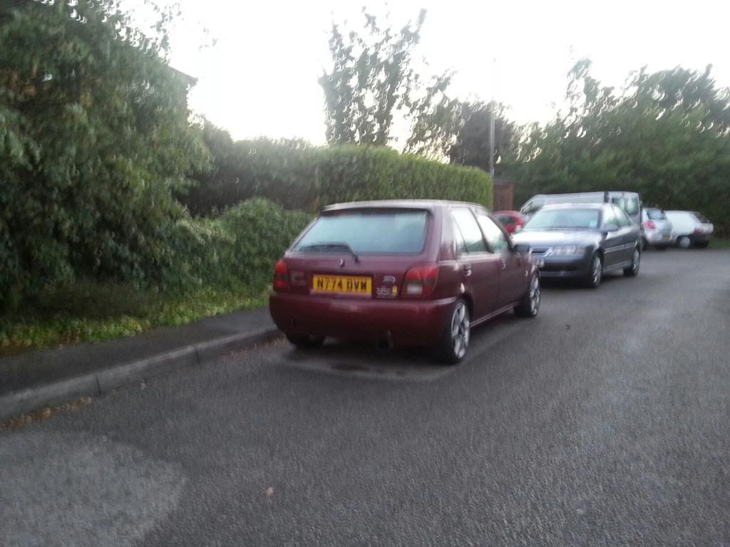

PostPosted: Sun Sep 15, 2013 8:05 pm
Not a good update
Looks like kms fuel ecu has died. .........
PostPosted: Sun Sep 15, 2013 8:28 pm
PostPosted: Sun Sep 15, 2013 8:40 pm
Whats the damage? How do you know it's died?
PostPosted: Sun Sep 15, 2013 9:12 pm
Damage is its broken down as injectors won't fire :( rac came out and there is fuel and spark but no injectors lol
Ringing lee at devil's tomorrow
PostPosted: Mon Sep 16, 2013 8:07 am
More detailed breakdown of recent events........
Car was playing up wednesday - cut out at lights and took a few goes to get going again - weird in my book as it is spot on usually.....
Thursday - drove to darts fine - left darts and it cut out and wouldn't start - if you touched throttle it died - then was fine and drove home fine - albeit when i floored it in a temper it was chucking out plumes of fuel smoke :doh:
Sunday - drove from mine to heathrow fine - drove from heathrow to blackwater - spot on....... left blackwater and at traffic lights it died. nothing..... (made me popular with traffic....... :lol: )
Pushed it in to Aldi carpark and rang terry - cheers chap 8-) who advised usual check for spark and fuel.
RAC arrive on my dad's breakdown cover - has spark, has fuel, cps is working, cam sensor working - both confused :lol: tested injectors for electrical current..........nothing :cry:
Initial diagnosis is either the kms fuel ecu has failed - or as alex has advised :thumbsup: - communication between the management and fuel ecu has done a bunk :|
Ringing lee at Devil's today to see if there is a warranty on the fuel ecu........and if there is somehow get it to littlehampton.
considered breaking the bugger for 10 mins yesterday :cry:
pissedoff.com :banghead:
