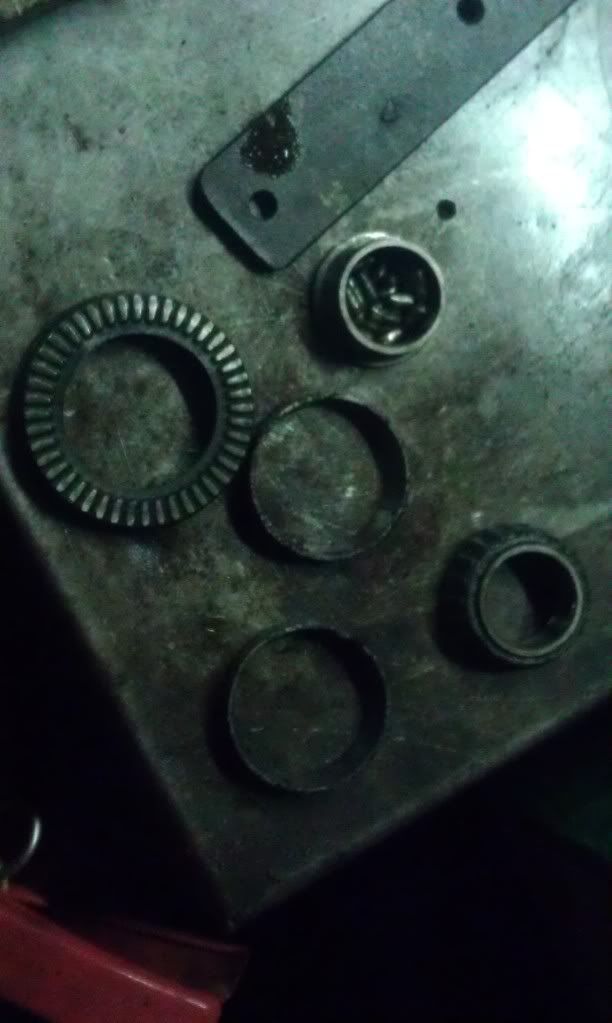

this pic shows the component parts of the wheel bearing.

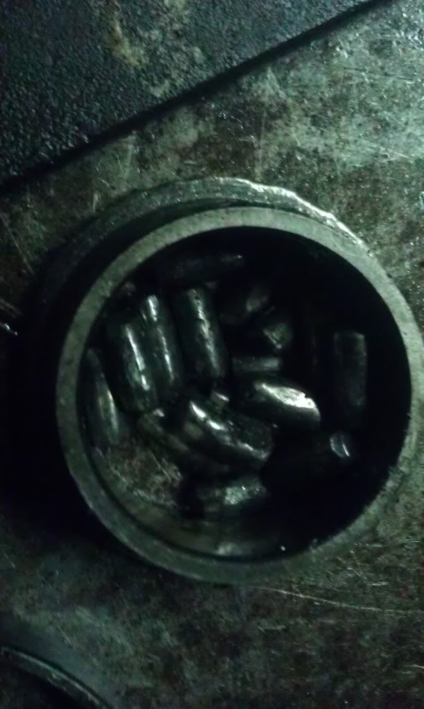

one chewed up bearing. for those who dont know the rollers that are loose in the middle of the inner part of the bearing are all meant to be held together by a cage which was just metal swarf, when i removed the drum the rollers fell on the floor.

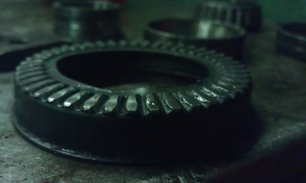

this picture shows the old abs ring which has been worn down and dented by rubbing against the wheel speed sensor.

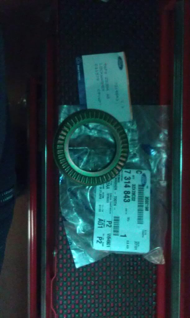

and i have 2 new abs rings this is the one i have still to fit, as you can see the teeth are much larger on this one
